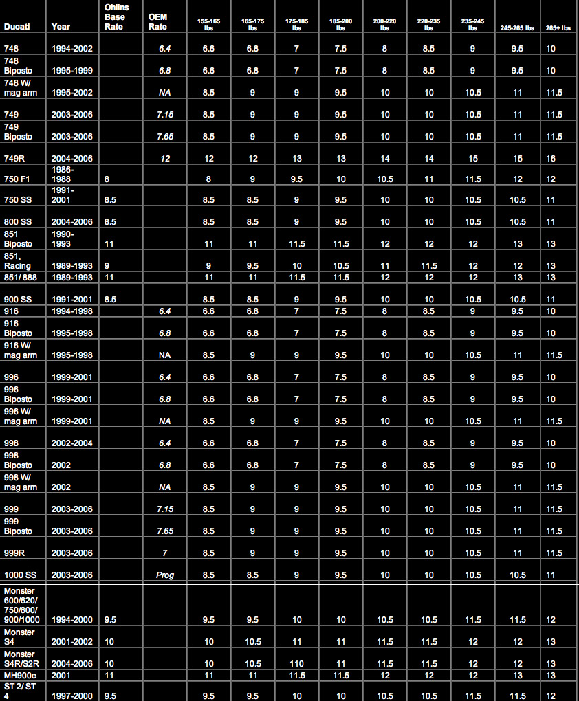

  1. I've currently got my T9S suspension on the standard settings,and I'd like to have a go at trying some specific settings to suit my weight etc...I'm 14ish> stone,anybody got any pointers on where I should begin...I'm sure I cant be the only fat bastard on this forum :D
  2. Heres a recommended rear spring guide . I have a 9.5 by the way . Easyish fit as long as you have spring compressors.
  3. ...and where might one buy heavier duty springs?
