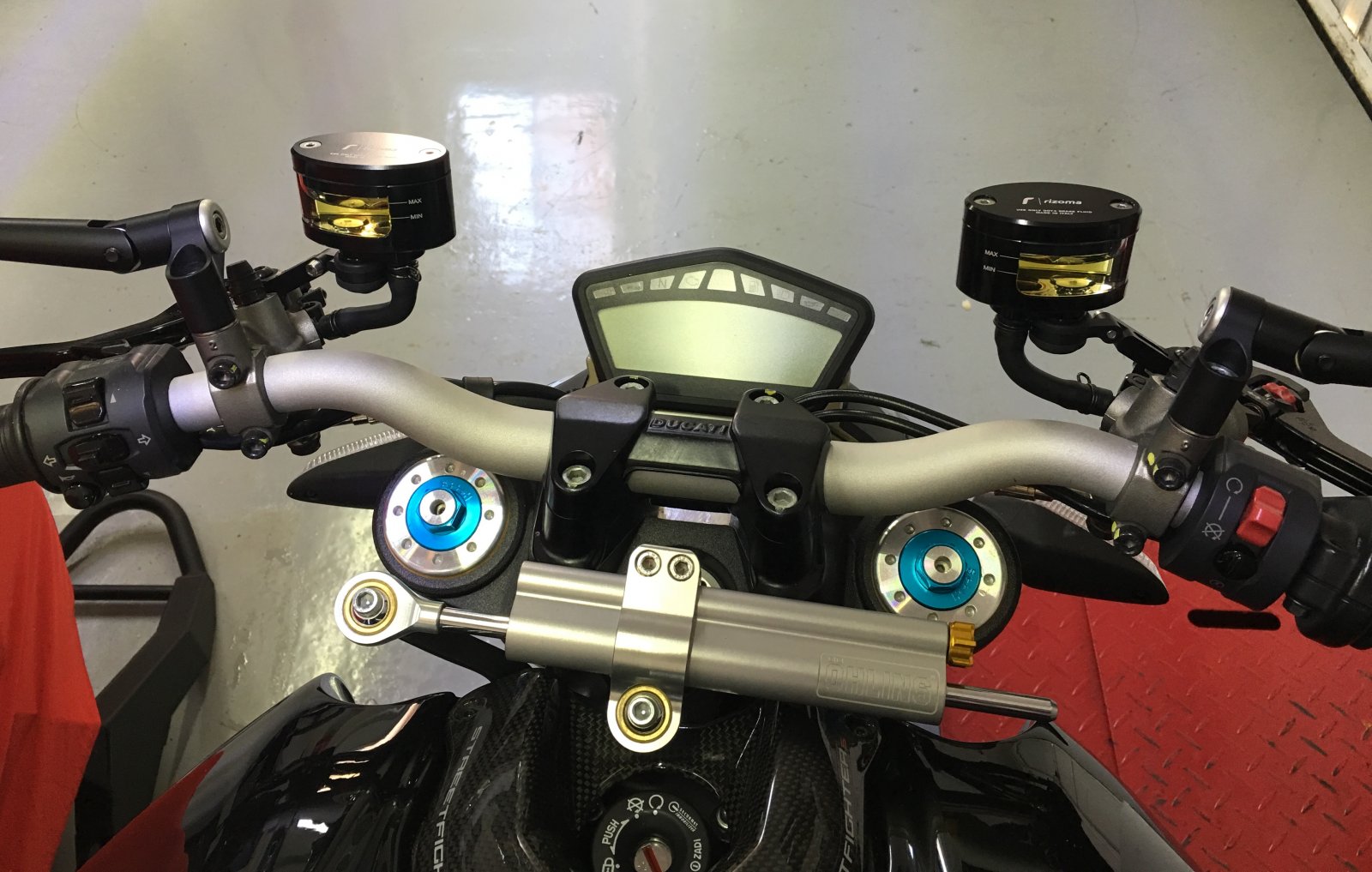

  18. Hmmm, the damper bracket looks suspiciously like the one fitted to my after market Ohlins damper I bought for the Streetfighter. I suppose I'll have to check tomorrow.

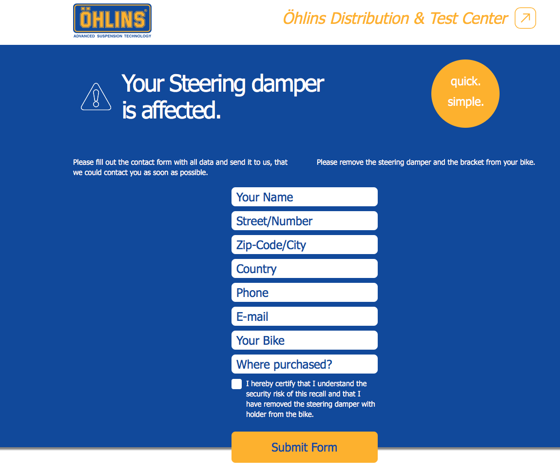

  19. Checked my steering damper today. It is affected :Nailbiting:. Cheers @burndownthediscos I'd never have seen this otherwise. :)
