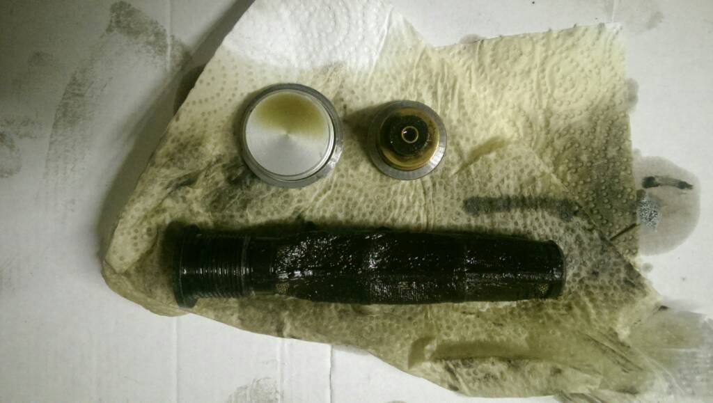

Dropped the oil and took strainer out. Strainer is knackered/squashed and was really think in gunk. Is there any benefits/point in chucking in some cheap oil/filter and doing an easy 50mls and throwing it as a flush?
I believe this is what Steve @Mr.R does after an engine rebuild so I can't see why it shouldn't help flush it out. Steve
If it were me I would investigate a good flushing oil, plenty on eBay and use that. It depends on how bad you think the engine might be.
Most oils on the market are way good enough. Its oil contamination you need to worry about. Providing you do regular changes, will be ok. Book yourself on the Hydraulics course at NFC in Worksop however, and you will never dare to put oil in your bike again!
This stuff? COMMA MOTORWAY MINERAL OIL 20W50/20 50 4.5L | eBay The oil that came out looks ok, although 20 months old. No bits on the sump plug. It was the strainer I didn't like, totally blocked with sludge. When I removed it, more oil came out the sump.
not good huh. squashed flat too, which made it fun to get out. Either it was oil pressure from it being blocked, or somebody stood on it and stuffed it back in.
Looking clean is not a scientific measurement of oil serviceability. We used to have an EFDC (Early Failure Detection Centre) at most of the RAF bases that I have worked at and you would be surprised at how much use an engine oil can sustain and still be serviceable.
