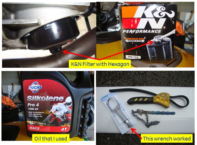

  1. Whilst I was fitting a new battery I decided to do an Oil change at the same time.
    Here are a few tips that I can pass on to others who wish to change their own oil.
    The oil filter is partially hidden in the crankcase which makse removal access difficult.
    I managed to remove the OEM Ducati filter using the strap type wrench shown in the attached picture - The rubber band type wrench & the chain wrench were not able to unscrew the old Ducati filter.
    Tip - Fit a replacement K&N filter (Equally as good if not better than the Duacti one) which has a hexagon nut on the filter base. Makes the next Oil filter change so much easier.
    I used Silkolene Pro 4 10W-40 Race Oil as I was unable to get the Shell Ultra over here in France.
    Cost me 69 Euros (58 quid) for 4 litres so not cheap but looks to be high spec & good quality.
    Dont - forget, warm the engine first before dropping the oil & clean the drain plug & gauze filter screen before filling with fresh oil.
    Hope this helps.

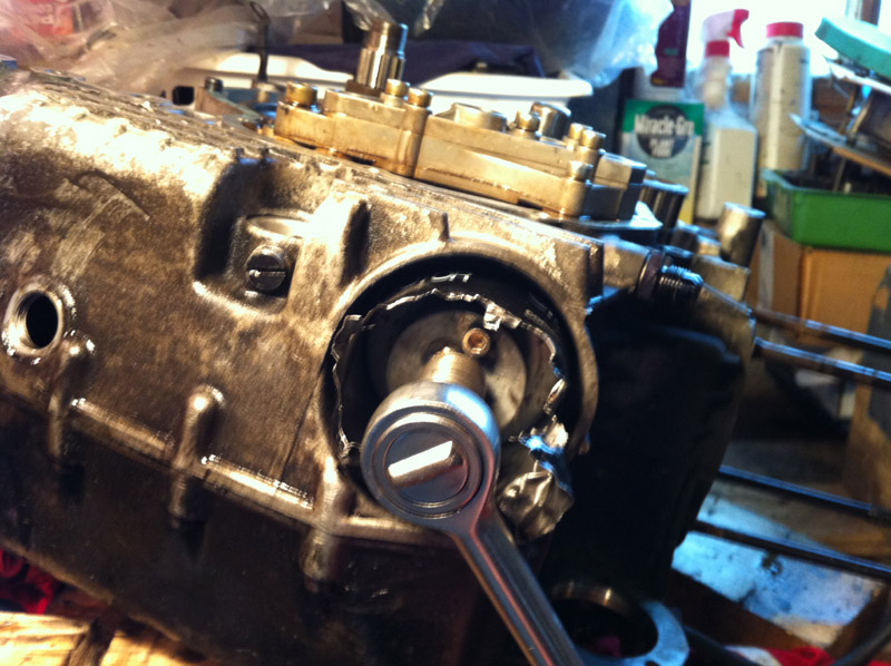

  3. Good old screwdriver through the oil filter works too,and the oil comes out quicker .

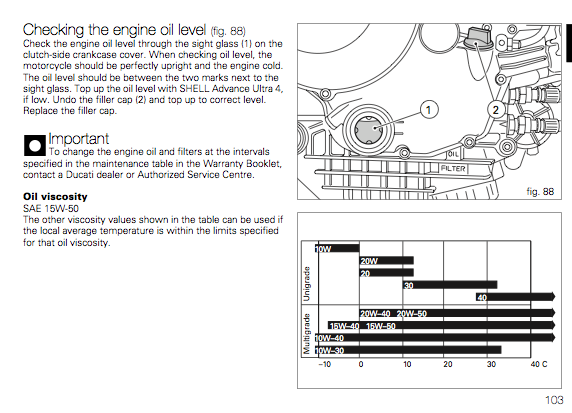

    I always warm the oil before I drain it out on an oil change because at the higher temperature the oil viscosity is lower and it is more fluid. Therefore it flows more easily. This is also what is recommended in the ST service manual - see picture below. Draining cold overnight just takes longer to achieve a similar result - Horses for Courses I guess.
  8. heres a 1098R manual for checking the engine oil
    Why do you check the oil cold? Because all the oil has run back down to the bottom of the sump during the cool down period if you checked the level when hot it would be misleading as a lot of the oil would still be up around the engine......
    So changing the oil when its cold and a true reading of all the oil in the sump you'll get more of the old oil out rather than it being up around the various bits of the engine..

    Looks like we have a difference between a ST 916 manual & a 1hotR
    Mine recommends checking when hot !! Interesting LOL

  19. Why has nobody mentioned here about two other important steps, 1, fit new sump plug washer and 2 a smear of grease on the rubber seal of the new oil filter.
    The later I feel most important, It will help seat and seal the new filter and aid removal on next oil change, makes a world of difference when removing next time.
    Avoids the picture you see in post #4 :upyeah:
