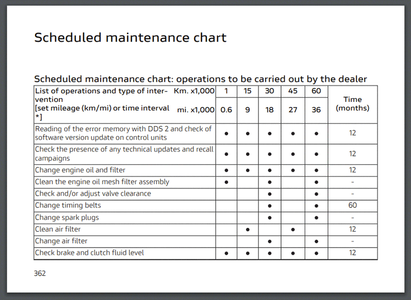

  1. Hi , my Multistrada 950s 2021 recently had its 3rd year annual service, the dealer advised when my bike was being handed back that they did not change the oil & filter as the oil is good for two years and I had only done 2000 miles in a year/since last service.
    Every 9,000 miles or annually according to the owners manual. The OP's call, it's money vs. peace of mind if a warranty claim is required. Doubt very much there would be an issue not changing the oil but it would be a convenient potential 'get-out' for Ducati.

    The manual clearly states xxx miles or annually the way I read it so I'm going to get it done I think.
