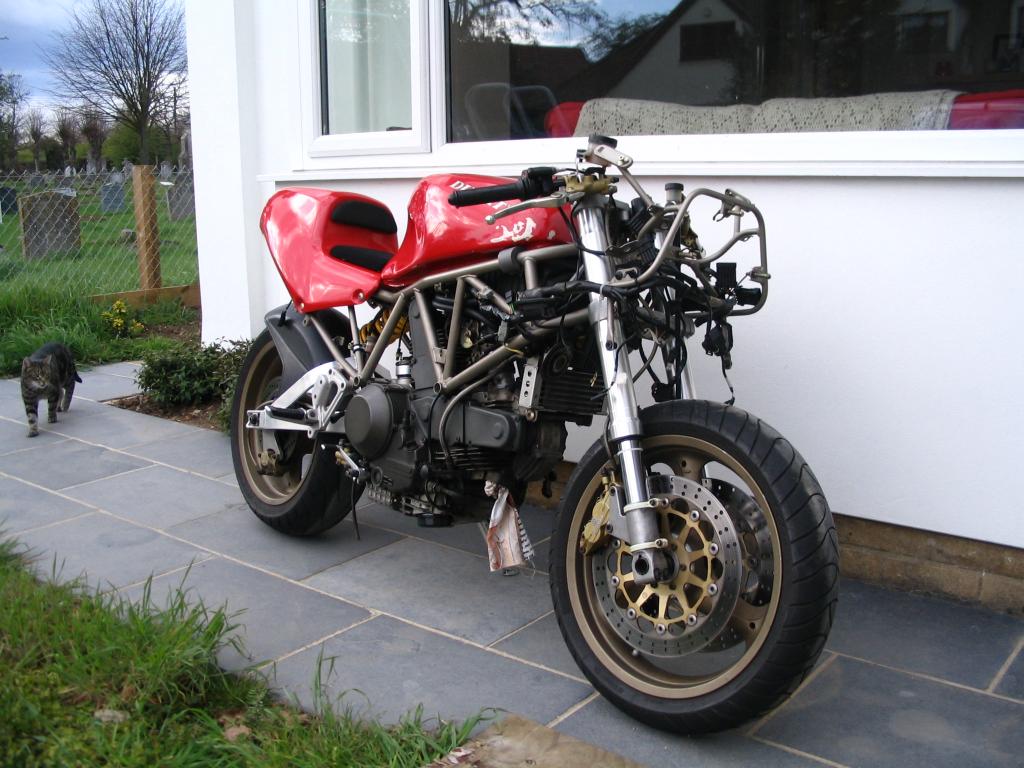

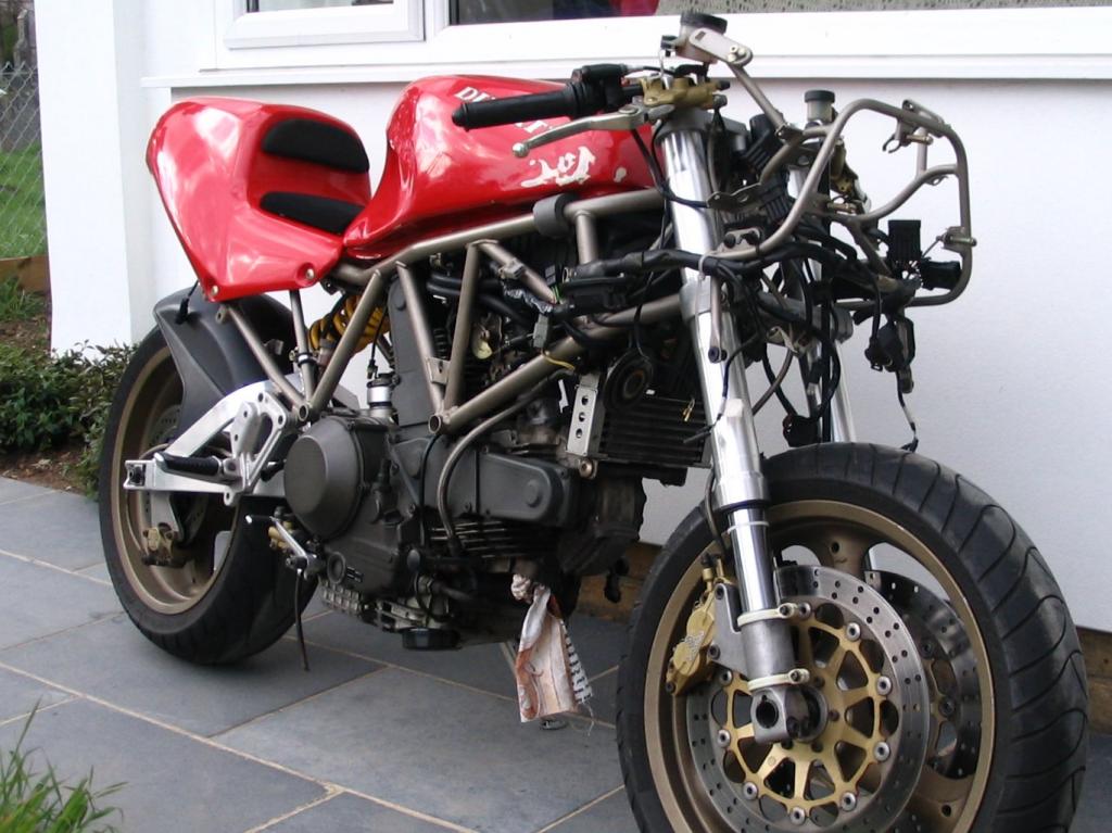

  2. BB, I maybe wrong but, as far as I can make out it's the same fitting cept on the later one just upside down(?)
    images are my '92 carby & my donor ssie, extra oil is negligible, plenty of 2nd hand hoses from breakers etc. 900ss.jpg IMG_2796.JPG

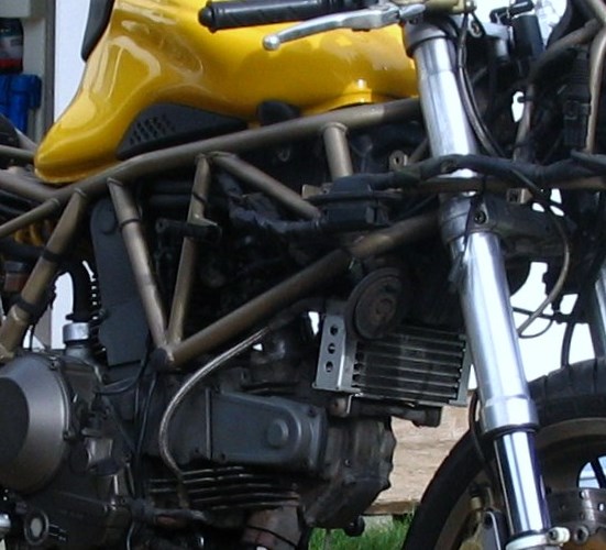

  3. It is a different bracket on the '97 model SS's, it's the same one used on the monsters and in WAH's second pic. Pretty sure just moving the old mount onto the top will give you clearance issues with the cooler as it will sit too high. It's an easy conversion to do, you can even make up the oil lines yourself :upyeah:

  5. image of ssie lump in carby frame, suspect you might not get away with this if using half fairing & original lower cross brace.
  6. If in doubt get the newer bracket as the mounting flange comes off flat from it as opposed to the earlier machine's casting.
    Other than getting it clear of all the crap the front wheel throws up it also puts it in a better airflow as the underslung one really done bugger all other than act like a radiator since it got sod all air going through it to really make a difference.
    If you do decide to mount it above the cylinder pot, try and angle it back a little to help it scavange more air. :smile:
