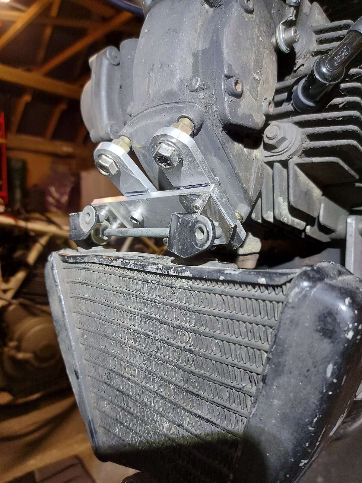

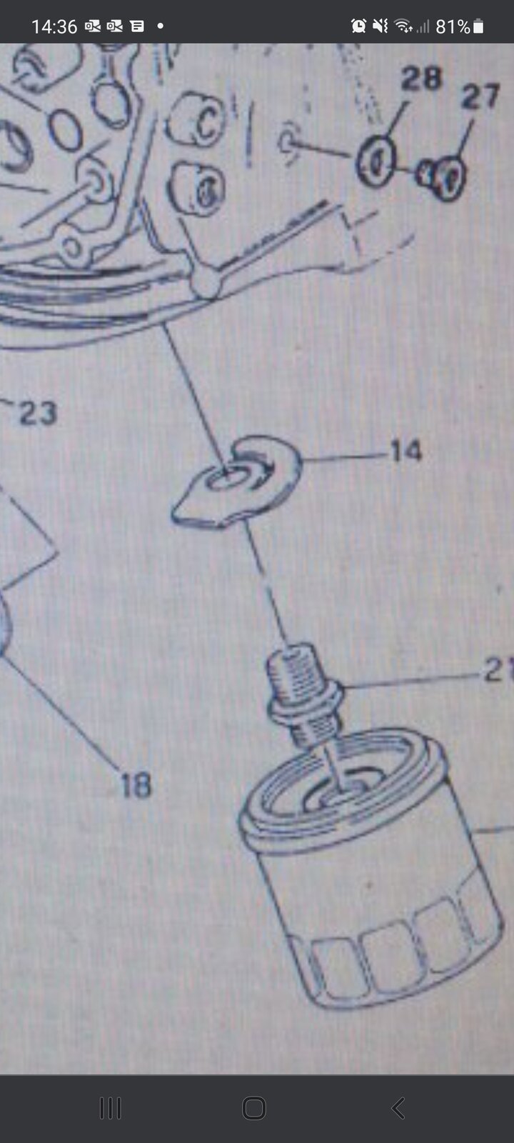

  12. Not sure if this helps but a 1098 oil cooler fits more or less straight on, including the hoses. Just need to make a bracket or modify the valve cover mount. Don't forget the oil diverter plate between engine and oil filter if fitting a cooler to an engine that didn't have a cooler previously!
  13. And the diverter plate!
  14. I've got one of these coolers for my 944
  15. It does help, Andrew.
    I had that cooler noted as a possibility, but what with your photo and all, it makes a decision easier.
    Especially as I don't have a cooler mount on my 904, as a previous owner had retained that cooler mount/cover.
    I like the look of your mount, handsome!
    I have the diverter plate , yes. Its in place.

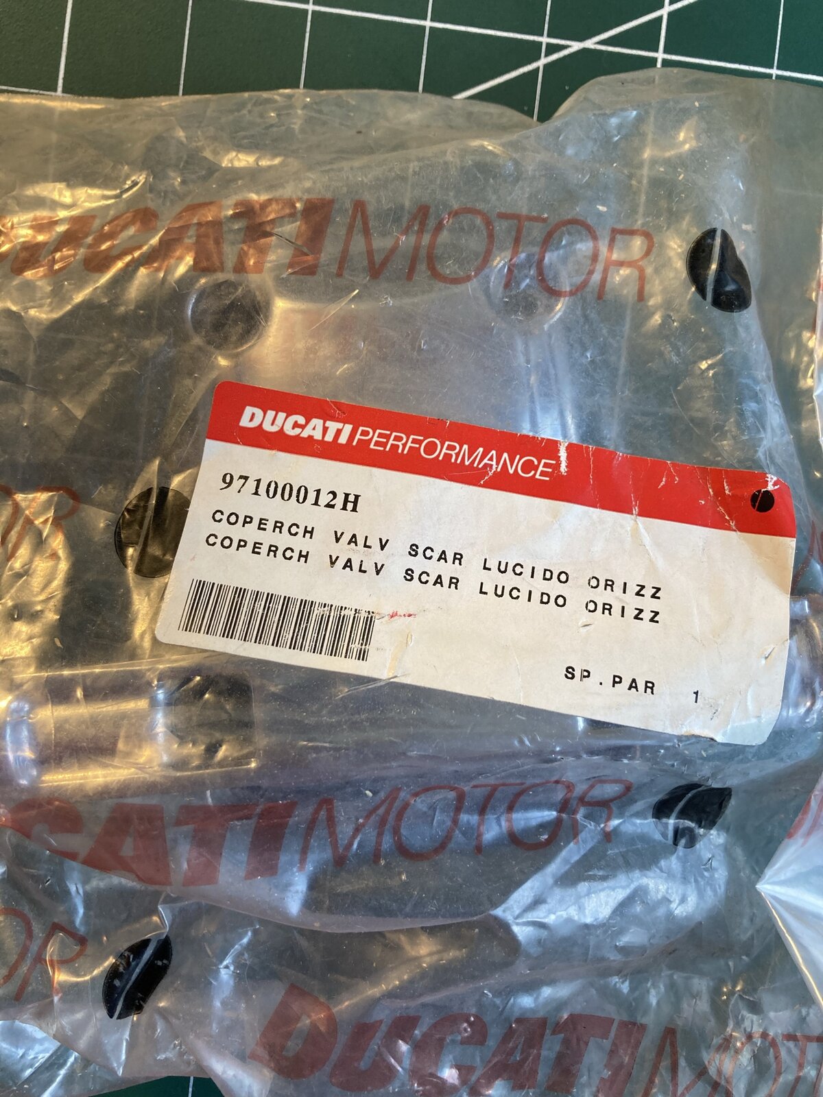

  16. A DP polished version of the cover with the oil cooler mount is still available. 243D86C9-60C8-49B8-B004-963AF7079E39.jpeg
