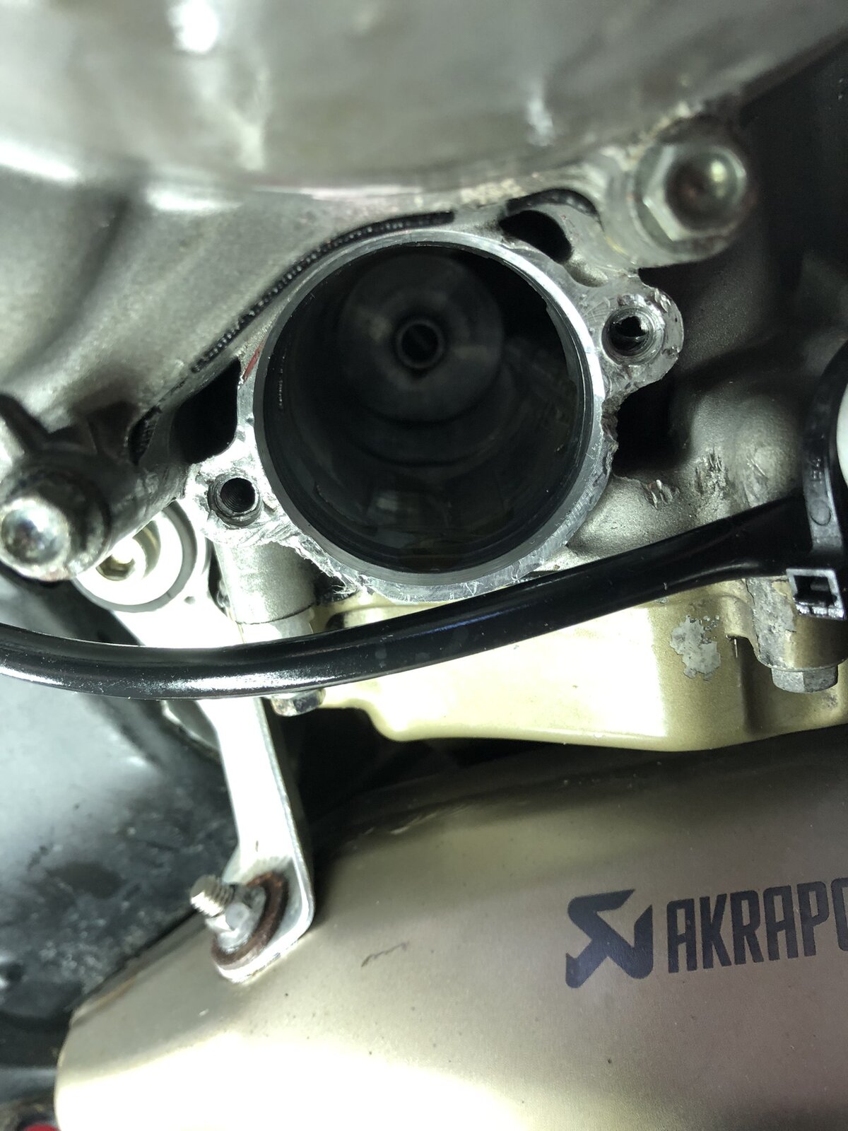

  9. Well, the replacement cover arrived yesterday courtesy MotoRapido, and today I extracted the badgered one and continued with my oil change. Getting the old filter out was tricky-I tried magnets, thin wire, but in the end resorted to puncturing the central part and yanking it out against the suction if the remaining oil that way.
    Some previous change has made a pig’s ear of the surface-see pic. I’ve put some liquid gasket on, but as the cover has two O-rings to seal it, I don’t think there’ll be a leak.

  10. That is well fooked.
    Hope they haven’t attempted any other more complex jobs!
  11. Butchery! And it’s an R :astonished:
  12. Wot he said ☝️
  13. Should be OK as the o rings seal inside filter housing and not on the outside face
