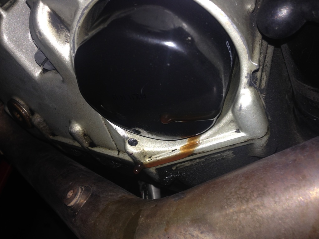

    Just wonder, after a little search on this forum, is this a common problem on 916? Just had it changed 10 miles ago (oil/filter) by the other previous owner (and he claims it never happened to him..)
    There You can see the leak. Its just there when i start it up, after riding 30 minutes and stops and let the engine going, no oil leak.. Just a simple new filter needed?? Advice please :)

    i borrowed a wrench from my 916sps-mate, obviously it was too loose, i turned it just a little bit tighter and the leaks gone.
