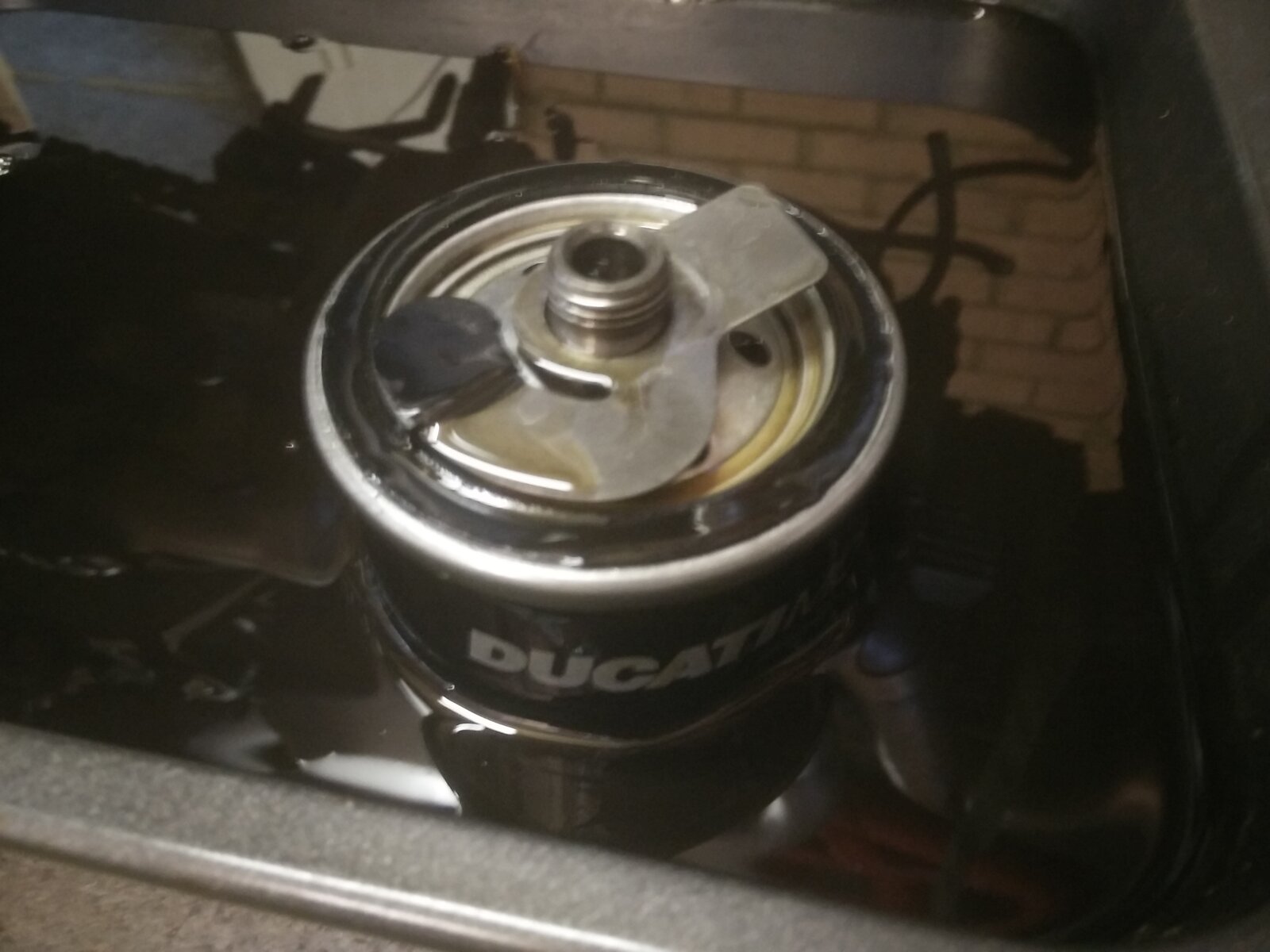

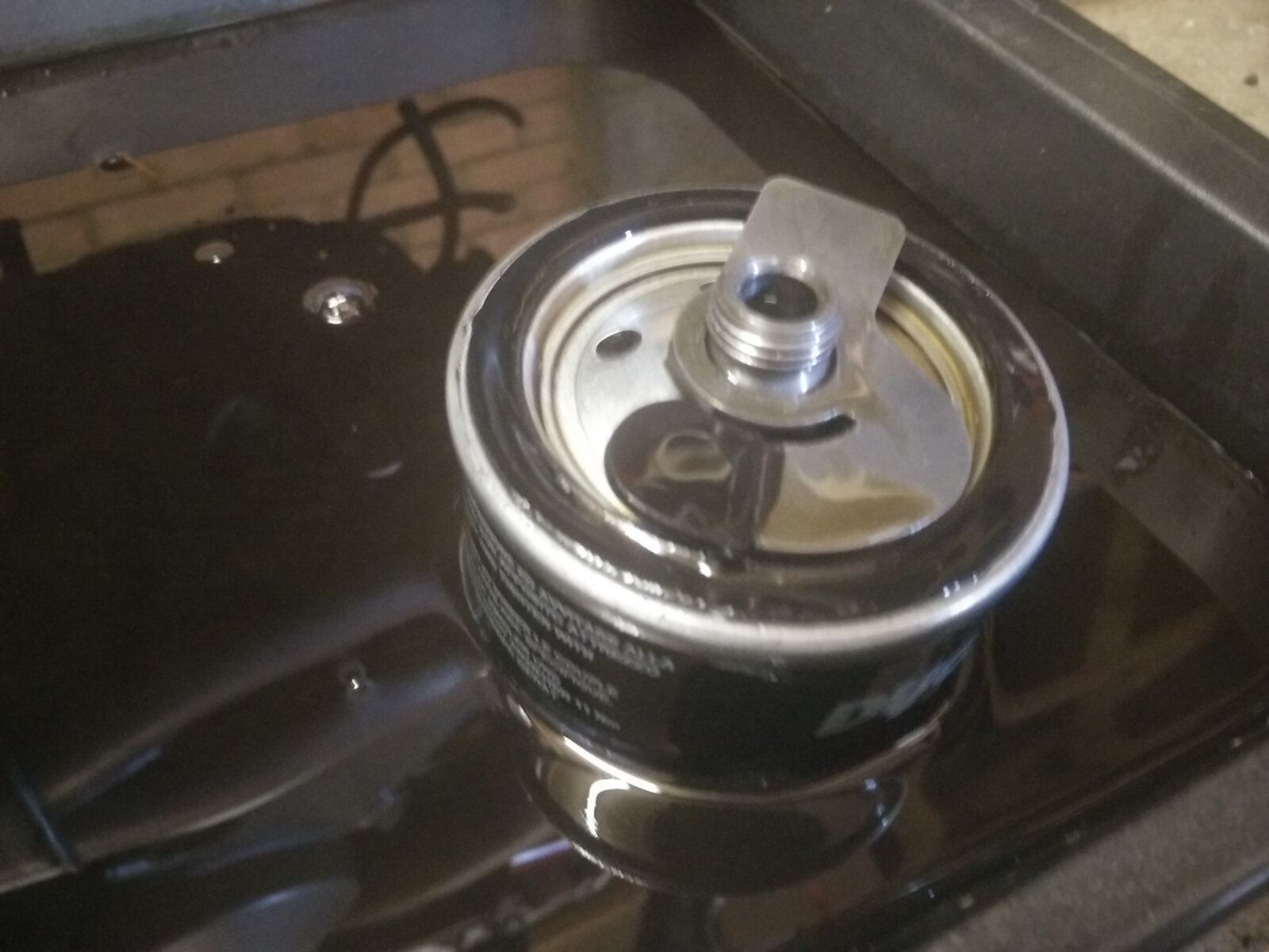

    The issue - As the filter came clear of the engine, the thread it should screw and attach to, remained in the filter itself. Pics attached.
    I've read this is a removable thread on a couple of web searches, but I'm sure that thread shouldn't come out when the oil filter is being removed. Or is it a common issue?
    The question is, how do I remove it from the filter without damaging (as it was so tight) and is that part safe to use again on the bike? What should it be torqued to when refitting?

  2. The bypass spring, that flat curved bit, should lift off. Under it there is a hex as part of the filter stub. Grip the filter in a vice and unscrew the fitment with a suitable fitting ring spanner or deep socket.
    You can reuse the parts. Make sure the bypass valve is fitted the same way it came out. Thoroughly clean the threads so they are free of oil, apply Loctite 243, medium strength, and torque the threaded stub up to 42Nm.

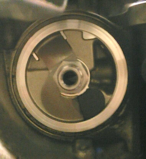

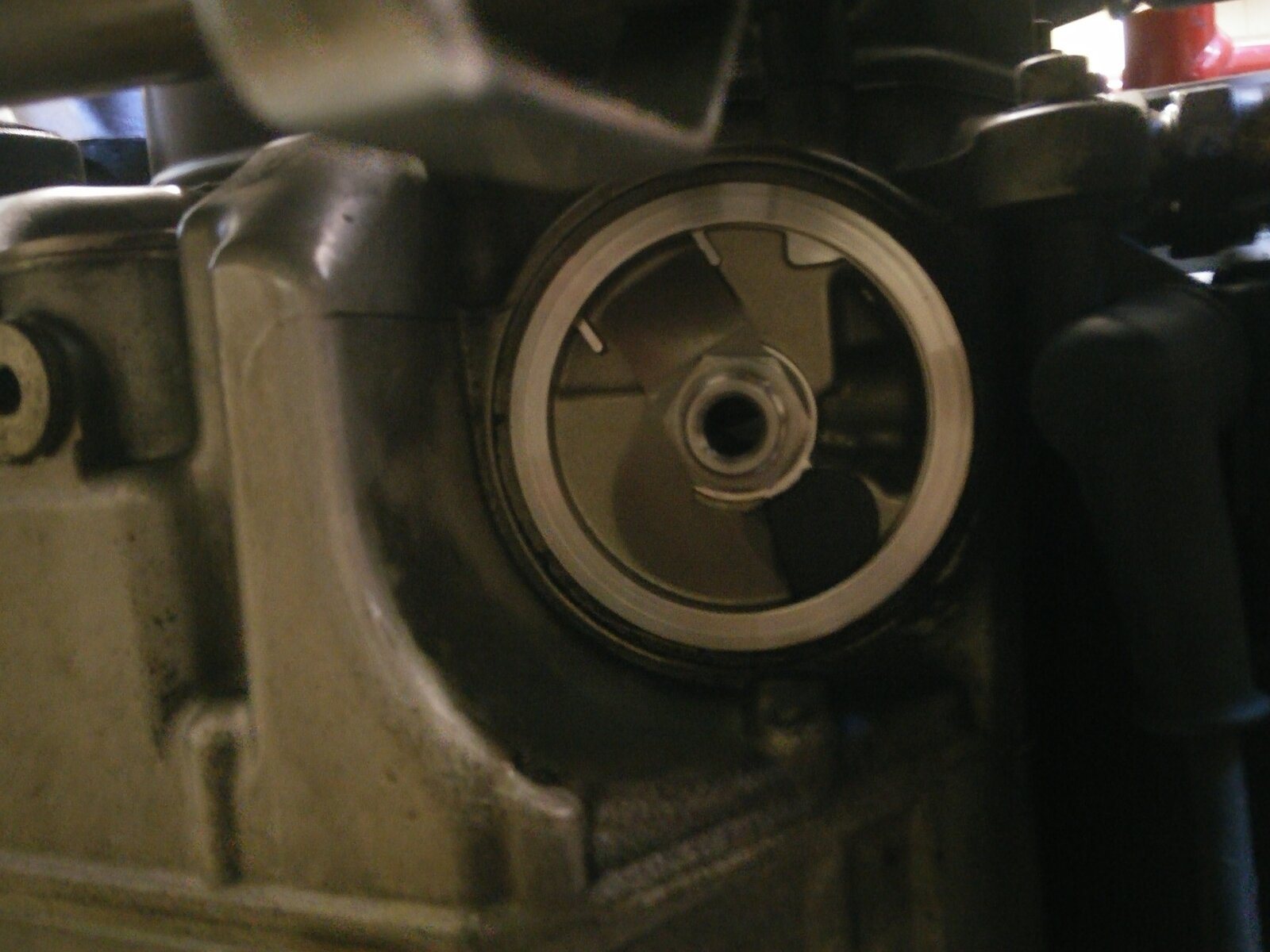

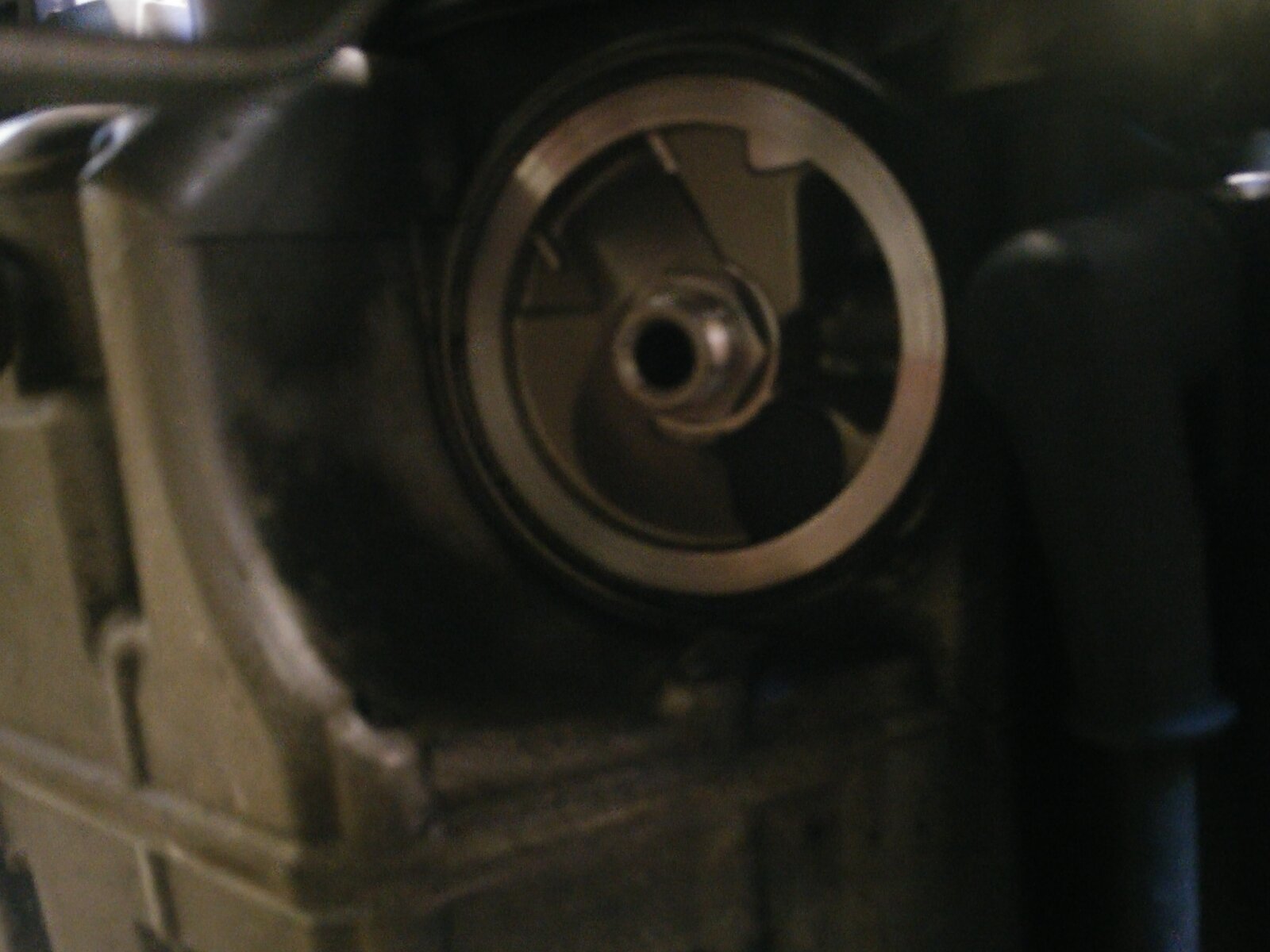

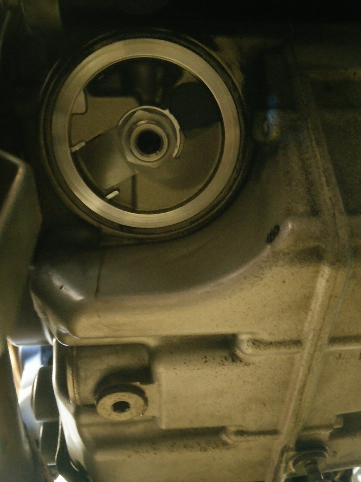

  11. Ok, so i've only just got back to this. Just refitted the spring and bolt. The squared off bare metal end of the spring is sat in the notches. The black plastic end is covering the circular hole from the engine.
    It is finger tight presently. There is zero "spring" in that piece, it is firmly pressed against the bottom of the engine case. Im sure its fitted right, but for its purpose, doesnt look or sound right if there is zero give just from finger tightening.
    Obviously dont want to make a mistake here, as that could prove expensive. Photo attached to show how it currently looks.
    Any confirmation it is right would be greatly appreciated.
    Cheers...

    #13 Vin73, Apr 19, 2020
  14. I must confess that I've never had to meddle with one of these, they have always remained in place.
    It's hard to see from your photo so I had to enhance it a little to see what way the spring is lying.

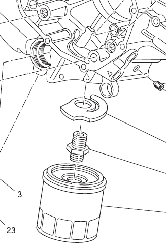

    Comparing it with the drawings from the parts lists I'd say it is the wrong way round. I'm sure @nelly can confirm.
  15. I seem to remember going through this on another thread and I'm sure the drawing was wrong.
  16. You're right, the drawing is wrong. This pic is from the Hyper 1100 evo manual, same engine.
    @Vin73 it's fitted correctly :upyeah:
  17. Thanks Derek, that is how it looks from what I can tell, now fitted.
    A clearer pic attached, the filter section is at the front of the engine, front wheel end. The rest of the casing the picture is looking towards the back.
    I just cant see how it springs at all though, its very tight fitting!
    Also, my torque wrench is 60Nm+ so I have firmly tightened, but in no way over tightening. The thread was extremely tight against the old filter it took a real weight of pressure to loosen out.
    Finally, the drain plug - no drain plug crusher ring on these, just tightened +1/8 - 1/4 tight from it locking. That sufficient?
    Thanks again for the responses, really appreciated.
  18. Thanks. Yeah the diagram doesn't look right to the actual fitting. But now confident it's fitted right.
