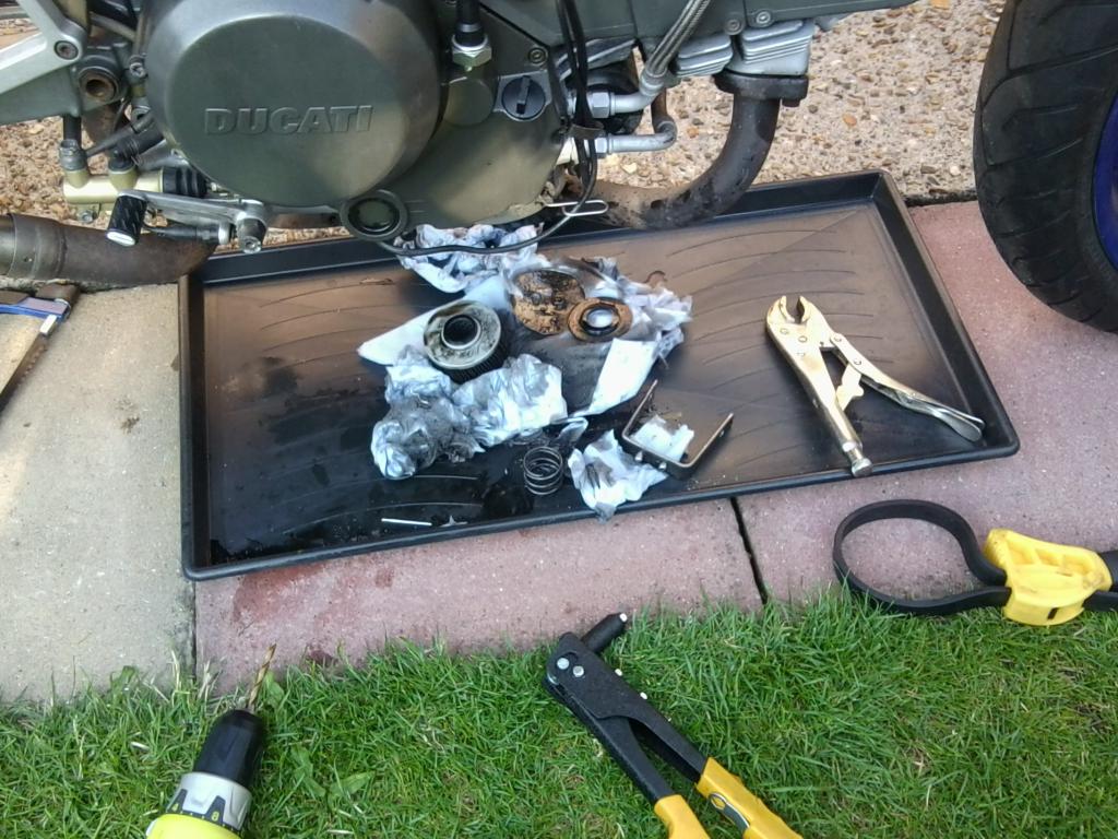

  10. ok finally got round looking at the filter a bit better
    ended up cutting bottom of the filter after a few more attempts to remove offending item
    well seems the main canister of the filter is turning but the top section is not
    the crimped/pressed section at the top edge seems to be at fault well hopefully no damaged engine parts
    so next to do is make a tool to remove it
    at least i got an idea for that thanks to dukedesmo

  14. ok bike is still winning
    made a tool to fit inside of filter and tried again
    used 6mm bolts to to locate in filter
    well filter still there bolts on homemade tool sheared ..............some twat really over tightned this one
    so back to the drawing board tomorrow and mark 2 design
    it wont bloody well win lol

  16. cheers for the advice guys but .............THE BLOODY THING IS OFF :biggrin: wooo
    ha not going to let a dam bike beat me yet lol
    so to recap i wasnt sure aat first what was stuck /loose
    well the main body of the canister was turning at the crimped edge where the threaded top section with a series of holes for oil flow is attached
    mk 2 of the tool i made worked quite well although the force needed to loosen the filter was still more than it should of needed
    cheers though guys for the advice and the pics of a home made tool which was a great idea
    now time for a drink lol

  18. I like your drip tray, where did you get that?
