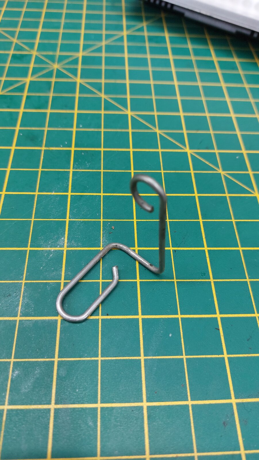

    Second question .... How does this fit please?

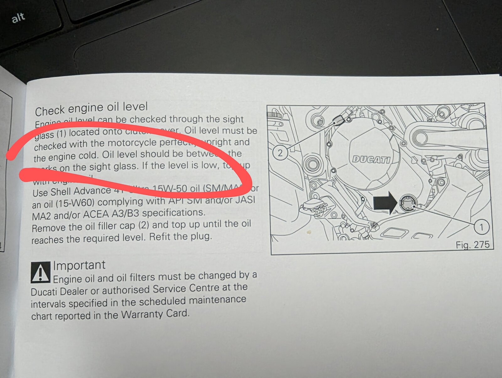

  4. I'm pretty sure my book says to check the level when the engine is COLD....

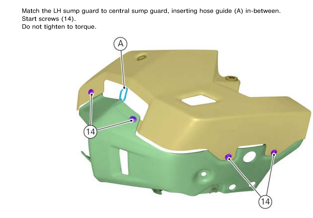

  5. The wire piece is from the lower part of the engine at the front and above the sump guard, fits on a bolt down there and is a holder / guide for the overflow / breather pipes
  6. It's surprising how much oil remains in the oil cooler and associated pipework when you drain the oil, which may well explain the quantity discrepancy. The oil should be checked with the engine hot, think the handbook suggests to do this after a ride, not just running it up on the stand, can't blame you for not going out is this weather though. As long as the level is between the 2 lines it's fine, worth checking regularly as some engines do use a bit of oil.

  9. Apologies, I stand corrected, I was of course referring to the 1260 engine which bizarrely, is checked when warm :bucktooth:
  10. Illogical captain...
  12. Perfect. Thank you.
