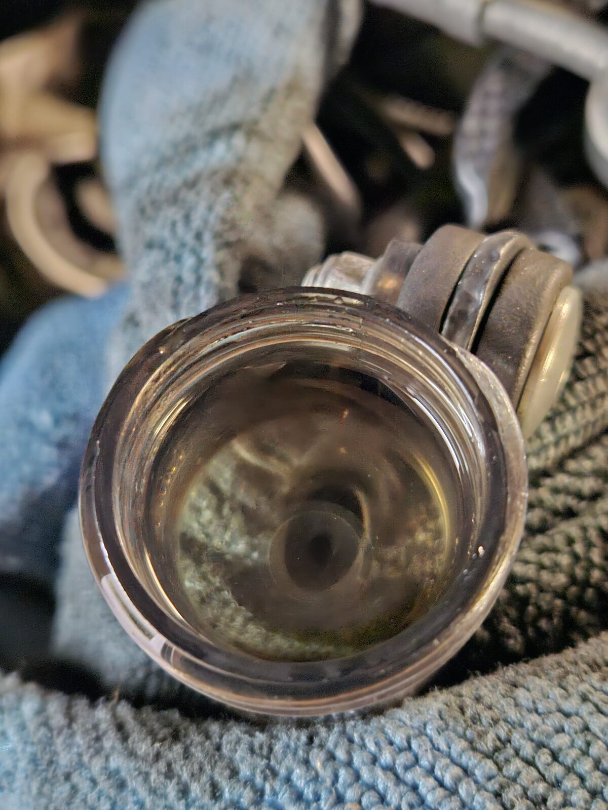

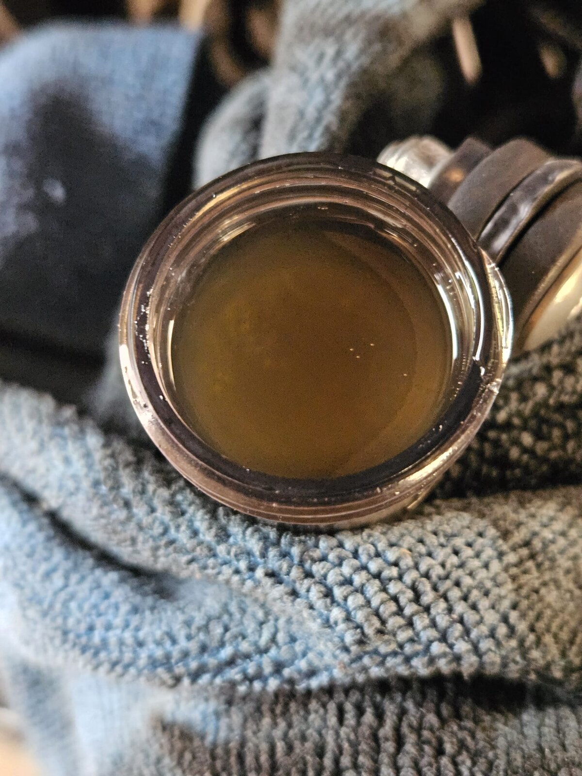

My clutch fluid did drop but whats leaking is definitely engine oil - maybe the seal is affected by leaking fluid?
Amazing that Ducati have persevered with more of less the same slave cylinder design for so long. My '98 900SSie had a similar design, and that was prone to the seal wearing. Ducati changed the design around about Y2k, to the one we have on our bikes now. A lot of folks swap them out for blingy alternatives that also have the added benefit of reducing lever effort. What you're likely seeing is clutch fluid contaminated by chain lube, hence it's discoloured.
Took it to dealer tonight, ordered new genuine Ducati 'O' rings for 60p a pair, see if that cures it... oil should not get to the back of the clutch cylinder....
PS... it's definitely engine oil.. Looks like it, feels like it, smells like it a but I didn't taste it..

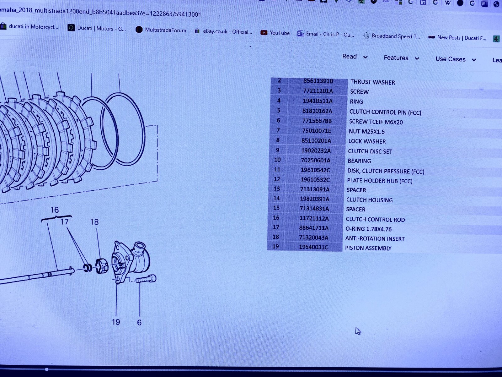

straightforward job once you have the push rod out, just lube up generously on outer diameter of O-rings once fitted, and then carefully wriggle pushrod in when replacing. Item 17 in diagram below, they are even kind enough to give dimensions if you felt like sourcing your own in viton or similar.
Thanks Chris - might seem a daft question but does the push rod just pull out from the slave cylinder side?
yes it does, it's designed to be a "slide fit" in the spigot bearing in the clutch pressure plate, on most models but tends to stick more as time goes by so often easier to remove the pressure plate and, after you have removed the "anti-spin" pin from the other end, remove it from the clutch side together with pressure plate - see if you can tease it out from slave side though, as you might be lucky.
