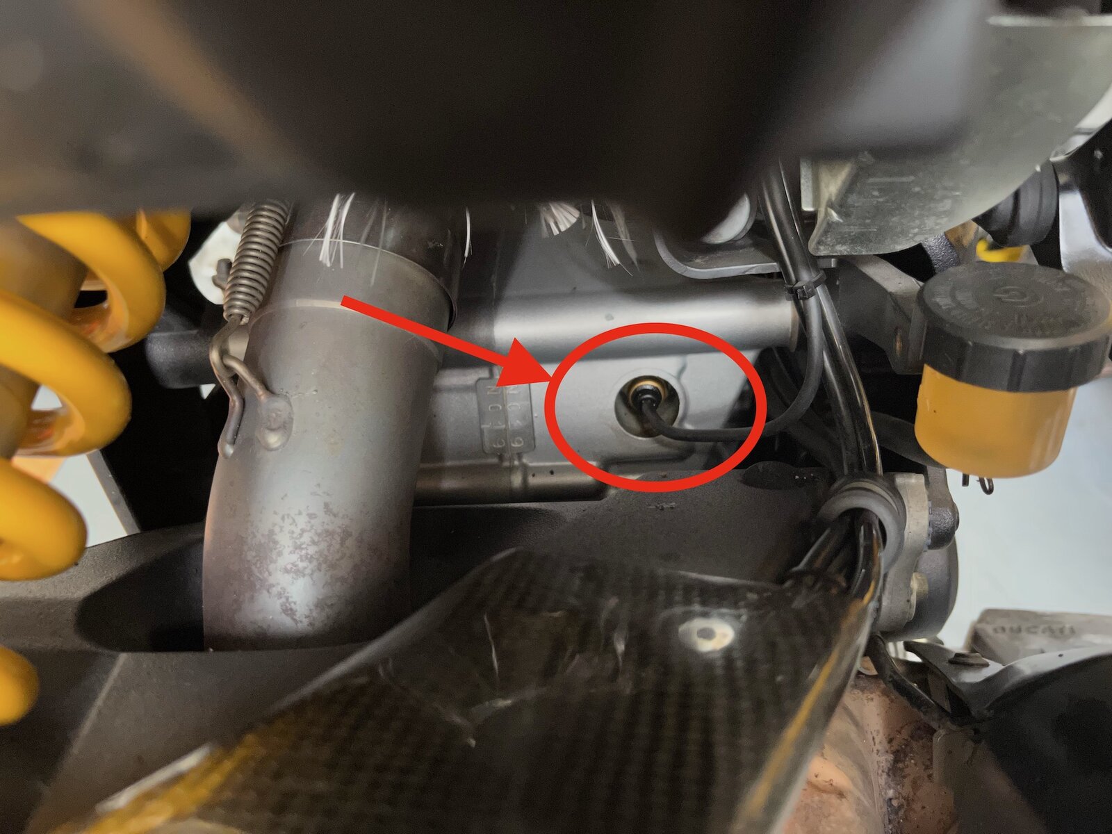

    today I have discovered some oil leakage at the gear sensor of my MTS 1200S 2014.
    Does anyone have experiences or recommendations with that?
    Change sensor or maybe just loose?
    Thanks
    M.

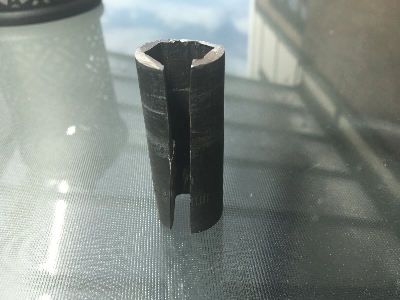

  4. I bought a deep socket, shortened it to just long enough and then cut a slot along the length of it…worked really well…

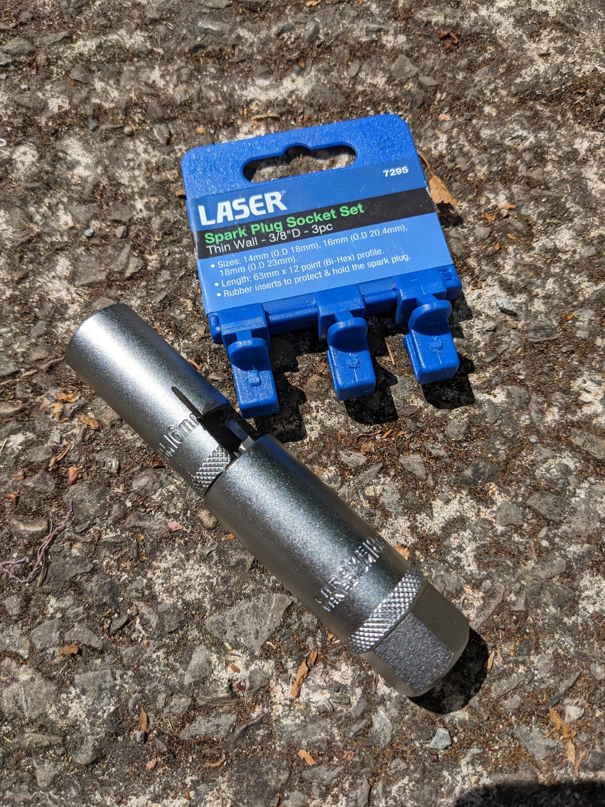

  8. I bought a set of spark-plug sockets. Chopped the 16mm one to make a cable exit, then drove that one with one of the others. As above - it's a fairly fat o-ring seal, so IMO an o-ring replacement & cleanup should be enough...
    I'll be in the garage later - think I've stil got the sockets info
