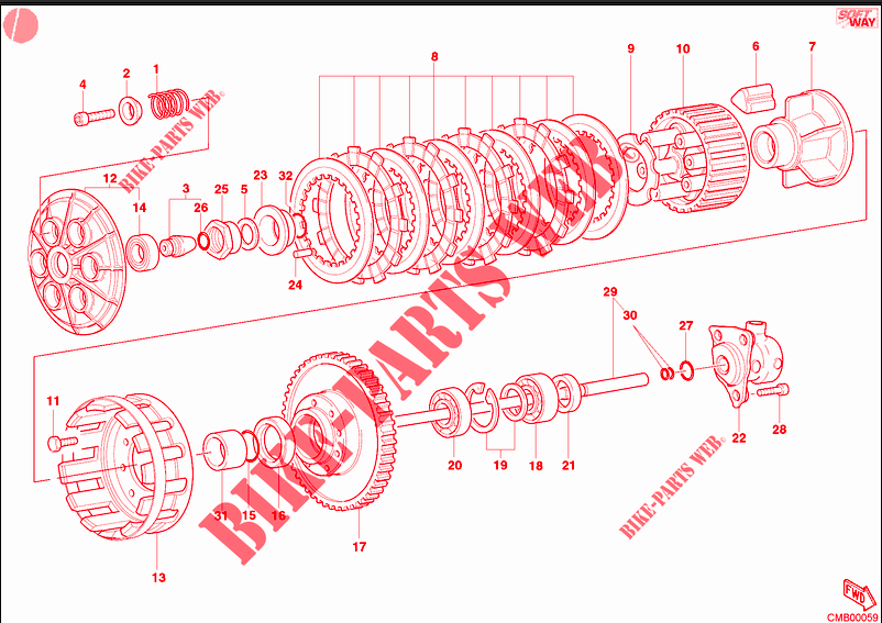

  6. @Brijon is your pushrod coming out with the pressure plate? As @kev moose asks can you release the pushrod from the pressure plate? The bearing he refers to is part 14 in the diagram below, the push rod is part 29 and it fits into part 3 which fits into part 14. NB. This diagram is from a Monster 1000 of the same vintage; I know not which parts were used in your conversion but they will be broadly similar.
    Its easy enough to check if the pushrod bearing is seized, just hold the pushrod and see if you can freely spin the pressure plate - once they're removed from the bike obviously.

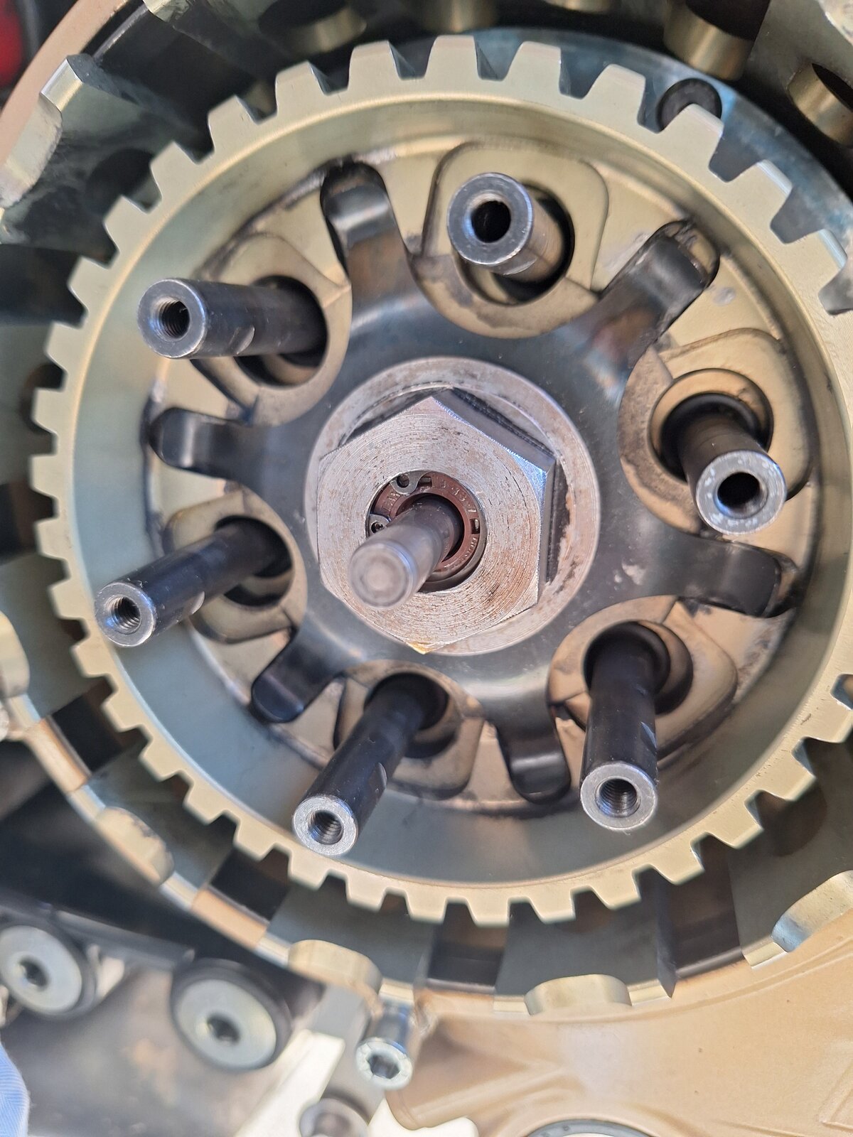

  11. This is my tightening nut with a seal and pushrod. Both seals (nut and hollow main rod) are fitted in the same direction. Thank you for your suggestions and opinions.

  12. There’s a massive gap between the pushrod and what looks like an oil seal there.
  13. It is a lip seal. When engine is running (and clutch disk are off) pushrod is not turning and no oil leak can bee seen.

  15. I don’t know what parts were used when the previous owner converted from a wet to a dry clutch but that oil seal around the push rod looks to have too big an internal diameter. Either that or it’s got horrendously worn from the push rod spinning but as you say the rod doesn’t spin with the pressure plate perhaps it’s just the wrong size seal?
    Is this issue something that’s just happened or has it always been like this since you bought the bike?
    Have the correct components when doing the dry clutch conversion been used?
    As a start, if it were me I’d pull the pushrod from the slave cylinder side, replace the 2 o-rings there with new ones. I’d check it’s the correct pushrod too. I’d replace the brown oil seal at the retaining nut which is visible in your photo above with one that has the correct OD, ID and thickness - you’ll need to measure those.
    However, I hold my hand up and admit I’ve yet to see a dry clutch that has an oil seal around the push rod in the location yours does - hence my question as to what parts were used when the conversion was done.
