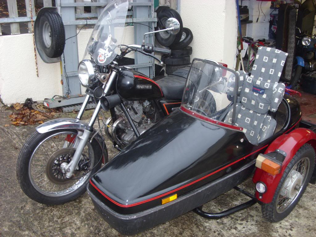

  7. Im a bit late in the season really, but, just finishing a DR650 rs as a winter commuter, I have to BUILD a stainless exhaust system to finish her which is proving a little daunting so dont plan on too much winter work for her, once the salt is down, her and the cally, thats the solo as I also have a cally outfit, willbe laid up for only the clearest days. I also have an old xj900f shafty which I may drag out should I not finish the DR in time.
    When the weather gets too rough, I use this.................
