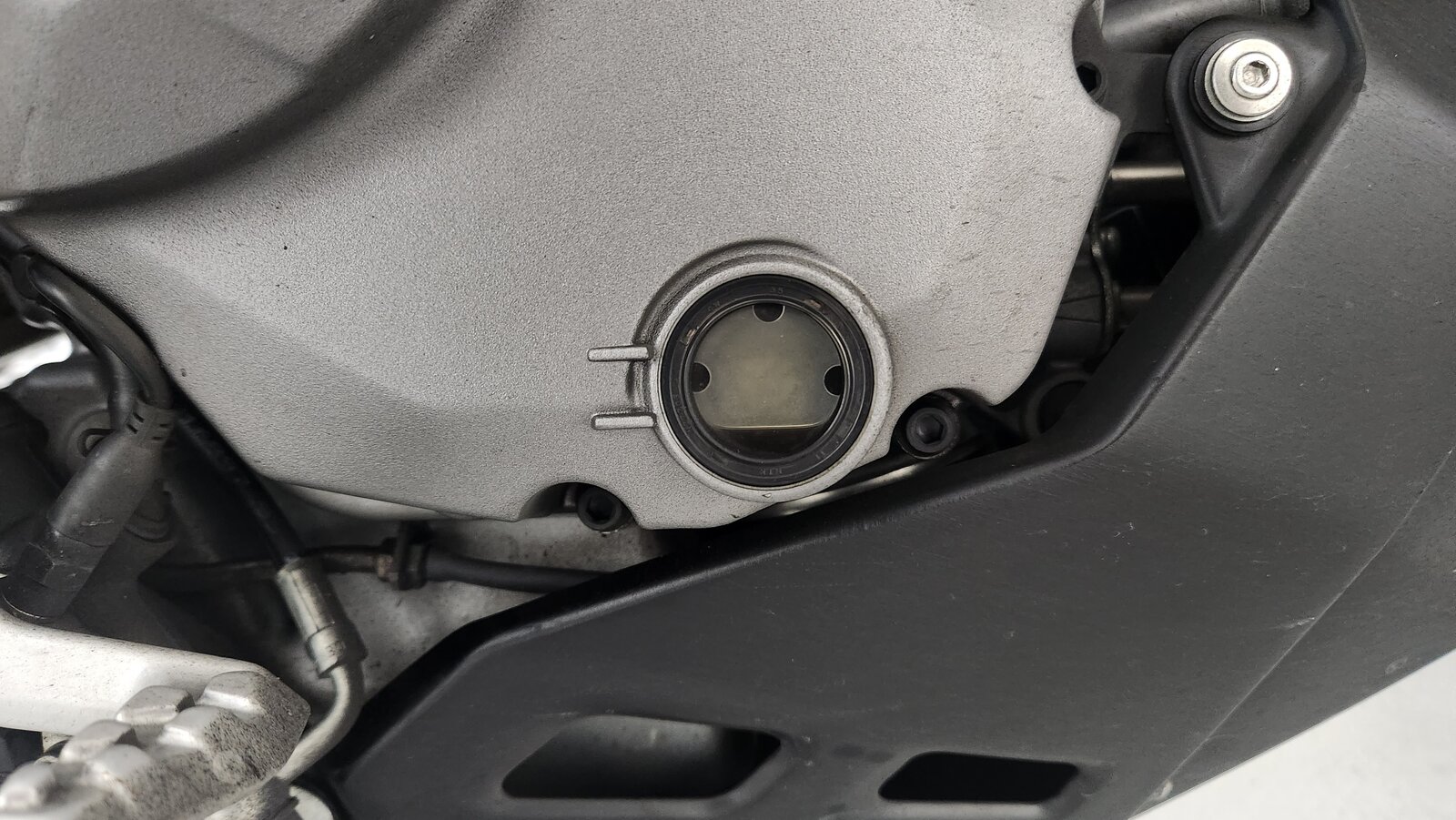

  1. I've been on the road for just over a week now, done about 4,000 kilometres since last Sunday. Been checking the bike daily when it's put up for night and noticed its using oil a fair bit. It had a service when I bought it (collected a few days before my trip) and the oil was just above the first marker. Now it's slightly below. Granted I've had some very spirited rides and long motorway stints the past week. Got one more week left hence I'm being a bit cautious.
    2 questions, is this normal oil consumption and which oil do ducati dealerships put in? Gonna top her up tomorrow.
    Pic taken whilst on the centre stand
  2. For the 1260 the reported limit of oil consumption before Ducati recognise a fault = 1L per 1800 miles (3000 km) limit although they use weights rather than volumes and won’t quote limits.
    Mine used 480 ml per 1800 miles or 1L per 3,750 miles when I first got it but that decreased over time and now it’s got 15,000 miles on the clock doesn’t use much at all UNLESS taken on long motorway hauls then it goes up noticeably.
  3. Oil consumption is highly variable. Long trips on the highway with highway speed cause a significant consumption. Up to .5l/1000km. Normal or spirited riding results in minimal oil consumption. Overall I need to put in 1-1.5 l between services.

  5. Oil recommended is is 15W 50 Shell Advance 4T fully synthetic although my dealer now uses Motul 7100 4T 15W-50 fully synthetic as it’s slightly cheaper and fully meets requirements

  7. Mine uses oil. A lot of oil. Ducati have had it in twice but assure me it is fine. My calculation is approx 450 mls per 1000 miles.
    When they weighed it they said it had hardly used any, despite the oil level dropping considerably in the sight glass. It was just below upper limit and had dropped to below bottom line.

  9. I also think some of the issues could be caused in having the bike consistently level when checking. I’ve never really used much oil on any of my 3 Multistradas

  11. I don’t think the difference between the high and low marks on the glass is much at all. I have it in my head someone once told me it’s 250ml but can’t remember where I heard that.
  12. I thought I read somewhere on this forum that it was about 1 litre!
