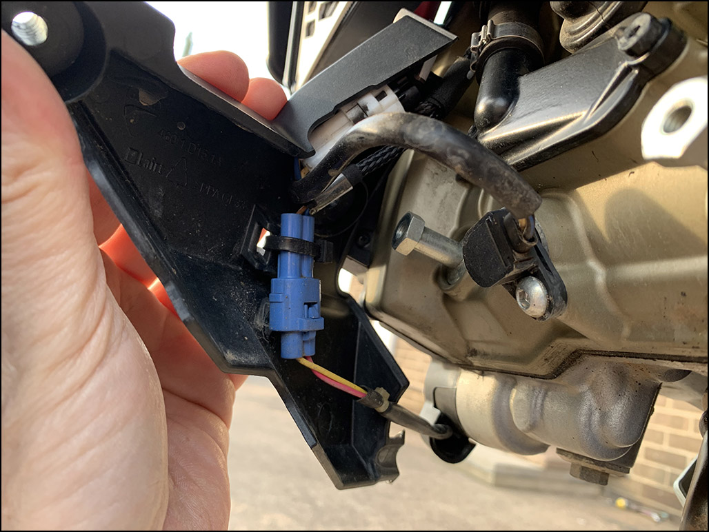

  1. whilst fitting the engine guard by evotech, I wrongly undid a screw holding a plastic sensor on to the engine. Oil started to pour out, not much but my oil
    Glass is now at the bottom for level, the bike was serviced before I got it and hasn’t been used since the service.
    Should I top it up and with what grade of oil?

  7. Oly, I posted this same question in another thread, but had oil come out of cylinder head when loosening left bolt in pic below. Is that the same one you had oil come out of?
  8. When you remove that cover the screws should screw out the bolt that goes into the head. If the whole lot starts spinning you need to try and hold the main part. You can see it has a hexagonal on it for a spanner, not sure how easy that is to access with the cover fitted though. IMG_2716.JPG
