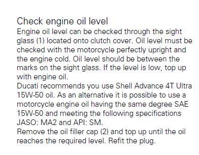

  8. This is what it states in the manual...
    I read that as only use 15W-50, hence no table like they used to show. I also read somewhere the DVT is designed to operate with a heavier oil. Could be just hearsay of course.
