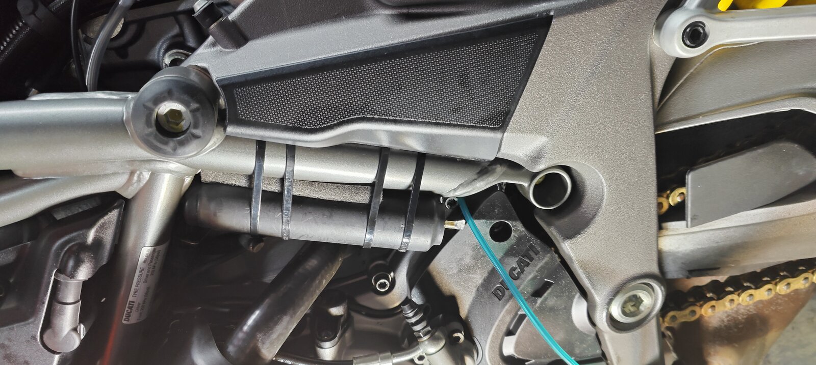

  3. Have you considered fixing the oiler to the frame on the other side? That way you can feed the tube on to and around the inside of the swingarm following the brake pipe/abs sensor wire. I don't have any photos unfortunately but it is how I did it with my 1200 which ensured the tube never got close to the cat etc. 1260 might be different but worth a look?
    Edit: I found a few pics. Not great but explain the above a bit better. The arrows show how the tube was covered and where the feeder was positioned.

    Many thanks for your pics, that's exactly what I'd figure out I'd have to do to stay well away from the exhaust system.
    Just waiting for a new feed tube to arrive and then I'll follow your lead.
    Many thanks for the help.

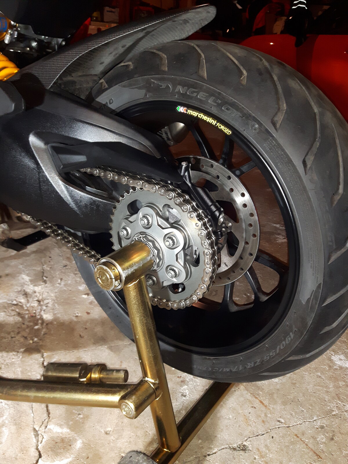

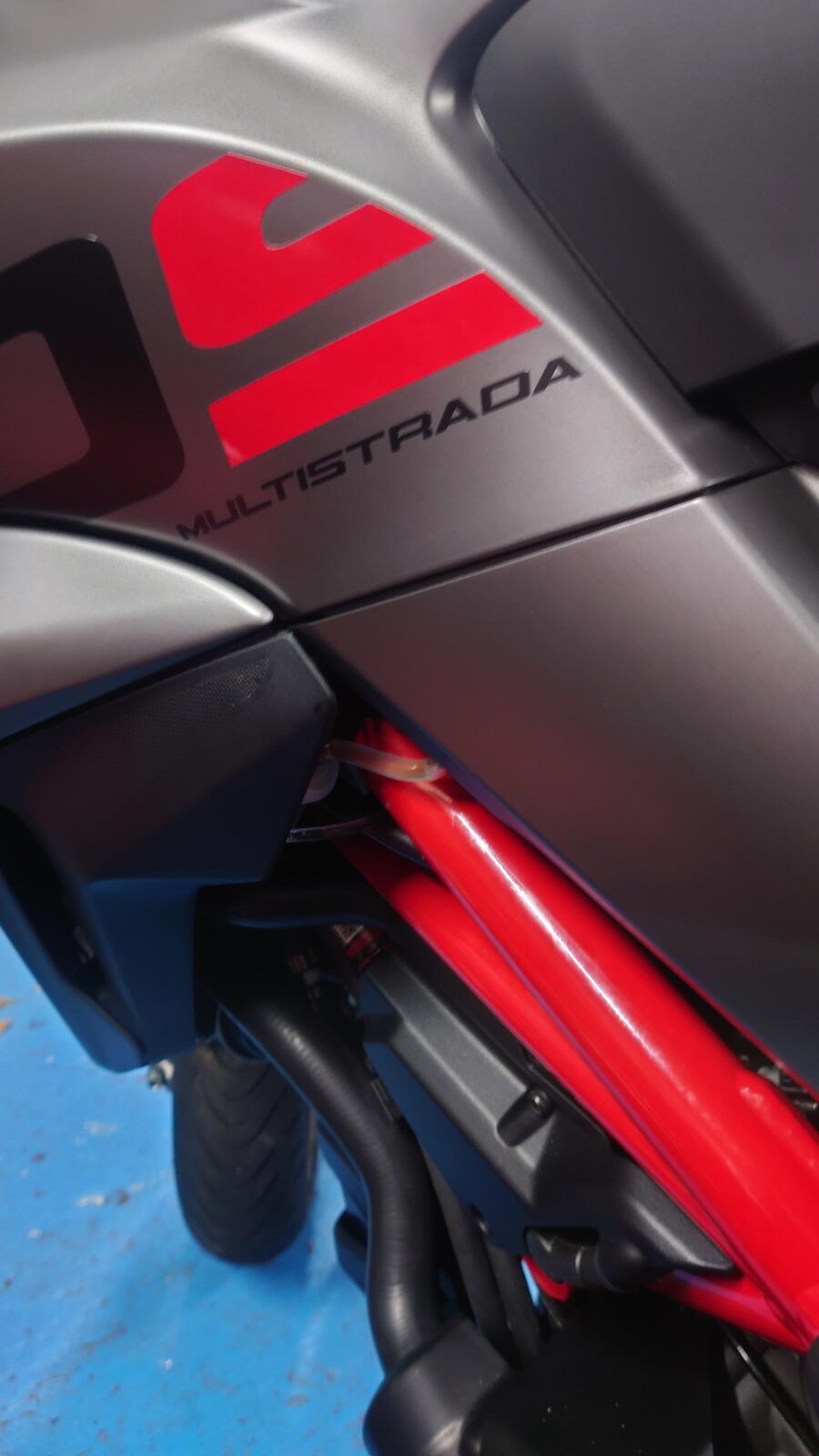

  18. On my 1260 which I just fitted a PD Oiler mini to I ended up placing the reservoir up front with some sticky velcro. 20221217_160229.JPG You can see the top just peaking out. You might get the full one up here strapped to the frame as there is quite a bit of room under the panel.
    To oil the chain I very tightly strapped it to the engine mount on the inside of the frame. So far this seems to be working

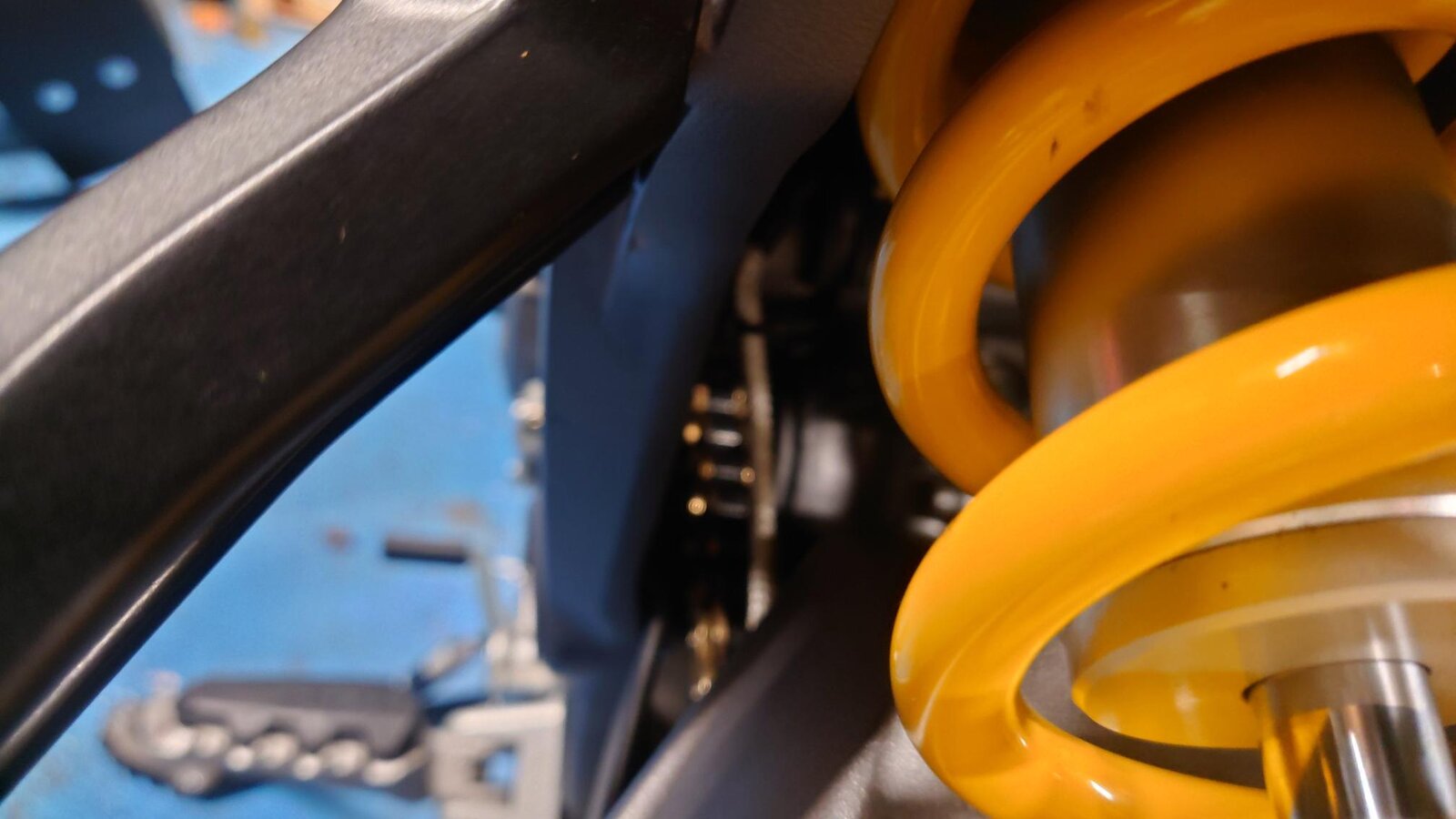

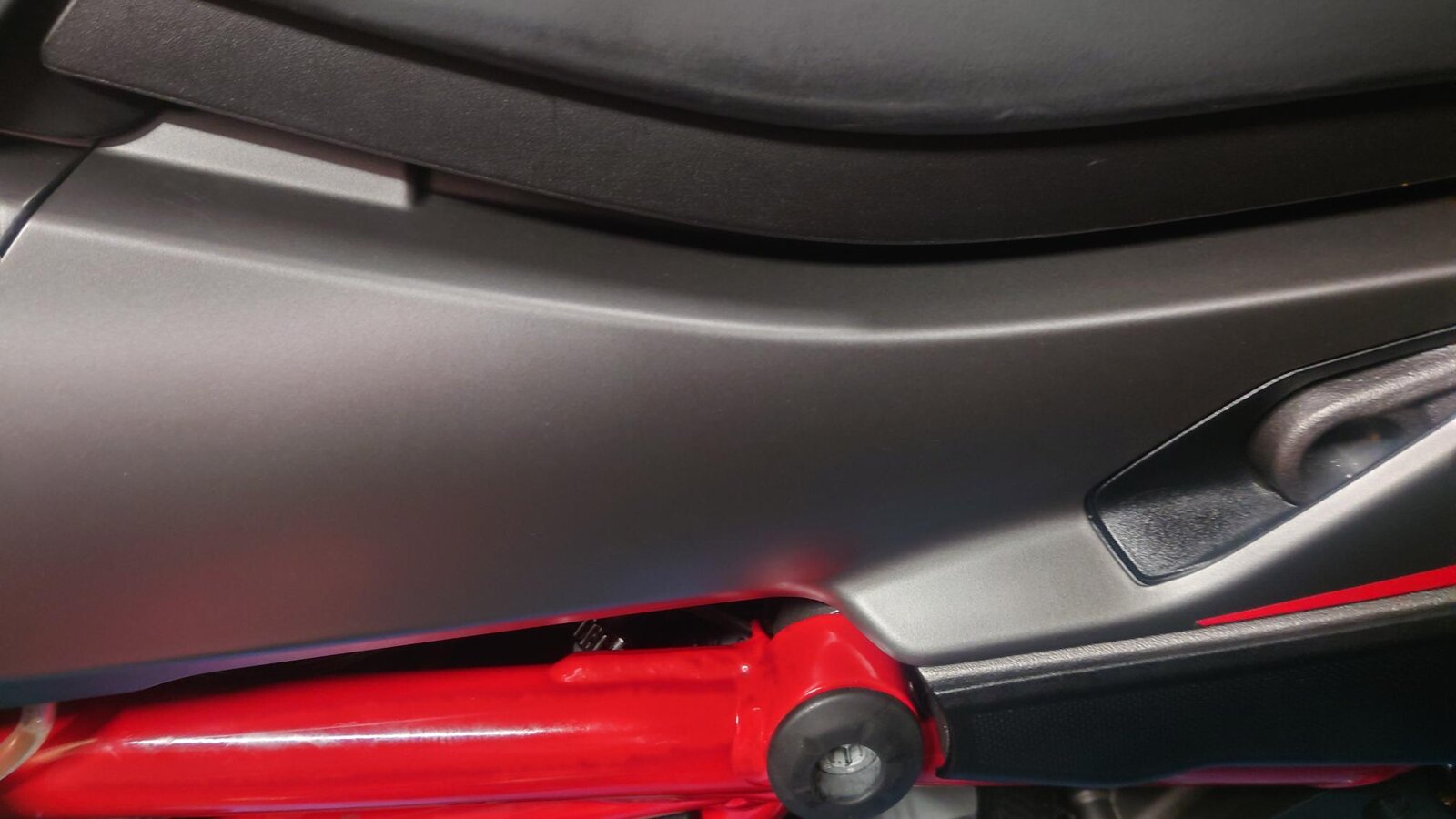

    Because it's a mini the pump is cable tied onto the cables that run behind the side panel under the tank. 20221217_160233.JPG

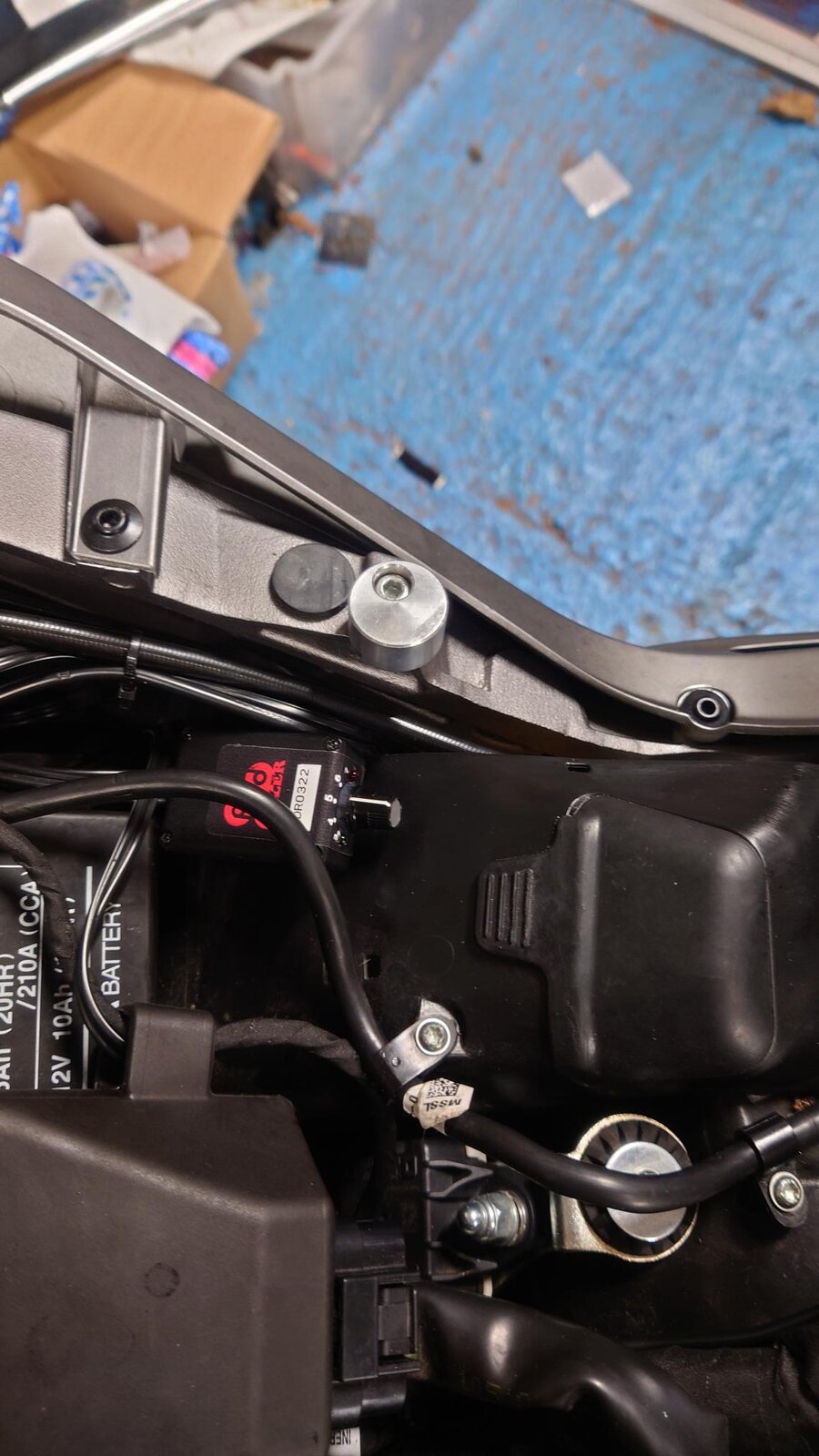

    Then the controller is wired into the aux socket in the tail and sits just alongside the battery. 20221227_111958.JPG
    Everything is routed down the left side when sitting on the bike and you should be able to feed the pipe behind the frame in your picture and down to the swingarm. I occassionally use some dabs of silicon sealant to hold the pipe in place as it's easily removable.

  19. That's a pretty neat job. I got the pump mounted on the frame and it's virtually invisible. I also ran the wiring up a similar route to yours although I took the power for it from the back of the usb socket under the pillion and mounted the controller up there. It means I can adjust the flow without removing the main seat.
    Otherwise a very similar fitting.
    Thanks for your pics.
