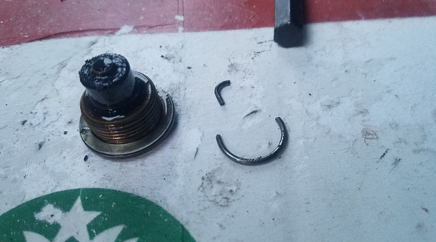

    Changing the oil on my 2000 ST2 and this was stuck magnetically to the drain plug!!! I can't think it's a good thing!!
  2. Oooh that doesn’t seem like the greatest thing to find?!
  3. End of some sort of spring, for auto return, possibly off a gear lever?
    Can someone pull up a schematic and see what it might be off?
  4. crimminy, I have been having a miss upshifting into 4th of late
  5. but then its a dry clutch so how does that work?
  6. thanks guys. I'll pull that hidden filter in the morning and check it. Sounds likely to me!
  7. as above - looks like the right gauge for the gearchange return spring (drawing 2/part no 27). If it is then you will know about it as you would have to manually* (you get the knack with your foot after a while) return gearlever to 'centred' position every time you use the box in either every up or every down gear selection. If it is this spring and you don't suffer with * then it means it's the remains of a previous spring and someone has already replaced it. It's common for the fork return spring (drawing 2/part no 20) to fracture but it's made from a smaller gauge wire and rarely impedes gearchanging even when broken.

  9. Thanks for spelling it out for me. I hope getting in to that spot isn't too hard. looks like I'll need a torque wrench and an alternator cover remover?
