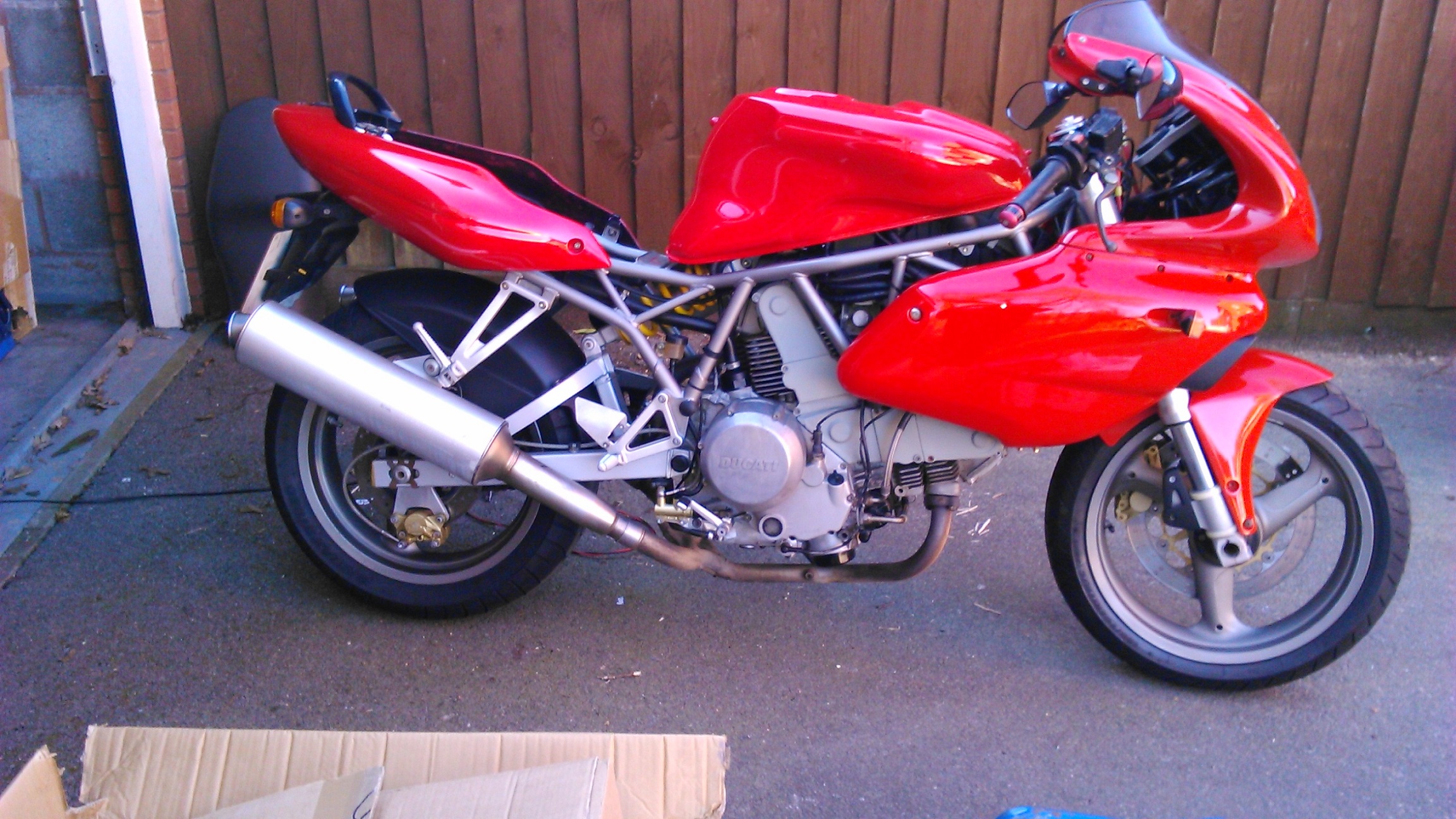

  1. my respray has been done and debating on decals, probably wont..
    panigale red!!!
    have a problem which is how do you fit the filler neck back in??? any tips, tried Vaseline to slip in but not worked yet
  2. They are sods to get in, I can't remember how I did it some one will im sure
  3. used a smear of grease on the o ring and push like a bastard hold in place while getting
    the grubscrews in place to hold tight
    have to admit i didnt do mine on my own
    got the wife to hold it down while i put in a couple of grubscrews lol
    took more than one try as top seal kept moving
    remove hammers from reach before hand :D
  4. Putting it in the freezer apparently works. It shrinks it just enough to make it fit.
    #4 st3v3, Mar 16, 2014
    • Disagree Disagree x 1
  5. while waiting for a few parts to arrive, I put some fuel into the new tank and tried to start the bike. wouldn't go??
    after fiddling around then studying pipework , it does help if you feed the fuel into the carb/bodies not out!! :Asshat: a change of hoses and we have a runner.. first time in a year and saved from being broken by previous owner:upyeah:
    roll on delivery and will go for MOT this week
  6. thanks to Ian (gillan900),now have some decent fitting indicators and mirrors along with the complete tank cap mount,
    will have a look at cleaning off excess paint around opening then its back to freezer.
  7. Vaseline and a fat bloke to hold it down, luckily I don't have to look to far to find the fat bloke (mirror usually!) :upyeah:
