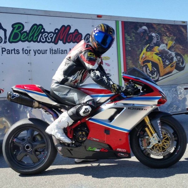

  2. Sexy indeed
  3. It weighs 364 pounds wet, with 3 gallons of fuel. How does that compare to stock?
  4. Nice of you to think about us but the 1098R graphic on the fairing is about the only 1098R thing about it. Seat, fairing and belly pan are aftermarket, the wheels are ..... well other than fuggly ugly are god knows what but on the positive side the forks might be D16RR which are a bit special. Quite sure it will appeal to some but not me. Andy
  5. The forks are better than what's fitted to the D16
  6. Mine weighs 183kg with 15 litres with a steel 70mm full system. Andy
  7. Bit of a grey area for me, I don't know anything about Ohlins forks, so an easy mistake. Andy
  8. Not feeling the wheels.
  9. I said for 1098r perverts, not perfectionists! o_O
  10. Here's the info: £27,168 at todays exchange rate...
    Weighing in at 364 pounds wet with 3 gallons of gas, and pounding nearly 200HP to the rear wheel with a beautifully linear power curve and loads of torque, this is THE BEST SBK I've ever rode. EVER. Sorry Superleggara owners.
    I've only owned personally owned 70+ streetbikes (over 50 Ducati's), and logged hundreds of thousands of miles between all sorts of different riding styles, and I can honestly say this is the best SBK I have ever ridden (sorry Superleggara).
    The power, torque, handling, braking, and flat out stability of this bike would make WSBK champions like Carlos Checa or Troy Bayliss feel right at home.
    Just what has gone into this epic build? Over $100,000. Which is quite the steal when you consider the WSBK level performance and below WSBK legal weight of this machine!

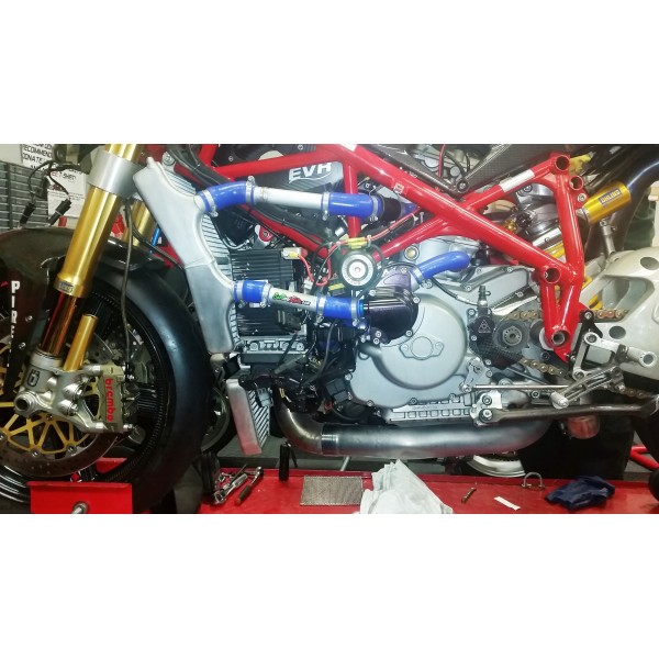

    Here's the build sheet:
    • Afam Quick Change Sprocket and Carrier
    • Akrapovic Full Titanium Exhaust with carbon canisters
    • Brembo HP Rotors
    • Brembo Racing Billet Monobloc Calipers
    • Brembo Racing Billet Master Cylinder
    • CNC Racing Adjustable Rearsets
    • CNC Racing Quick Release Gas Cap
    • CRG Adjustable Clutch Lever
    • Dan Kyle Quick Action Needle Bearing Throttle
    • Dan Kyle Rear Shock Linkage
    • Desmoto Sport Triple Clamp Kit for FGR Forks
    • Ducati Corse WSBK Racing Camshaft Kit
    • Ducati Performance oversized (4.4 Gallon) aluminum fuel tank
    • Ducati Performance Racing Seat
    • Dzus Fastener kit
    • Earth X ETX24C Lightweight lithium ion battery
    • EK 3D Chain
    • EVR CTS02 Racing Slipper Clutch
    • EVR Clutch Cover
    • EVR Slave Cylinder
    • EVR Carbon Fiber Airbox
    • Galletto Radiatori (H20 Performance) WSBK Radiator Kit
    • Gilles Tooling Clip Ons
    • Integrated Tail Light
    • Microtec M197 ECU
    • Microtec M163 Autotune Lambda Unit
    • NCR Titanium Ride Height Adjuster
    • NCR Titanium Rear Hub Cover
    • Ohlins FGR Gas Pressurized WSBK Forks!
    • Ohlins TTX Rear Shock customized for new linkage
    • PUIG Double Bubble Windscreen
    • PROTI Titanium Bolts throughout!
    • RAM Magnesium Swingarm
    • ROTOBOX Carbon Fiber Wheels
    • Samco Hoses
    • SpeedyMoto High Flow Water Pump Housing
    • SpeedyMoto Under The Bodywork Frame Sliders
    • Spiegler Stainless Steel custom brake lines
    • Cylinder Heads have had the WSBK required restrictor "humps" removed during porting and polishing.
    • Ignition delete (ignition and keys are included, if you want to add weight back to this bike)
    • Carbon Fiber Radiator Overflow tank located were ignition was
    • Carbon Fiber sprocket cover
    • Carbon Fiber Gauge Surround
    • Matte Carbon Fiber Tail unit
    • Custom license plate mount
    • Graphics are Vinyl, applied by Incognito Wraps in Las Vegas. They are easily removed if the next owner so desires.
    • There's probably a dozen other upgrades I'm forgetting as well...
    Were you about to purchase an 1199/1299 S/R? Make the smart choice and buy my 1098R instead, you won't regret it!
  11. 165.1 Kilo's
  12. the wheels look dymag maybe? But certainly ugly
  13. Not Dymag - there's are a bit nicer - they are the Eastern European ones I think - I forget the make.
  14. For some reason the whole of your first post didn't load so all I saw was the top picture and didn't twig it was someones "improvement" project for sale. Looking through the spec though it's a shame the builder having spent shed loads on bling didn't upgrade the engine main bearings and gearbox because with 200 rwhp, they are the weakest link for the bike and will implode if ridden hard. Andy
  15. Rotobox http://rotobox-wheels.com/ Andy
  16. yea seen the rotobox thing after I typed... Still ugly Imo ... Being carbon I'm sure they are lighter than standard but look very chunky for 5 spokes.
  17. Better than wsbk. What a clown
  18. I've been looking at those radiator / oil coolers for a while, but have resisted pulling the pin. :worried: They do look good on the bike. :sweat:
  19. It would weigh less if he took the side stand off. :p
  20. Yeah it's not that light.
