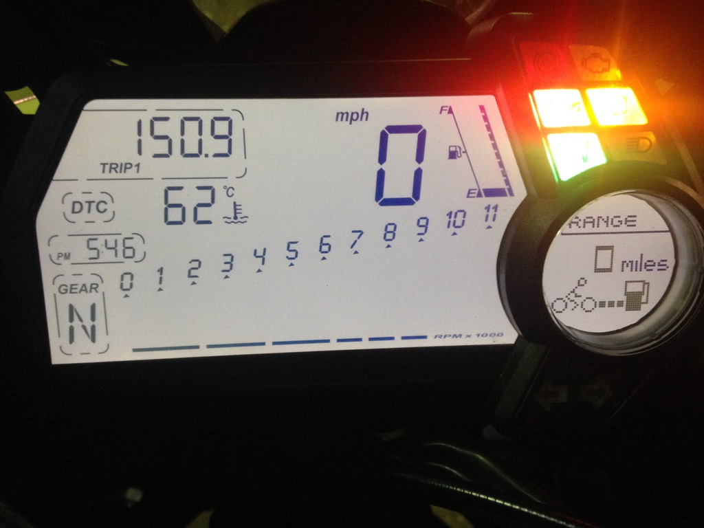

  11. Your fuel sender is knackered mate as you have described exactly what mine would do time after time. I even got to the extent on my trip to Norway with a mate last year we had to plan fuel stops about 150 -160 miles maximum which in the more remote parts wasnt easy to find places.
    Replaced the sender on my return and now works perfectly with me refuelling at about 175 miles when on my boring 54 miles a day commute (51 mpg at 70 -80 max) .....both pictures using fuel from same station, same ride mode, same riding manner
    Before
    After
  12. Your fuel sender is knackered mate as you have described exactly what mine would do time after time. I even got to the extent on my trip to Norway with a mate last year we had to plan fuel stops about 150 -160 miles maximum which in the more remote parts wasnt easy to find places.
    Before
    After
