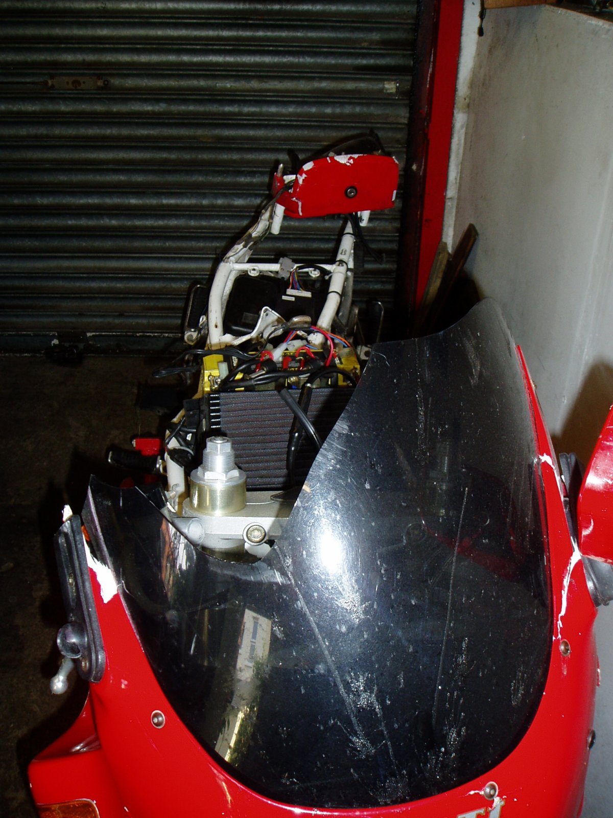

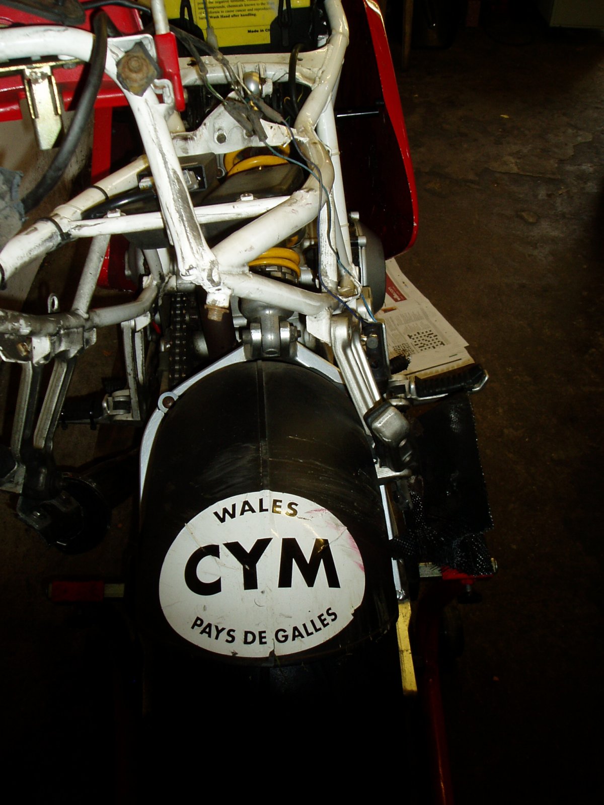

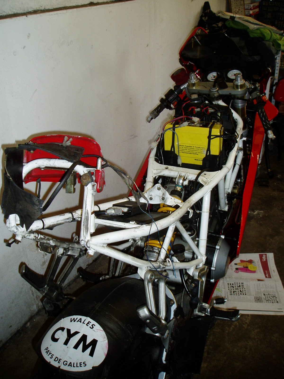

    HTF did you manage to do that?
    Looks like someone hit you from the side and pushed it across the tarmac.

  7. It says something when the 'Wales' sticker is the only good bit left.
  8. I think there is significantly more damage than the frame needing to be replaced.....Looks like a total write-off or a total re-build, with a new V5 for different frame and engine numbers......ie; another bike.......

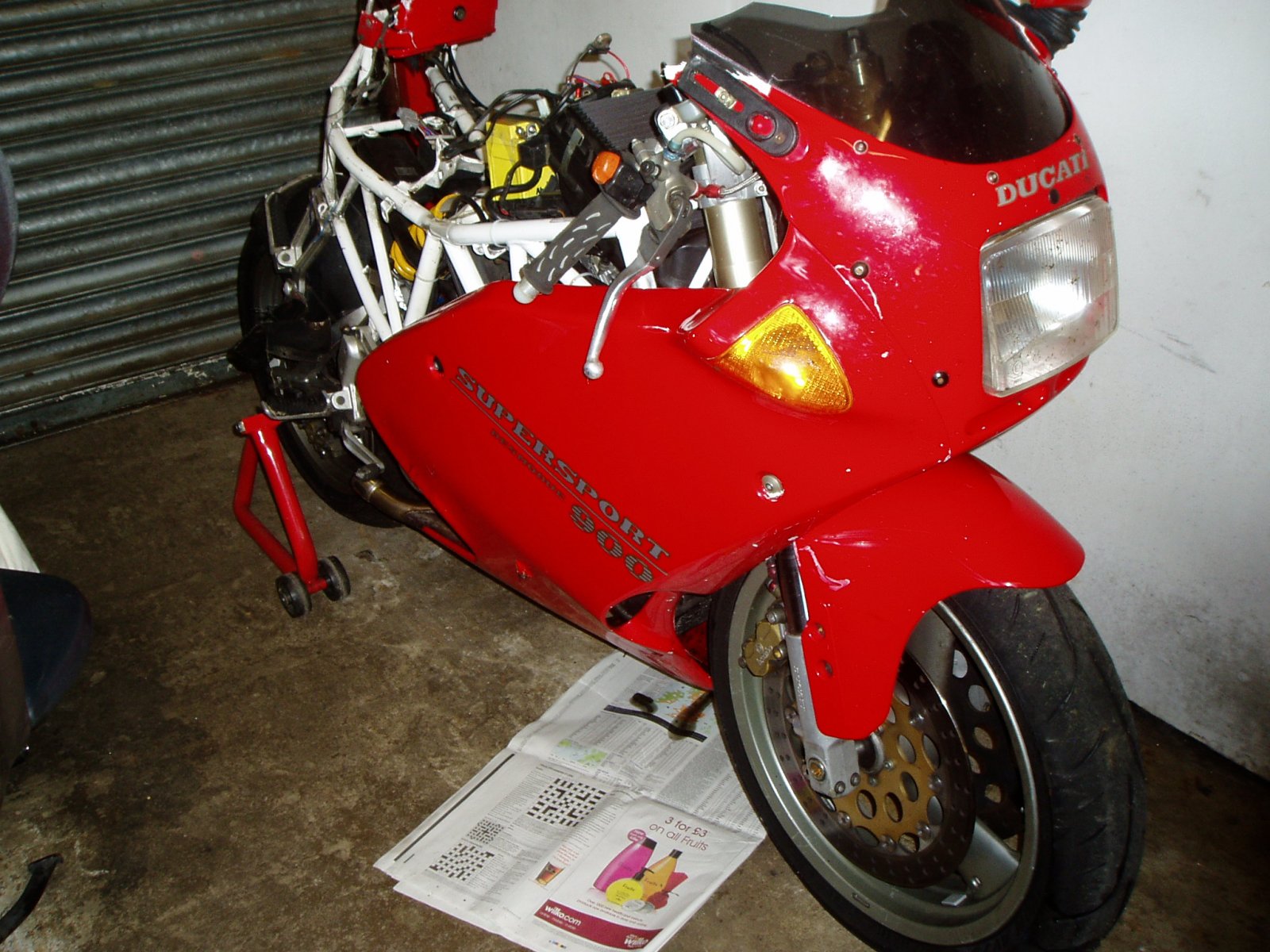

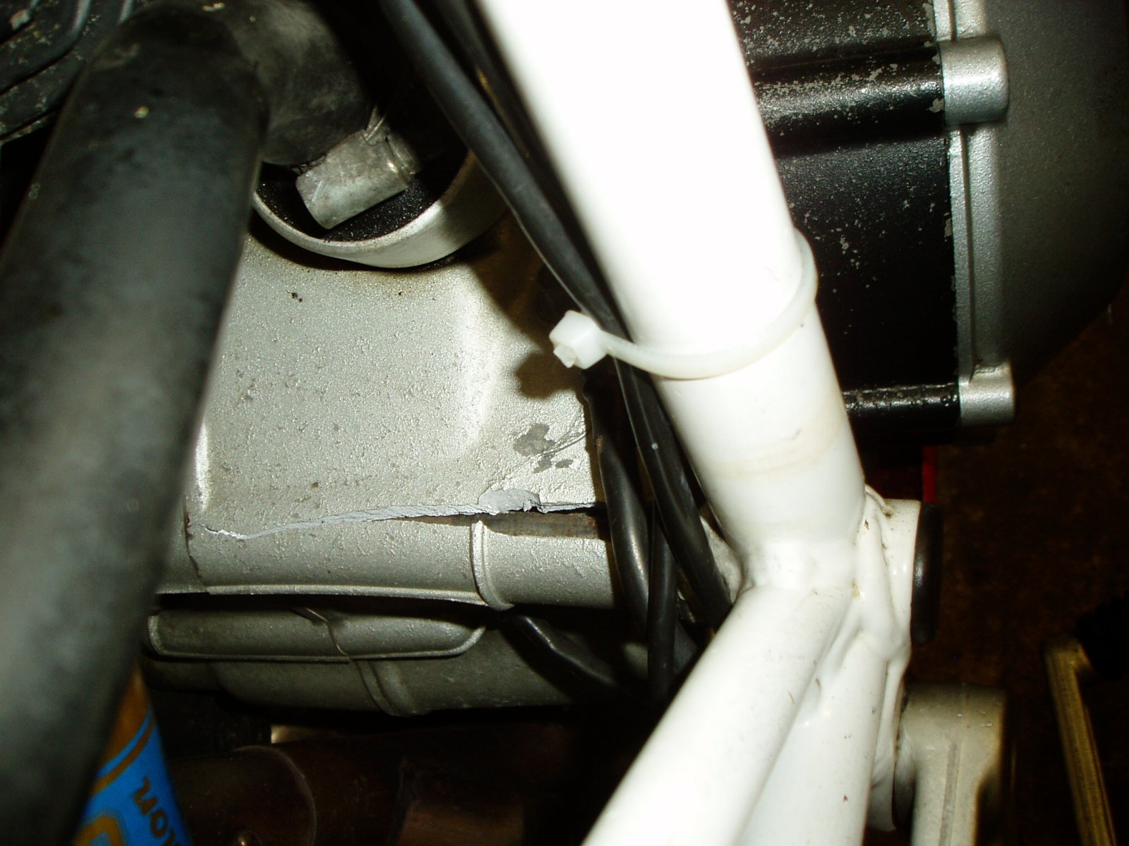

    I've not had a chance to make any sort of assesment of damage yet although I can report that the clocks and the headlight are undamaged. Result!

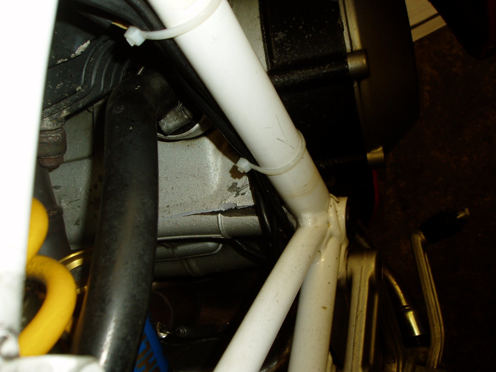

    With any luck the escaping (escaped, really) oil has only come from the sheared lower oil cooler and the only damage to the engine is where the frame has tried to remove the rear mounting bolt tunnel, which I should imagine is a fairly simple weld.
    Hope the forks aren't too damaged .... hard to tell if they're bent with the fairing so pissed. The exhaust header system is OK, as is the rear Ohlins. My lovely one-off Spondon clip-ons may be straightenable.

    As the ambulance guys had to help me over the fence I can only assume that the bike (and me) had actually cleared the fence. Hence the bent rear subframe (landed on it's arse) and relatively un-smashed front.

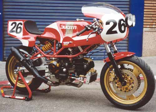

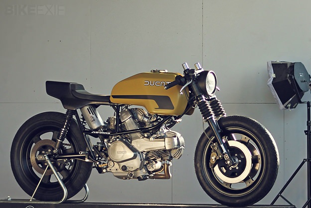

    I have 2 Pantah frames, one of which I need, the other is spare......
    The idea is to make a 900ss-engined Super Pantah as the engine goes straight in. I started out with the idea of doing something like this:
    But race rep project fatigue has driven me more to a 900ss version of this:
    So you'll now be wanting my spare frame, won't you?

  17. This one I really like (bottom one)
