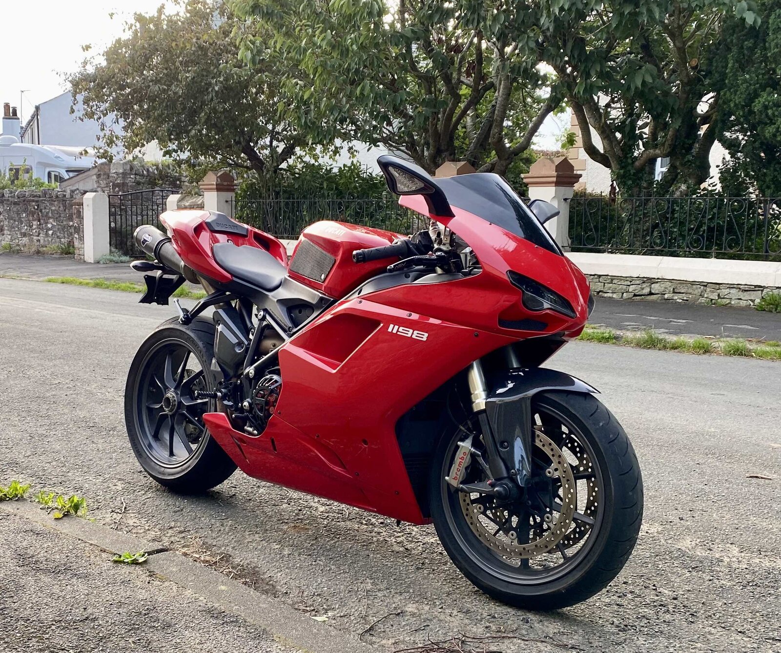

    We have just moved house and i haven't been out on mine for a few weeks up here in muddy rural Cumbria! It's been on a trickle charger and the mode shows Batt at 12.4 but when i try to start it i get nothing.
    Well the head lights go out, but there is literally no sound of the starter motor trying to turn over.
