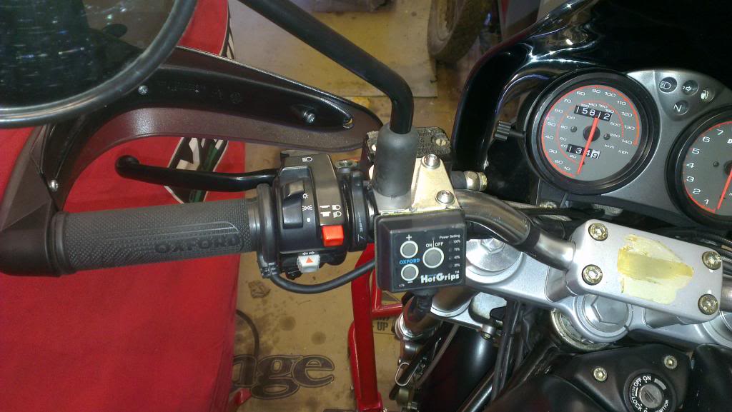

  5. Problem solved; let me introduce the Mk I Bracket:
  6. Nice one - identical controller to mine. I used a double sided pad on the rectangular panel that looks as if it has the remains of a sticker scraped off it.
    Are those hand guards universal?

  7. Yep, Acerbis, they replace the bar ends. The GF can wear summer gloves all year with the handguards and heated grips.
