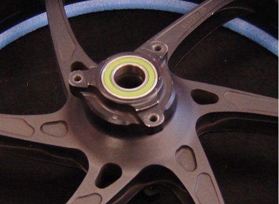

  1. Anyone fitted the 3 bolt OZ racing wheels to S or R forks?
    Just wondering what spacers you used or did you make them?

  4. Appreciate this is 2 years old but I’m trying to get the front to fit my 1299. Did you guys manage to get the wheel to fit?

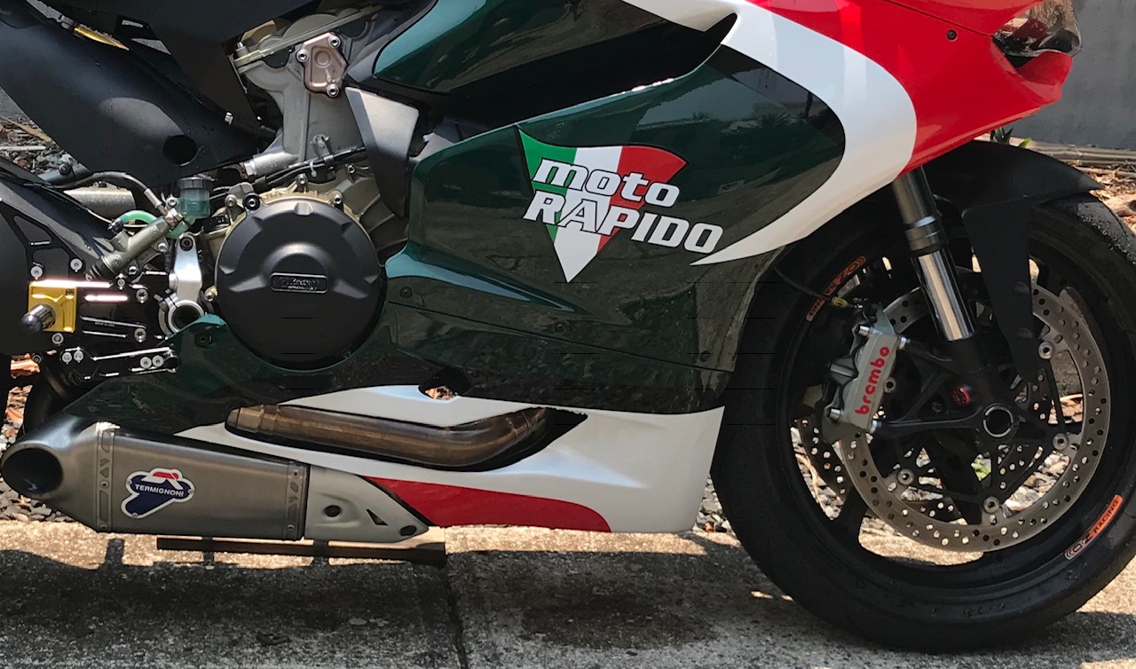

  5. It's the rotors that are the problem so need to be spaced, I used stock items and had an engineer make spacers and re drill the oem rotors.
    This is on my 899 but ran them mostly on the 1199 same fork width.
  6. Cheers. Figured I’ll have to do something similar. Just hoped someone had found a disc that just spotted on.
    thanks for the advice, at least it can be done. :upyeah:
