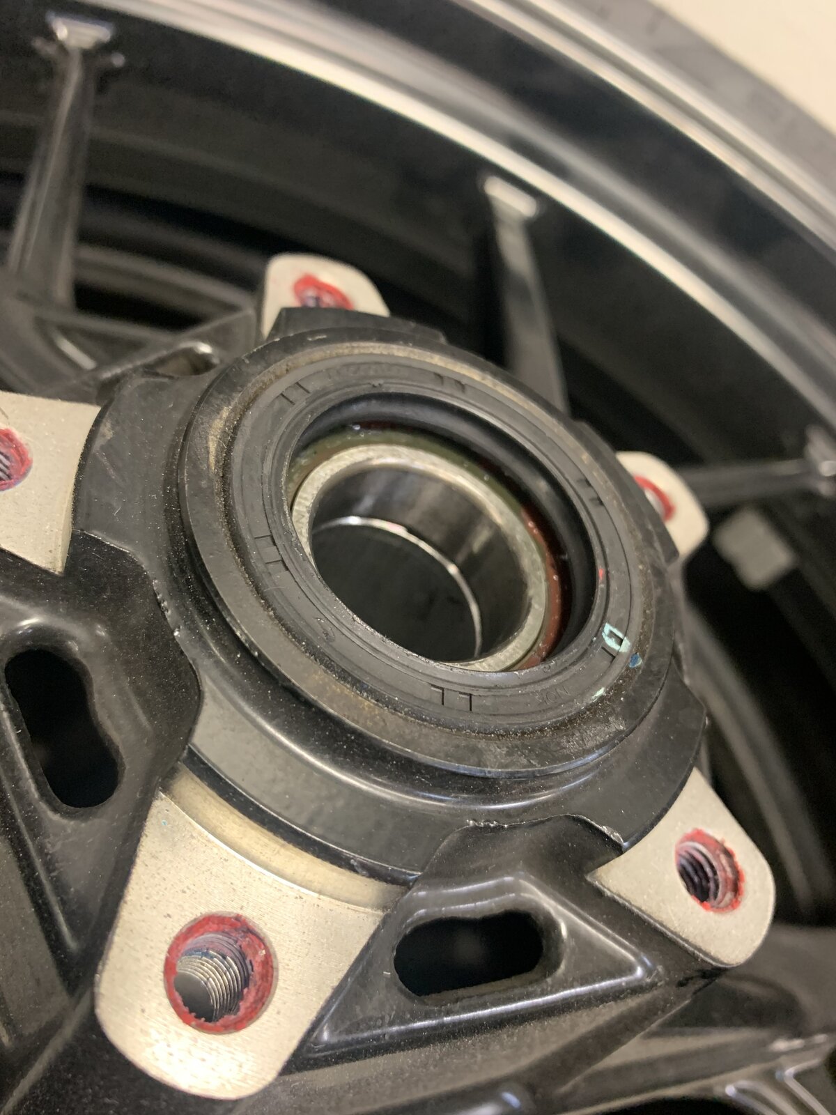

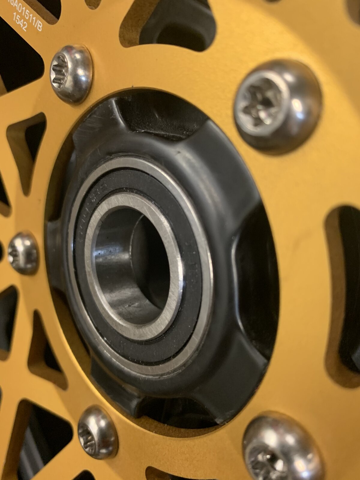

  1. Has anyone got a set of these on their V4?? I bought a set from a guy who had them on a 1299 after being told by several people in the trade that they're all the same and have a question about the front spacers; as in there is no way to secure them due to not having a dust seal to seat them in.
    Bearing face to bearing face is the same as my original wheels at 131mm so they will fit correctly but does that mean the spacerss must be left to "Float" while you install the wheel.
    Doesn't look to pretty either.
    Am I being extra or am I missing something, Mentally or on the wheels!?
    Thanks in adv.
    G.
