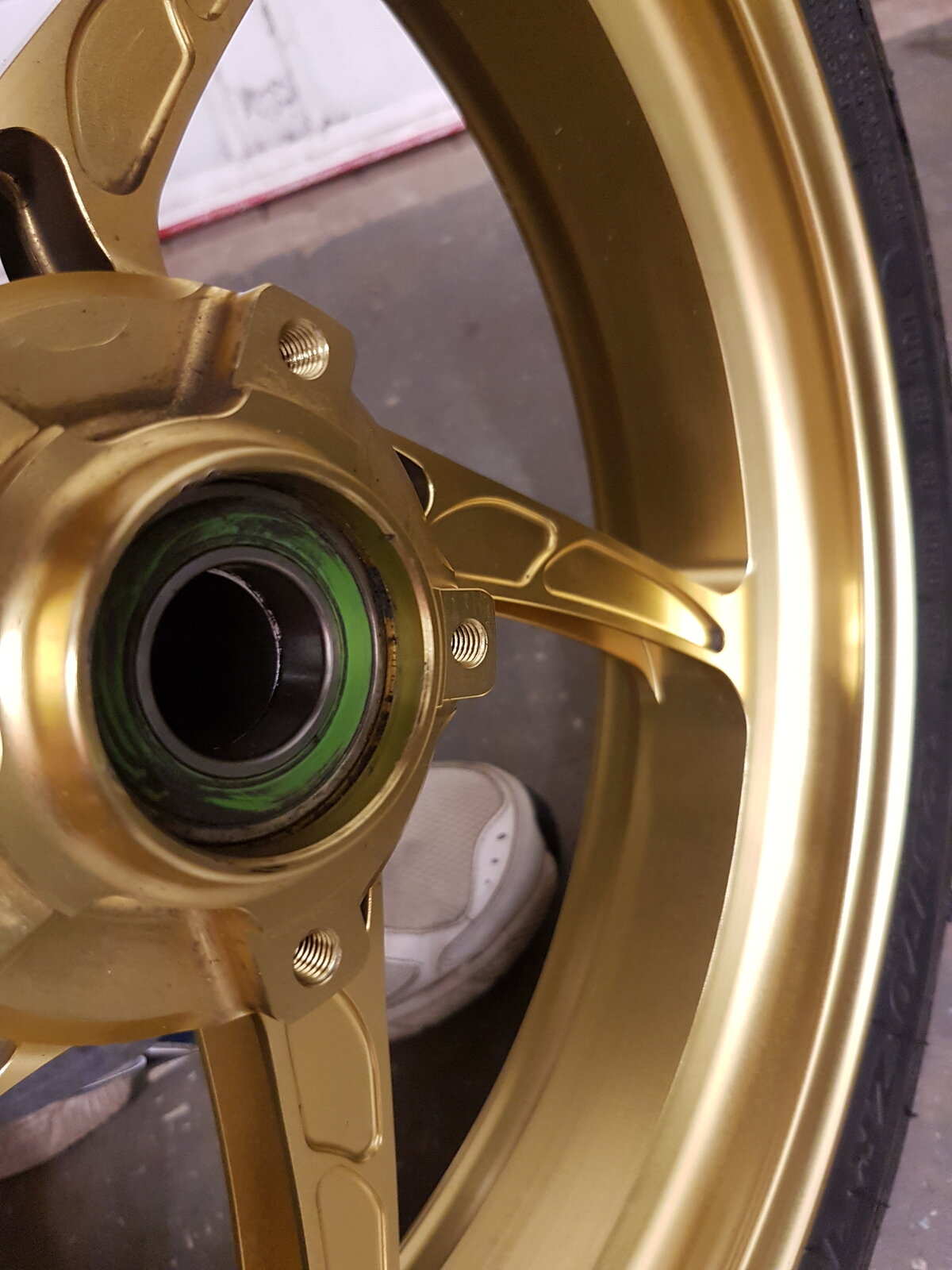

  1. Can anyone advise, how to remove the front wheel bearings from my panigales OZ racing front wheel.
    I've removed the dust seals, and one side had a large circlip, which I've removed.
    I can't see anyway of getting a drift onto the back of the bearings.
    Just fancied a colour change while I'm replacing the tyres.
    Pics below, thanks.

  15. The spacer should float up and down slightly, to give access to the back of the bearings.
  16. Nope, no movement.
    Spacer almost flush with the bearings, no chance of tapping from behind.
    Gonna need some kind of puller I think.
    Or I might just change the tyres and leave the wheels alone, if I can't borrow a puller.
    Cheers all.

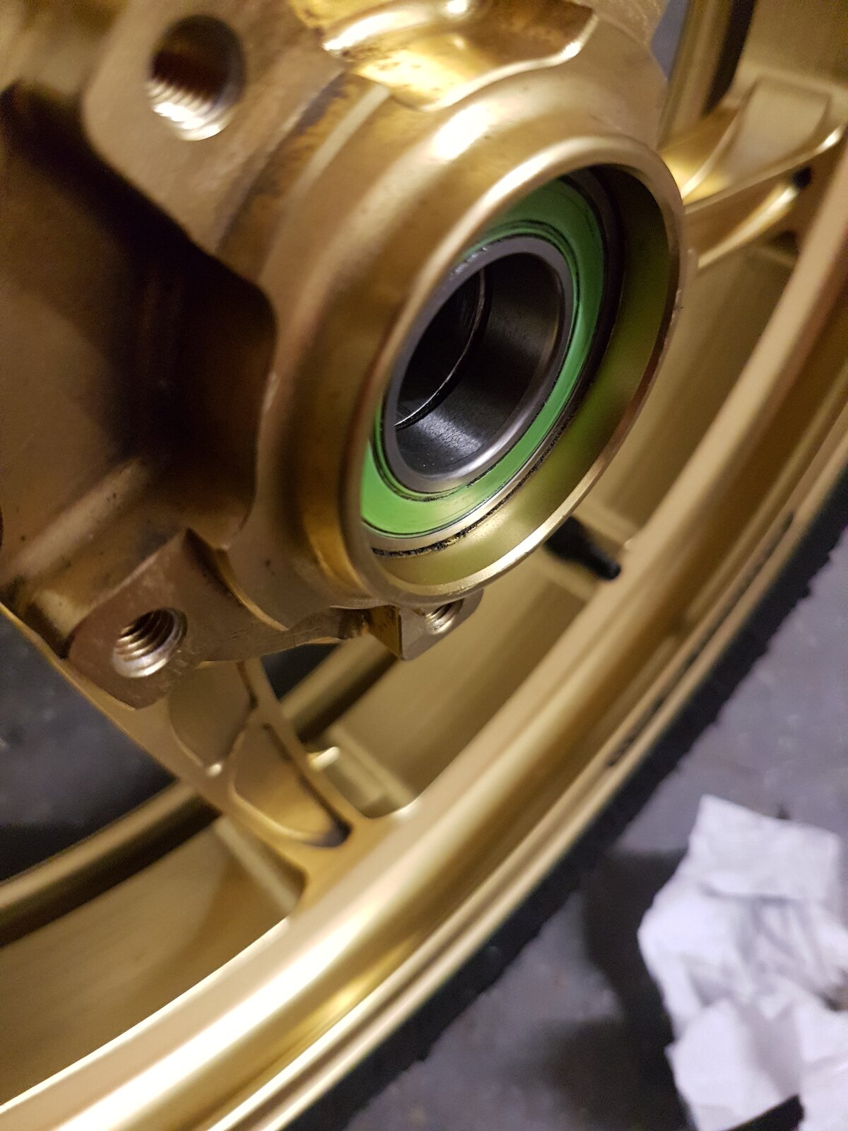

  18. If there was a circlip fitted. It may be possible to drift out both the bearings and spacer from one side, through to the circlip side. (If the bearing sits up to an outer shoulder on one side of the wheel)

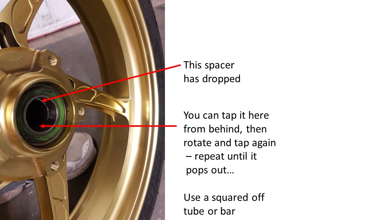

  19. Your picture 2 clearly shows the spacer has dropped allowing the bearing to be tapped out from behind...not as clear on this smaller picture but check your first post :eyes:

  20. I think it's the angle I've took the pic, it makes it look like that.
    I've been back in the garage, and the spacer is almost flush with the bearing.
    I've tried to tap the back with a drift, but can't get any purchase on it, it just slips out. (Not enough of a lip to hit)
    I will give it another go in morning.
