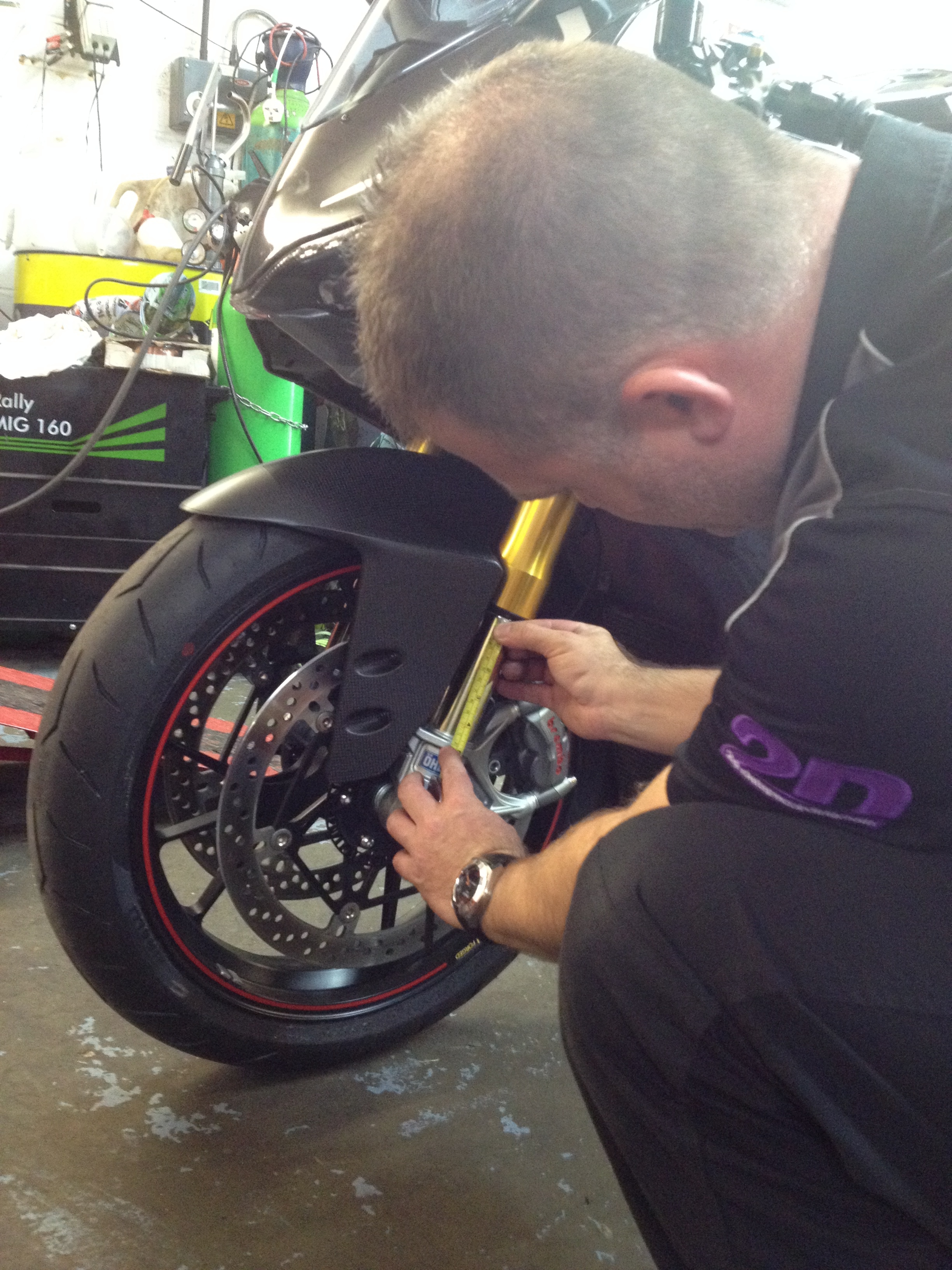

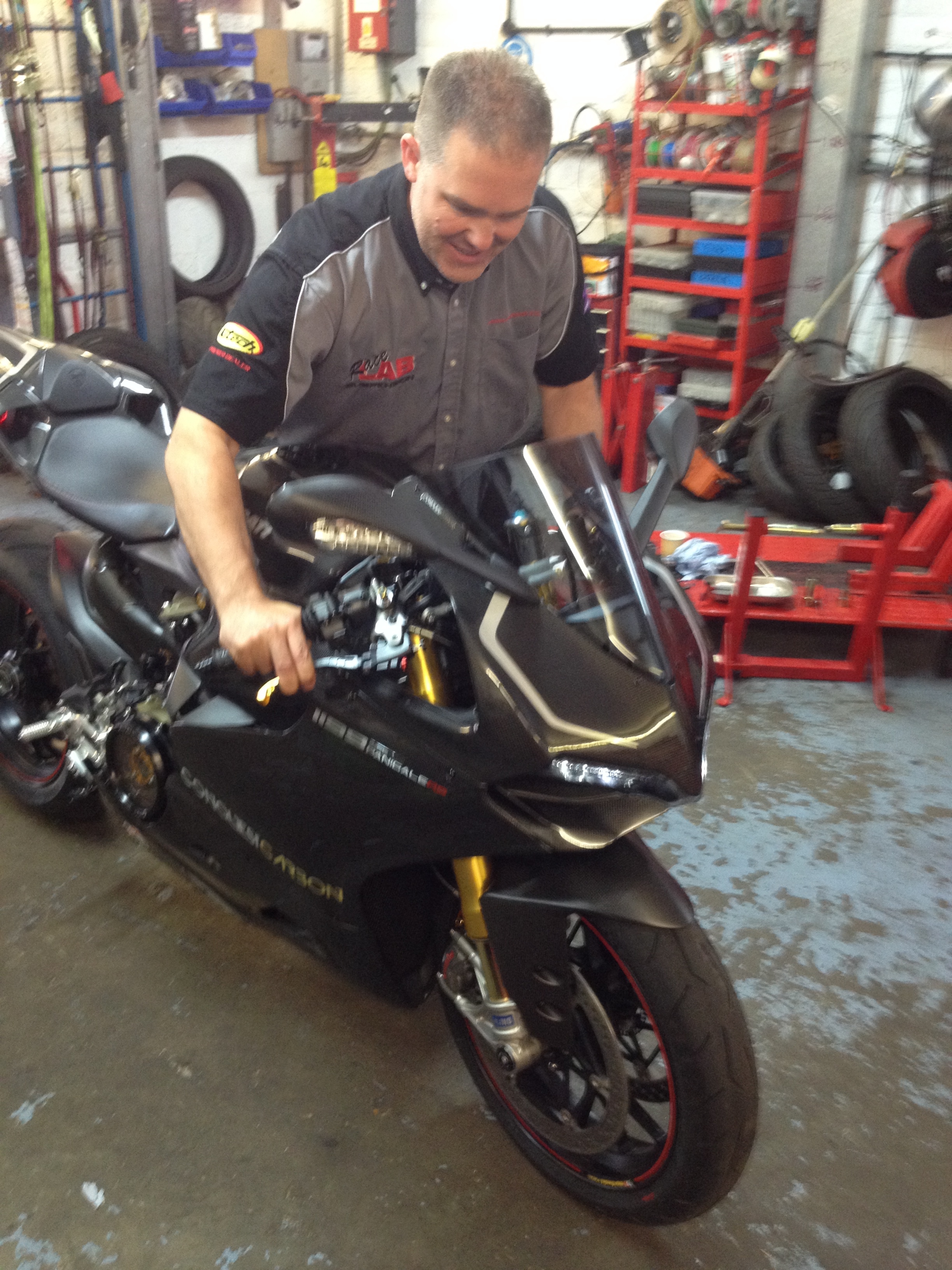

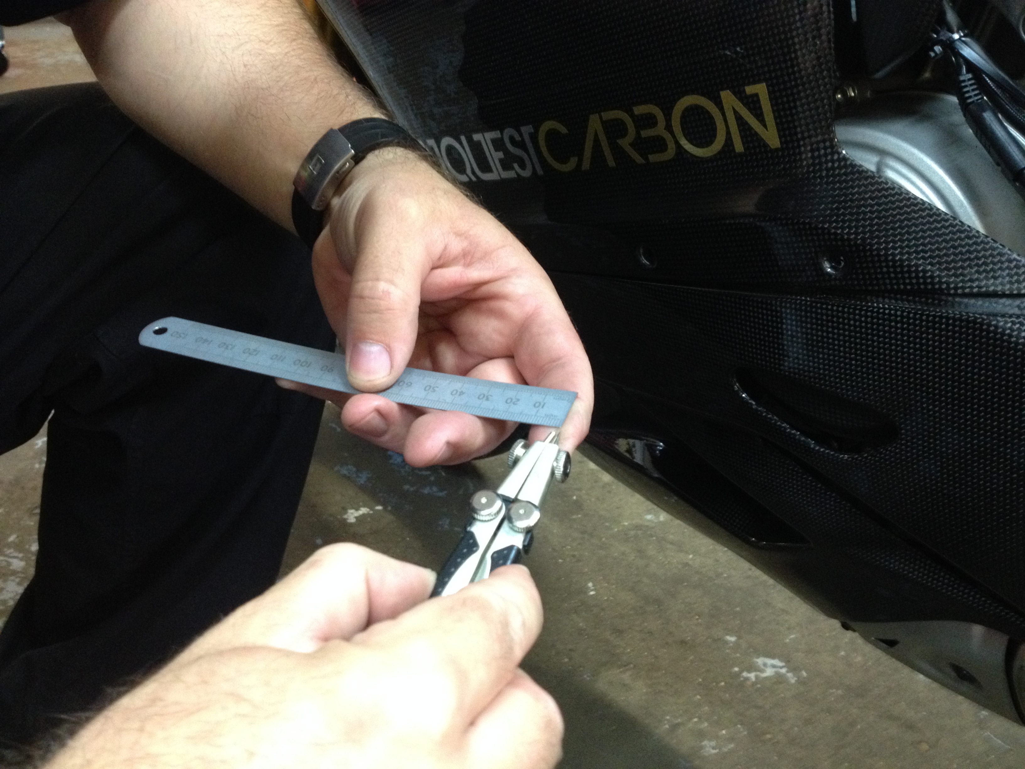

    I also had the suspension set up by a local specialist Race Lap based in Wimborne, the guy to speak to is Paul. For £99 he sets it up for your weight and riding style, it's made a massive difference.
  12. Brain Nicholson BN Race Science | Professional Road & Race Suspension Setup did mine. Cost me £60 4yrs ago on my 1198. Its been spot on. Just one click +rebound on front for track days. He does appointments at LJ Motorcycles in Twickenham.
    On my 916 HM did my forks for me as I bought them from them new and selected a rear ohlins spring for me. Both were also bang on the money.
