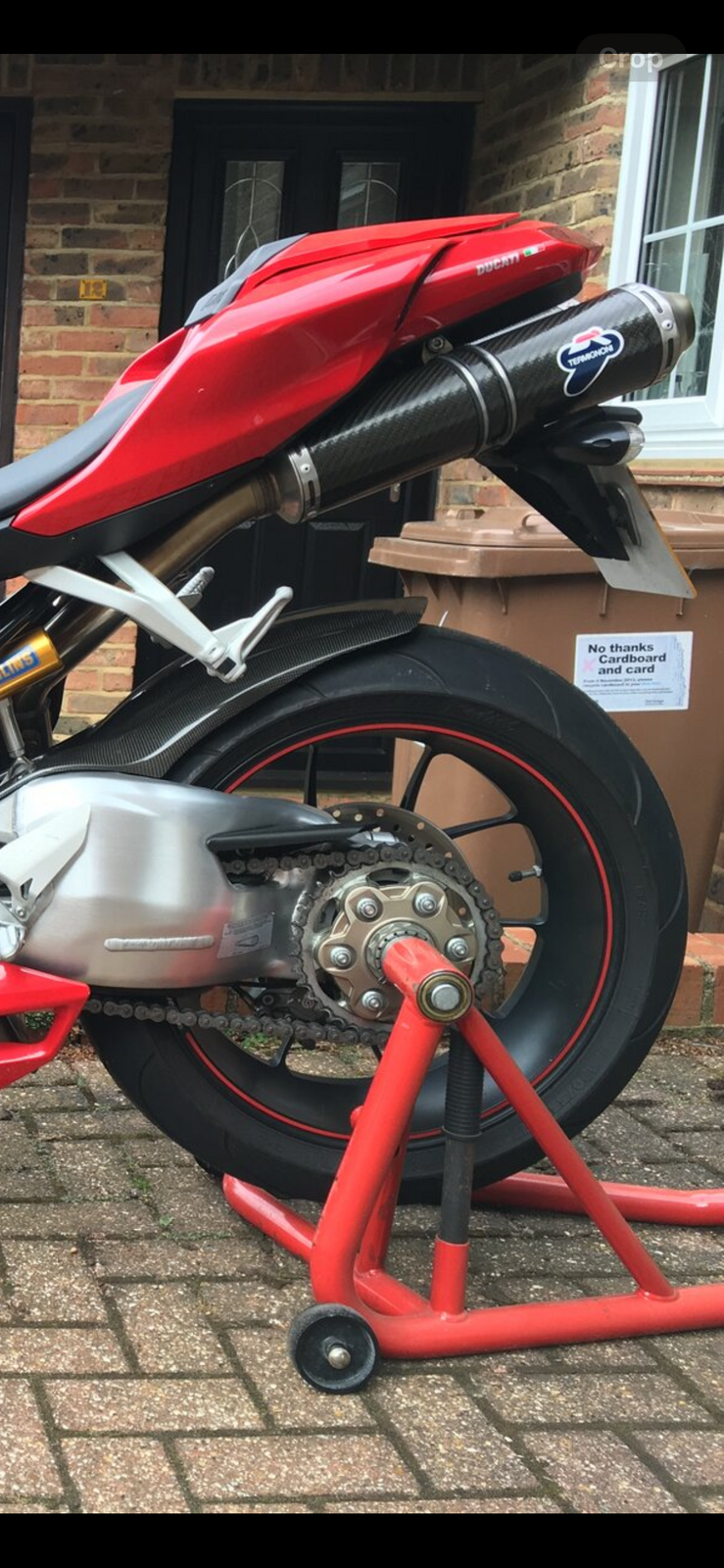

  1. IMG_4827.png Anyone know if there are adapters to allow the use of this paddock stand with the smaller hub bikes aka 998/748 etc. change that huge pin to a smaller one?
  2. I believe that one can buy a smaller pin assembly for DP/Gubellini stands.
    I do not know where from though.
  3. On my DP one the larger spindle unscrews and there is a small 748/998 version inside... Maybe I have a special one ;-)
  4. R&G Elevation stands can swap pins for small and large bore hubs.
  5. On mine the spindle is hollow so definitely nothing to unscrew to reveal a smaller one.
  6. The spindle should be held in by a large circlip on the outside of the stand. You can then remove the spindle. You may be lucky enough to get a small bore spindle off eBay. The R&G spindle has the same method of fastening with a circlip but I don’t know if the pin will fit that stand.
