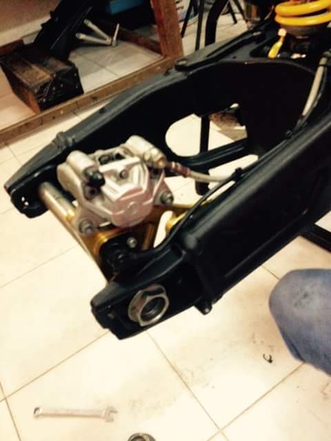

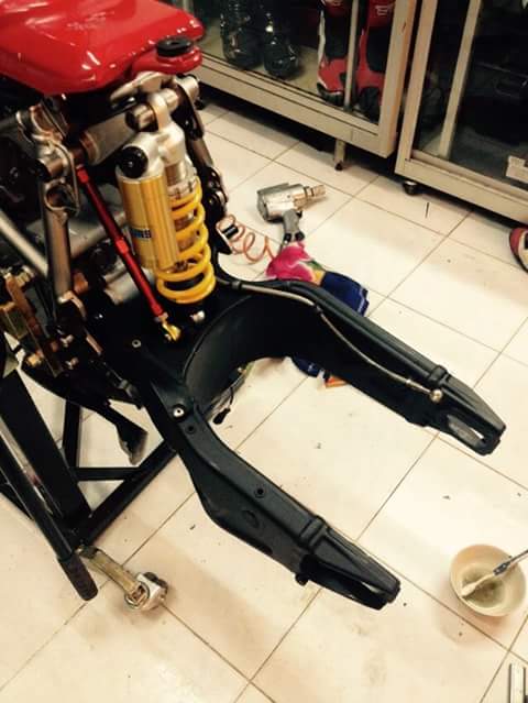

There's Currently a later black swinger on ebay,seriously thinking about upgrading ,can anyone tell me if its just a plain swap or are there complications....anybody done it?

Everything bolts in exactly the same including the brake caliper & bracket. You made need a new brake line, as my 999R swingarm came with a braided brake line, Depending on what exhaust system you have (I have a Termi 2-1-2 system), you may have a clearance issue. I had to modify the mid pipe to clear. If you have an asymetric system, then I have no idea if you will have an exhaust clearance issue or not.

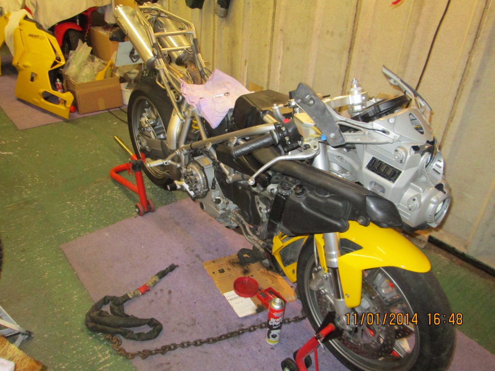

Mine sits happily on a couple of cheap stands I got off ebay, less than £20 each. The rear one has rubber blocks rather than cups. This is the only picture I have of my bike on stands. If you want, next time I`m in the garage, I`ll take a better picture.

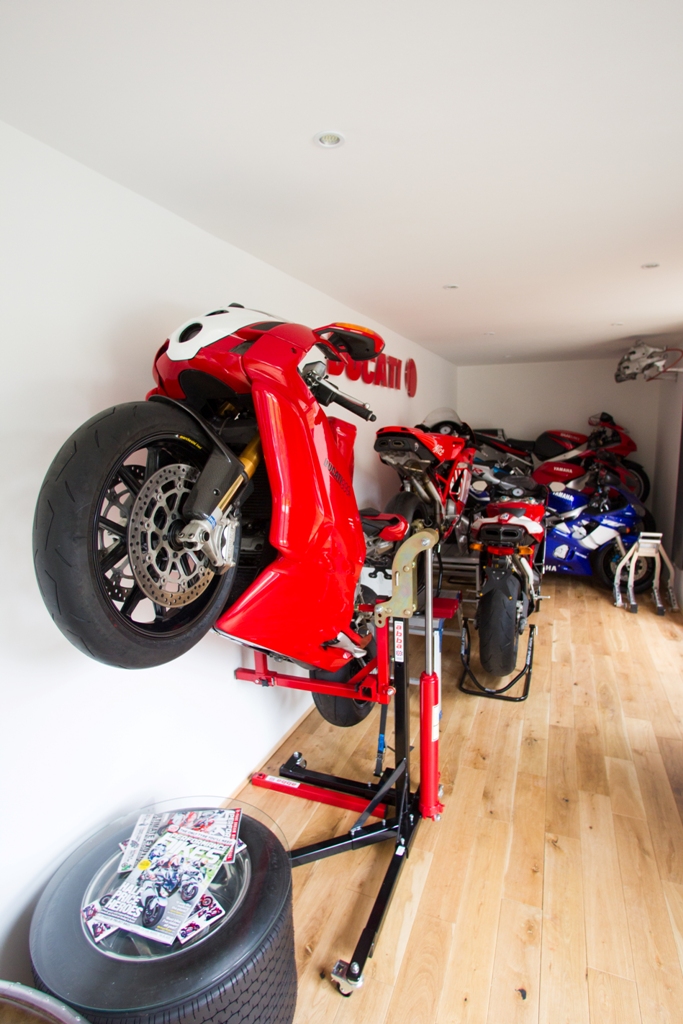

I now have two, this one and one to unwrap and I'm not rich :Facepalm: they are truly worth the money!
