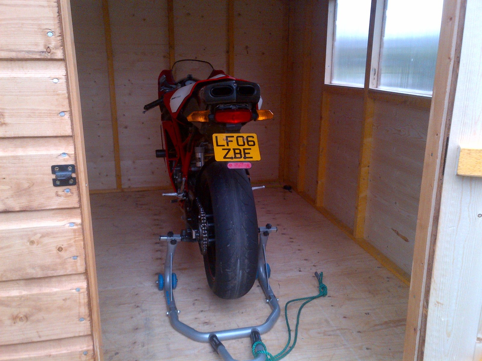

  8. Hi @Dave and @Cream_Revenge thanks for the info I have also looked at vids on you tube and there's an add on for wheels buts it's more expensive than the stand! Overall it looks pretty good and upgradable. I think your right regarding finding a paddock stand for both. This solution seems my best bet. The fairing issues is a problem I tried looking for the stand on my particular model to see if it has the same issues as the 996 but I couldn't find and thing so I'll contact the company. And I'll see how cheap a normal paddock stand is to compliment it as suggested.
    @cherod your bike has it's own house!?! There isn't even any tools in there! It's completely dedicated to your bike!!
