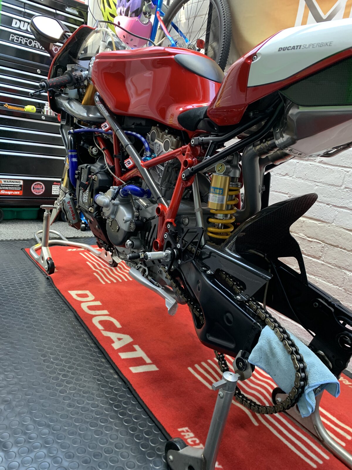

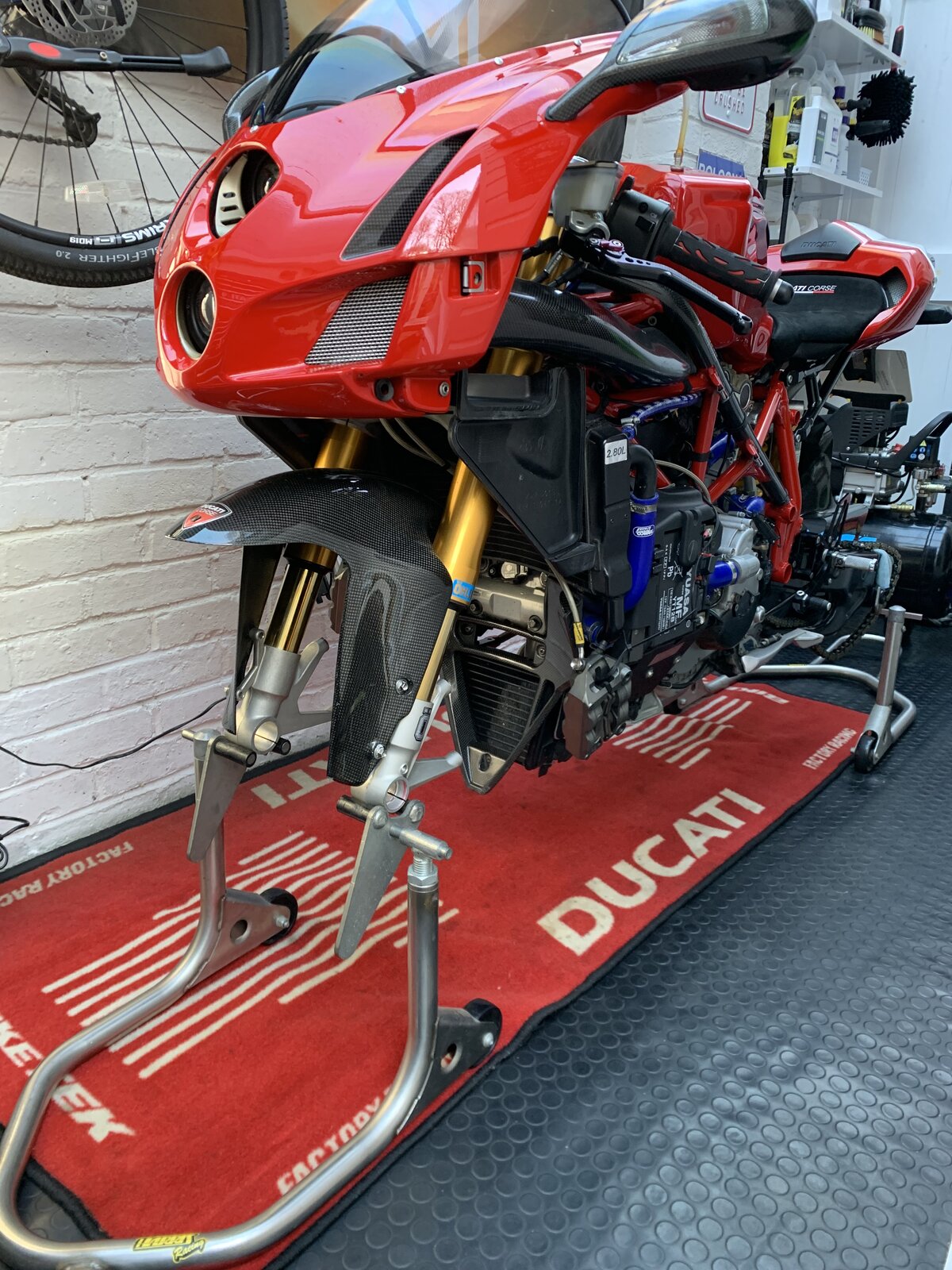

  11. +4 Harris again for me. Very handy this weekend when removing both rims.
  12. Nice bike , makes mine look a bit rough , ordered a rear stand and front to follow

  14. I have bobbins on the rear , nothing on the front
