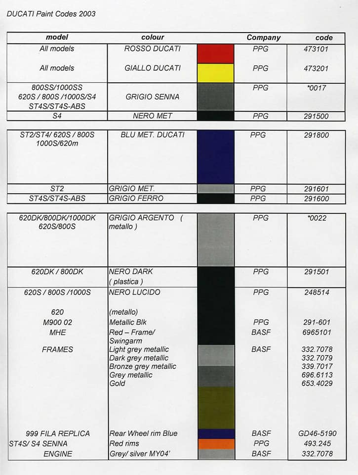

Hi all. I need to have a 1098s fairing repainted red. I know it’s anniversario red but does anyone know the code? TIA BJB

Thank you. I have a painter lined up and have come up with PPG code 473.101? Just want to confirm here with more knowledgeable people than myself. Thanks

I have come across these codes in the past, which may help, although they are not verified by Ducati, so far as I know: PAINT MANUFACTURER COLOR PAINT CODE PPG Metallic Black 291.500 PPG Ducati Red 473.101 PPG Ducati Yellow 473.201 PPG Metallic Grey 291.601 PPG Ducati Metallic Blue 291.800. Taken from the Ducati Store website. Also: Red (pre 98) 473.101 Anniversary Red (’99 on) 487.111 Yellow 473.201 Metallic Grey 653.6047 Steel Grey (Silver) 223.647 Metallic Blue 291.800. Also these: 1098S Ducati anniversary red, code. 473.101 (PPG); Transparent, code. 228.880 (PPG); red frame with gold wheels. 1098R Bayliss Pearl white, code. 490.019 (PPG) with Bayliss decals; Transparent, code. 228.880 (PPG); red frame with black wheels. 848 Pearl White "Bianco Perla" (PPG) *0040 (possibly known as ) 5VCKB "Trasparente" (PPG) 228.880 1198 Ducati anniversary red, code. 473.101 (PPG); Transparent, code. 228.880 (PPG); Racing Black frame, Graphite Grey wheels. Pearl white, code. 490.019 (PPG); Transparent, code. 228.880 (PPG); Racing Black frame, Graphite Grey wheels. 1198S Ducati anniversary red, code. 473.101 (PPG); Transparent, code. 228.880 (PPG); Bronze frame and wheels. Midnight black, code 928 D413 (PAL); Transparent, code. 228.880 (PPG); Bronze frame and wheels. GT1000 Silver code 928D151 (PAL); Metallic light grey code *0026 (PPG); Clear lacquer 228.880 (PPG); Black frame, chrome wheel rims. Ducati 248.514 (PPG) shiny black with white stripe; Transparent, 228.880 (PPG); Black frame, chromed wheels M696 Ducati anniversary red, code F_473.101 (PPG); Gloss black code248.514 (PPG); transparent, code. 228.880 (PPG); red frame with black wheels. Matt black code291.501 (PPG); black frame and wheels. Pearl white code490.019 (PPG); transparent, code. 228.880 (PPG); black frame; black wheels. HM 1100 Ducati Anniversary red F_473.101 (PPG); Lens 228.880 (PPG); Red frame and black rims. Pearl white undercoat 490.019 (PPG) + enamel *0040 (PPG); Lens 228.880 (PPG); Red frame and black rims. HM 1100S Ducati Anniversary red F_473.101 (PPG); Lens 228.880 (PPG); Red frame and black rims. Ducati bright black 248.514 (PPG); Lens 228.880 (PPG); black frame and rims. A check with the RS Bike Paint Website may also help: https://www.rsbikepaint.com//en-gb/colours.php#makeid=46 . Also this thread from here: https://www.ducatiforum.co.uk/threads/paint-codes-please.24977/ Hope it helps, Tom.
