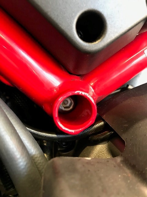

    Now the bike has been repaired and i am due to collect it next week so haven't had a chance to inspect it. I only have a photo to go from.
    The dealer has been very supportive so far, so this post is mainly to ask what to look for and questions to ask etc.
    To be honest i am hoping it will be as good as factory standard, as it should be on a brand new bike.
    Bottom picture is the repaired frame.

  4. Very much looks like it’s been painted over rust, I would question the dealer whether this was taken back to clean metal before painting.

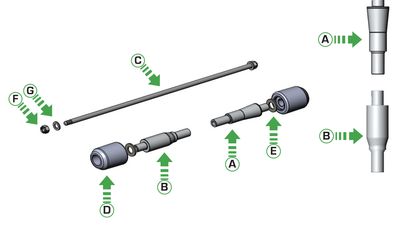

  11. I can't look at my bike at the moment, it's in the dealers, I cannot remember when fitting they touched the exterior of the frame, just looked at the Evotech website and fitting instructions for these parts, it would be possible to try fit them the wrong way round E38EE803-237A-4C39-A979-2A9FBEC18C8B.png
  12. Can you tell me if part A fits on left or right please. Thank you
  13. This looks like part A, but fitted to left side
  14. :( That 'final' paint repair doesn't look that well done to me, even with a pretty basic photograph like that.

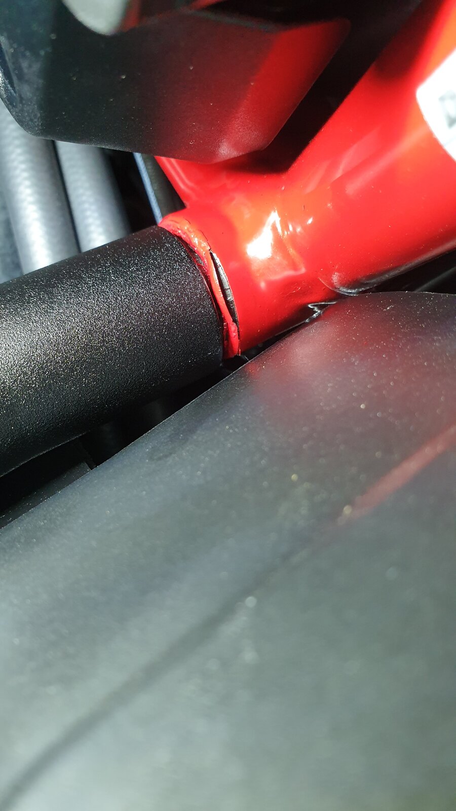

  16. What colour should it be underneath?

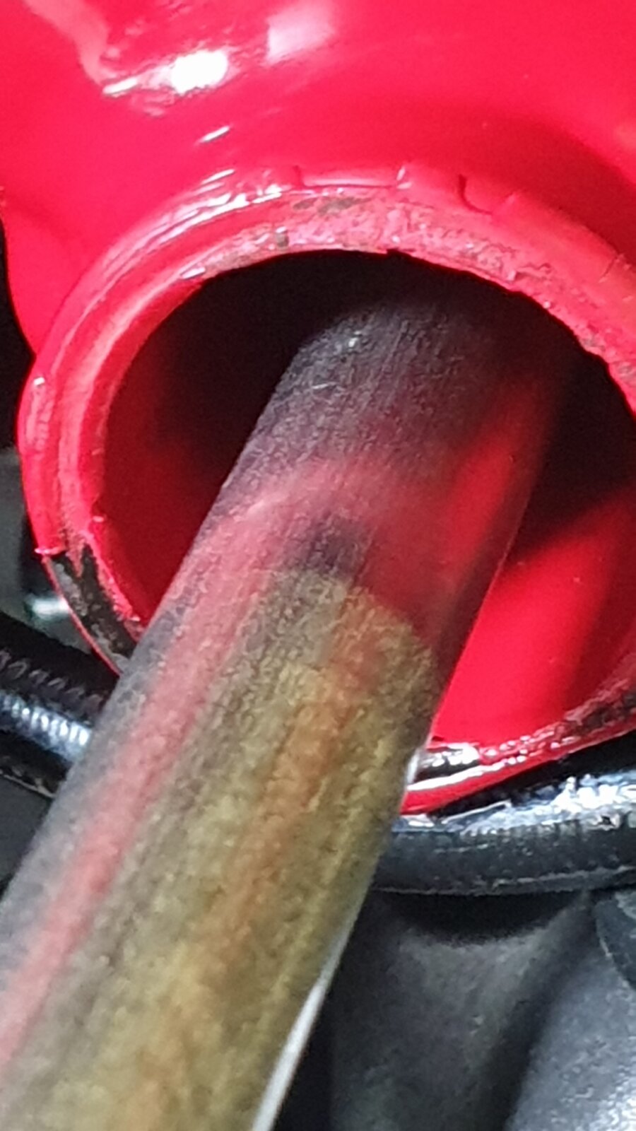

  17. This is what the frame looked like with the paint peeled back
  18. I think looking at that photo, the frame protector is just proud of the frame, I also think as the slider has been fitted, its come into contact with already blistered paint inside where the frame protector goes in, thus lifting it!!

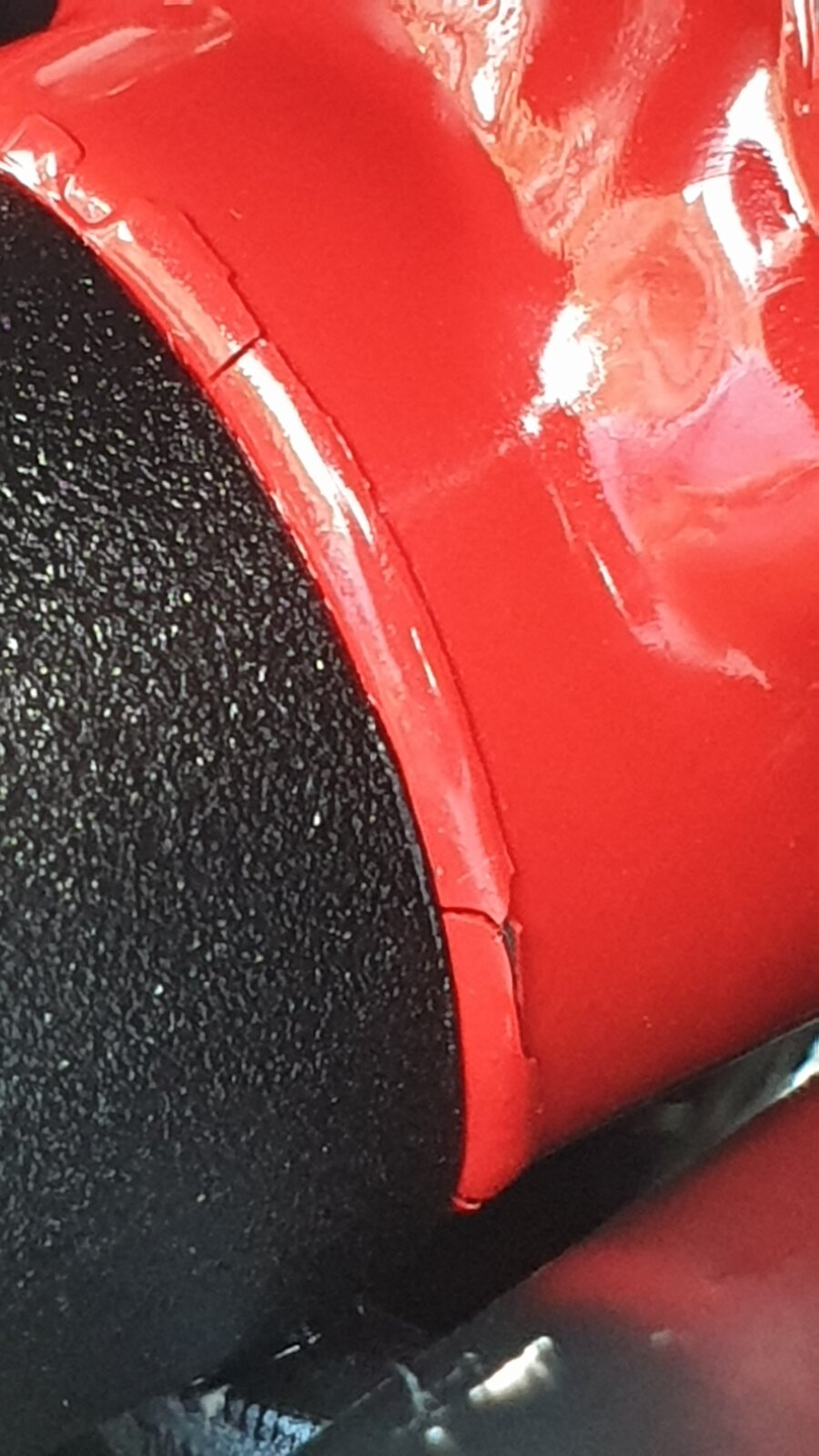

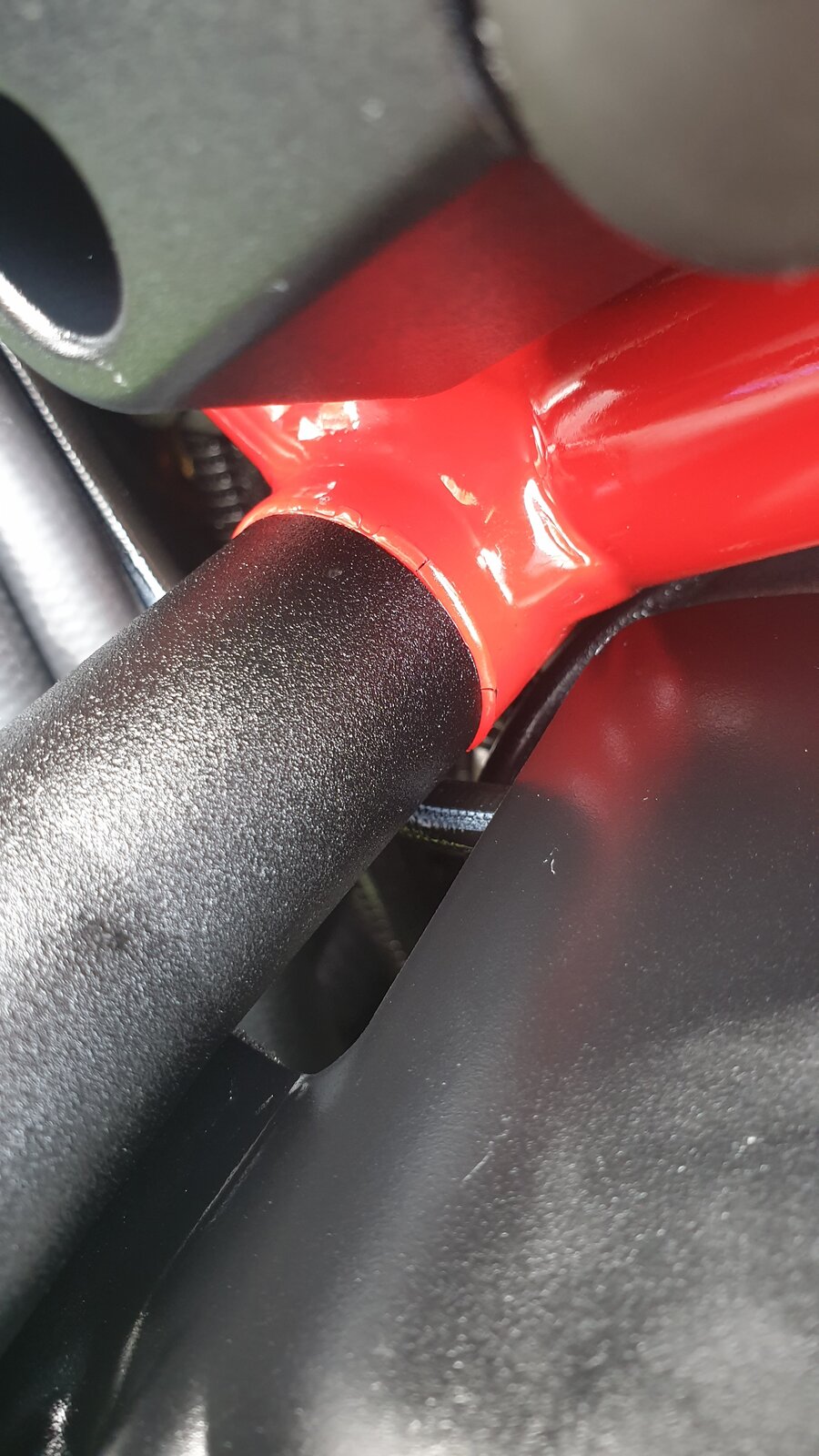

  19. This was after spacers had been added to keep it away from the frame.
