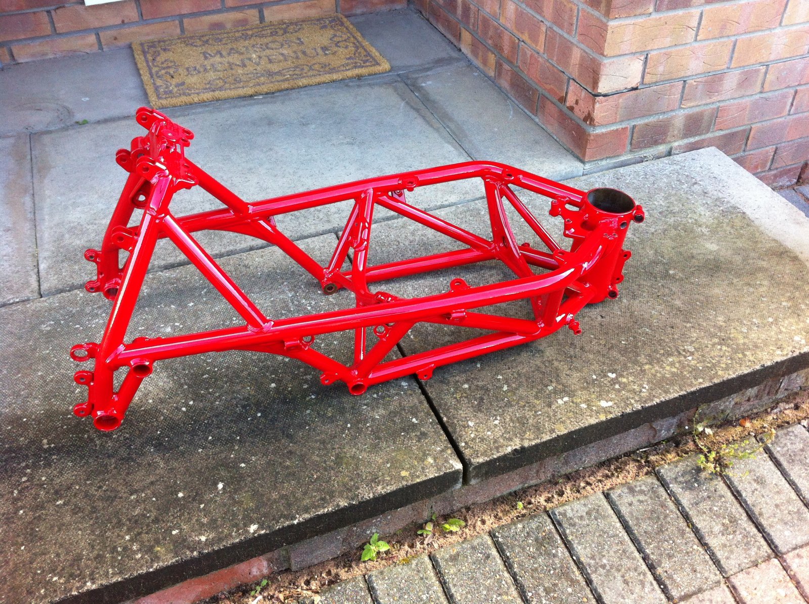

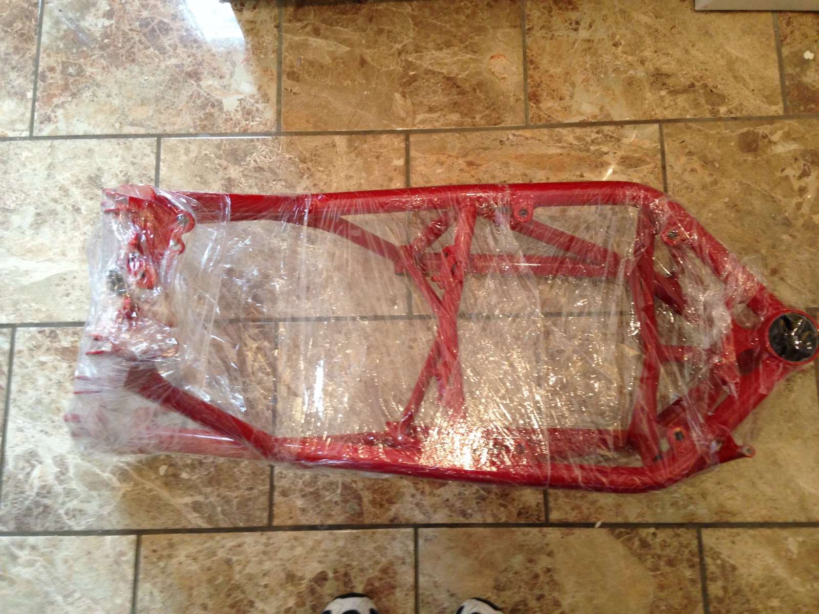

  10. What colour are you considering?
    Steve TPCS does a nice red that is as good as it gets with PC.

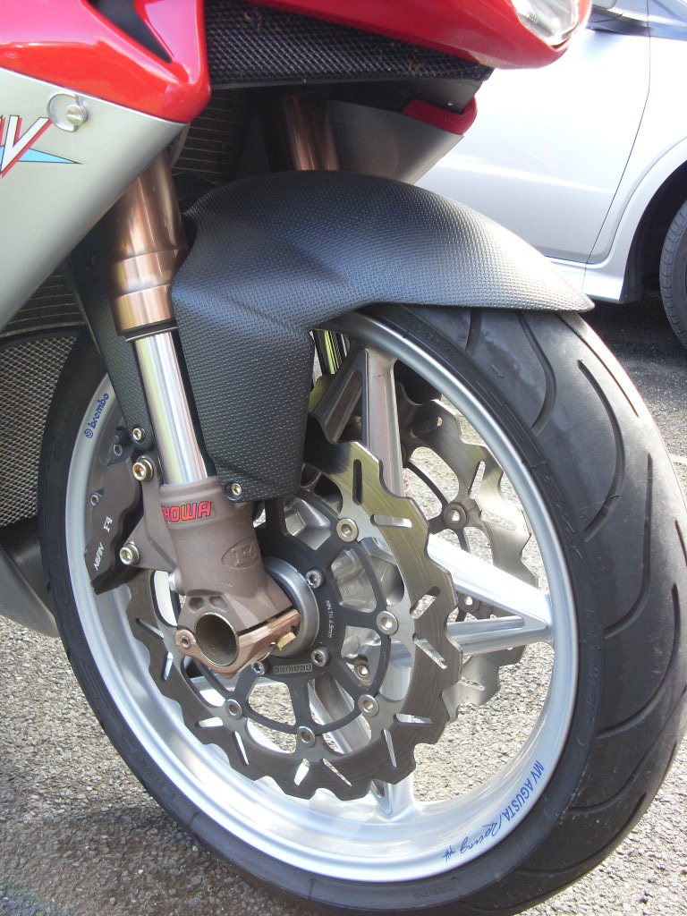

    I have a scratch on the frame of my 1098R, close to the LH footpeg. I'm confident I can get a match and spot repair it. Powder coat would leave me snookered.
    I've had my MV Agusta F4 wheels powder coated in the past and been perfectly happy with them.
