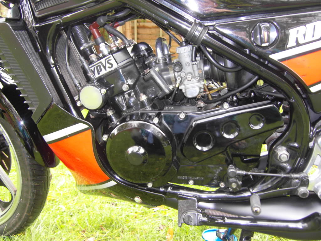

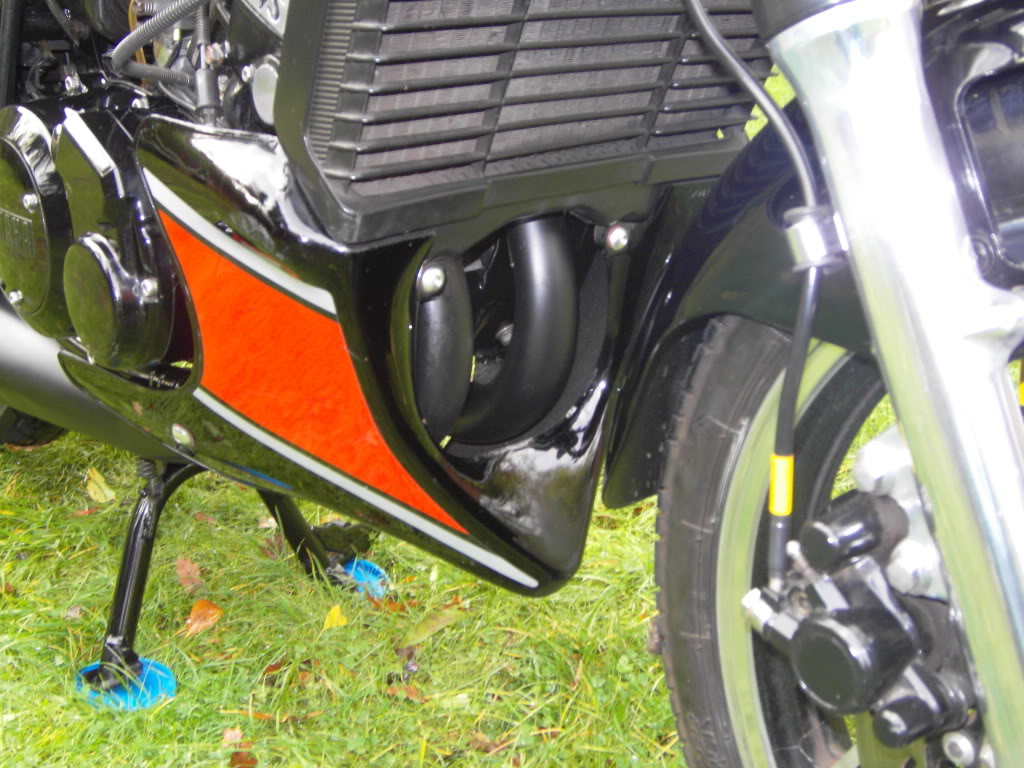

  6. PJ1 is great always used it on my 350 ypvs, 350lc head, barrels and exhaust, i sprayed my spare lc heads with it at xmas gave me something to do :)

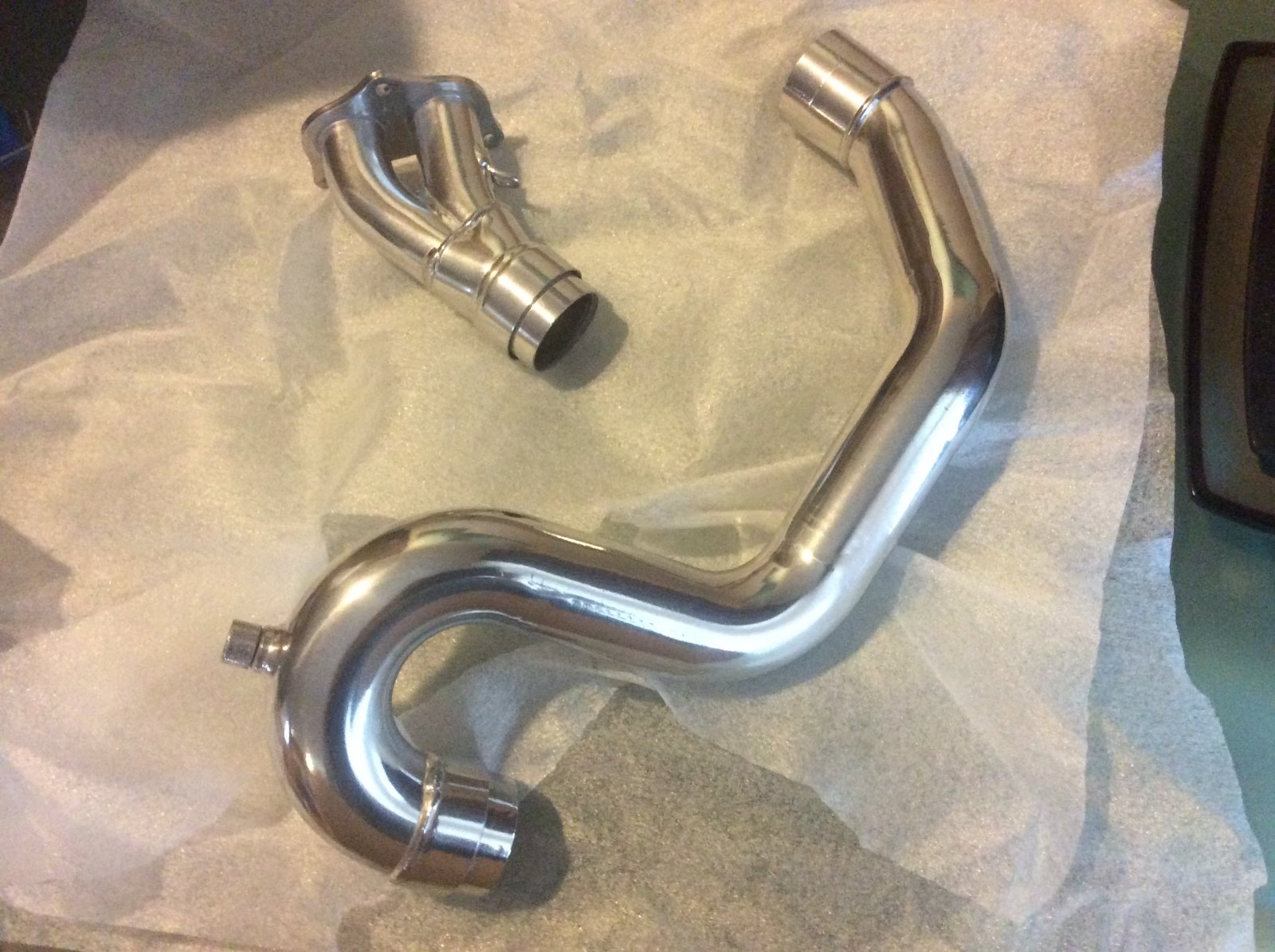

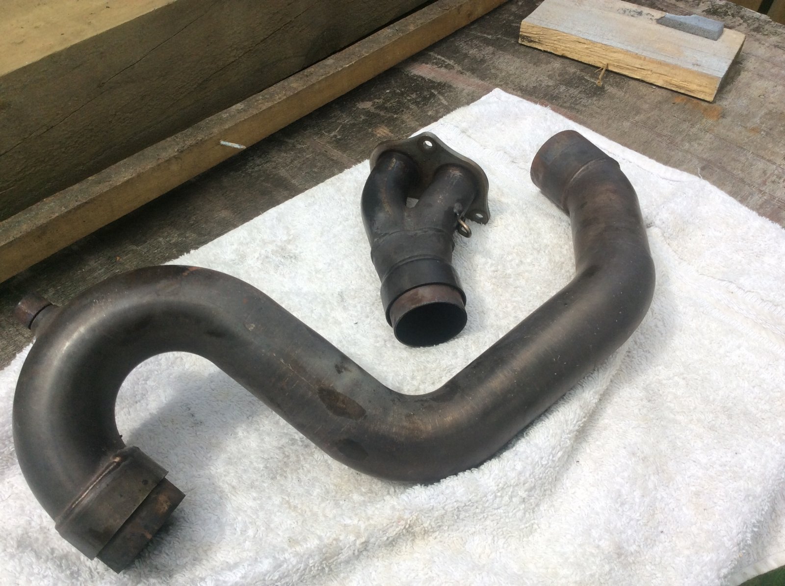

  8. I've just had these Hyper coated,good for temps up to 700'C
    $116 nz about 50 quid.including postage.Garanteed for three years,so no more hand polishing with wet and dry paper.
