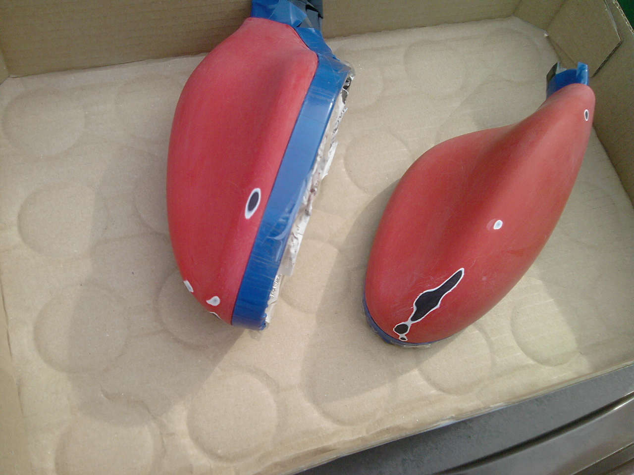

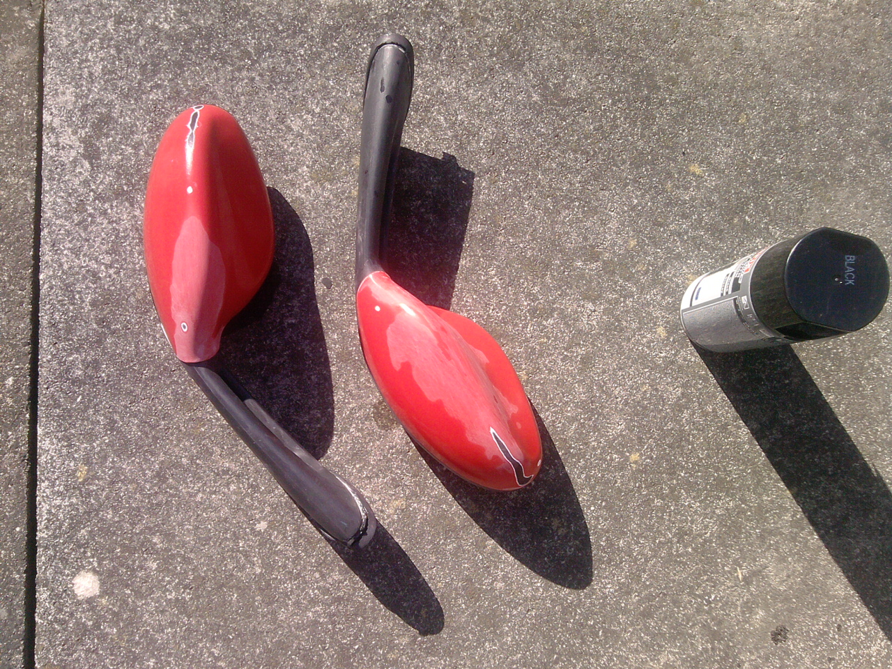

Thanks for all the advice folks. I've got two minor paint jobs on . Brake reservoir cap and clutch lever .... gloss black , no masking needed . Paint is from a hardware store , and claims to be for iron gates etc . It's on a fourth coat and looking good so far .... Second job is a pair of red mirrors with some scratches on the paint , and I don't want them red anyway , so I'm aiming at matt black ..... ..... with maybe a lacquer coat later , if I don't like the finish . I found a roll of decorators masking tape ( paper ) and chucked that as useless, then I came across an old multi-pack of coloured electrical tape ( pvc ) It had lost most of its sticky .... I tested a patch for residue and it came off clean. Since reading the advice here , I found this , Harris Automotive Masking Tape (24mmx25m) £3.79 pale blue coloured and looks to be paper based ... is that what you mean ? The thing is ..... I get yelled at for even thinking about going outdoors .... but I'll put that to the test later , by saying that there's no chocolate or ice-cream in the house .... Hmm ! Couldn't agree more on that point ! Here are some "before" pics .... and yes , there is still more surface prep needed ! I might take some "after" pics , and place them on top of bins , which should distract attention ..... ....... if they are truly gruesome to behold .... Ha !

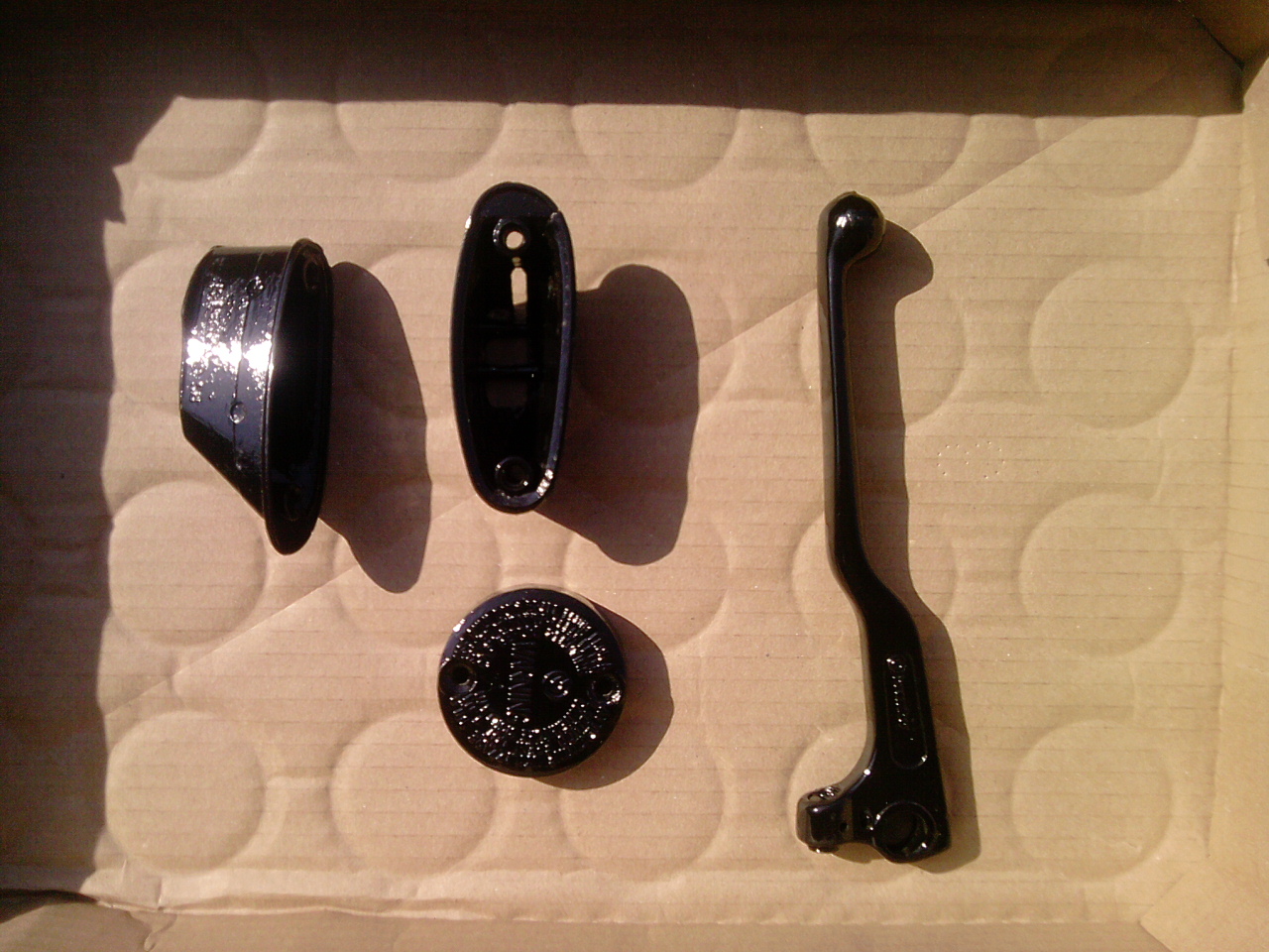

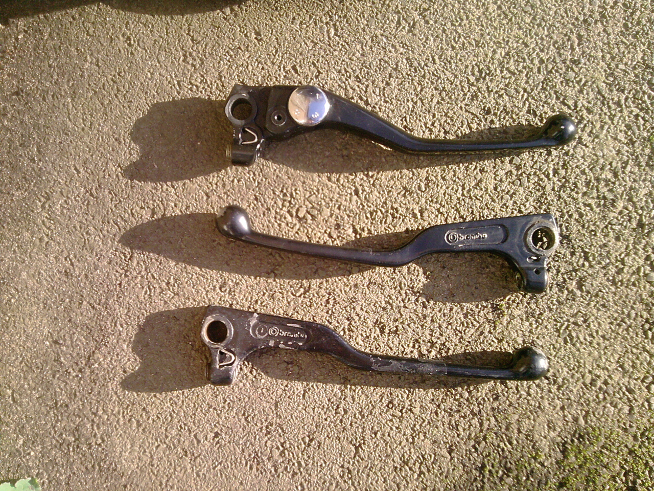

Metal parts are done , but the only " before" pics that I've got don't show the sides with the flaking paint ... Doh ! My photos are crap , as usual .... but I'm available for weddings .... BTW - that adjustable lever in the pic is not needed , if anyone has a use for it " After " I'm coming to realize that my problems with paintwork ( and the same for woodwork ) are actually patience problems . But things are very different now ....

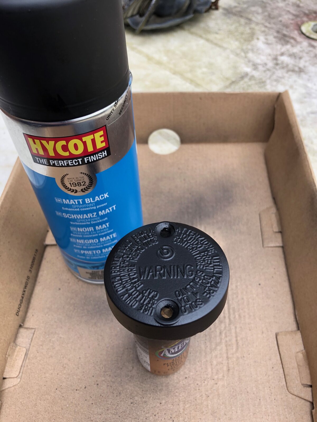

If you use satin black on metal its childs play. Normally only needs one coat and looks great. I did the brake reservoir cap on my project last week - one coat onto bare metal and it looks great, lasts a fair while too: EDIT - P.S. Is that a baked beans tin tray you have used? Got any spare beans???
Damnation ..... There aren't half some sharp-eyed folks around these days ... ... how did you spot the beans , just from the tray ? Don't you know the Commandments ? " Thou Shalt Not Covet Another Man's Beans " -
