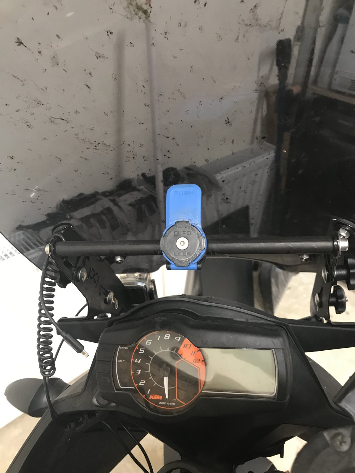

  4. I’m using the Palmer screen & accessory bar on another bike (KTM).
    They do good stuff and have quite a reputation on the KTM forum, for good screens.

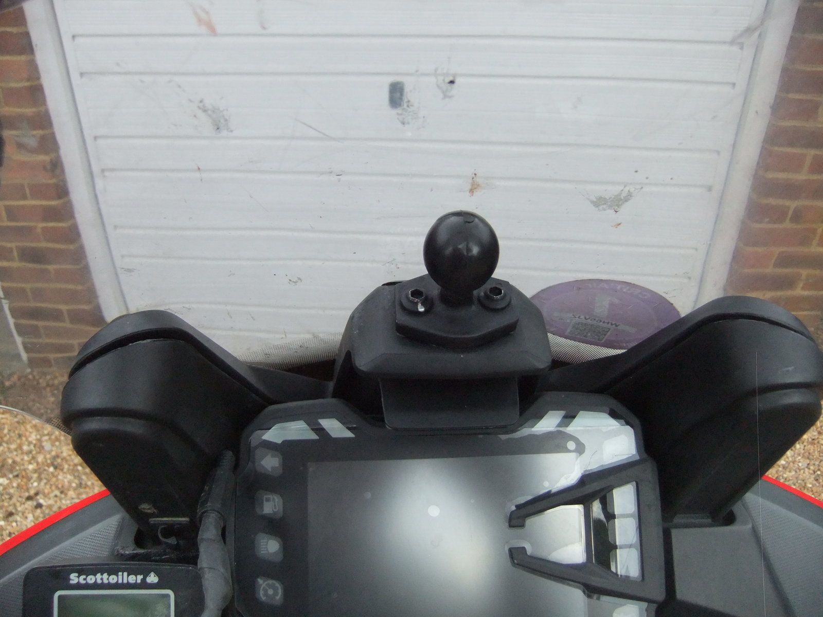

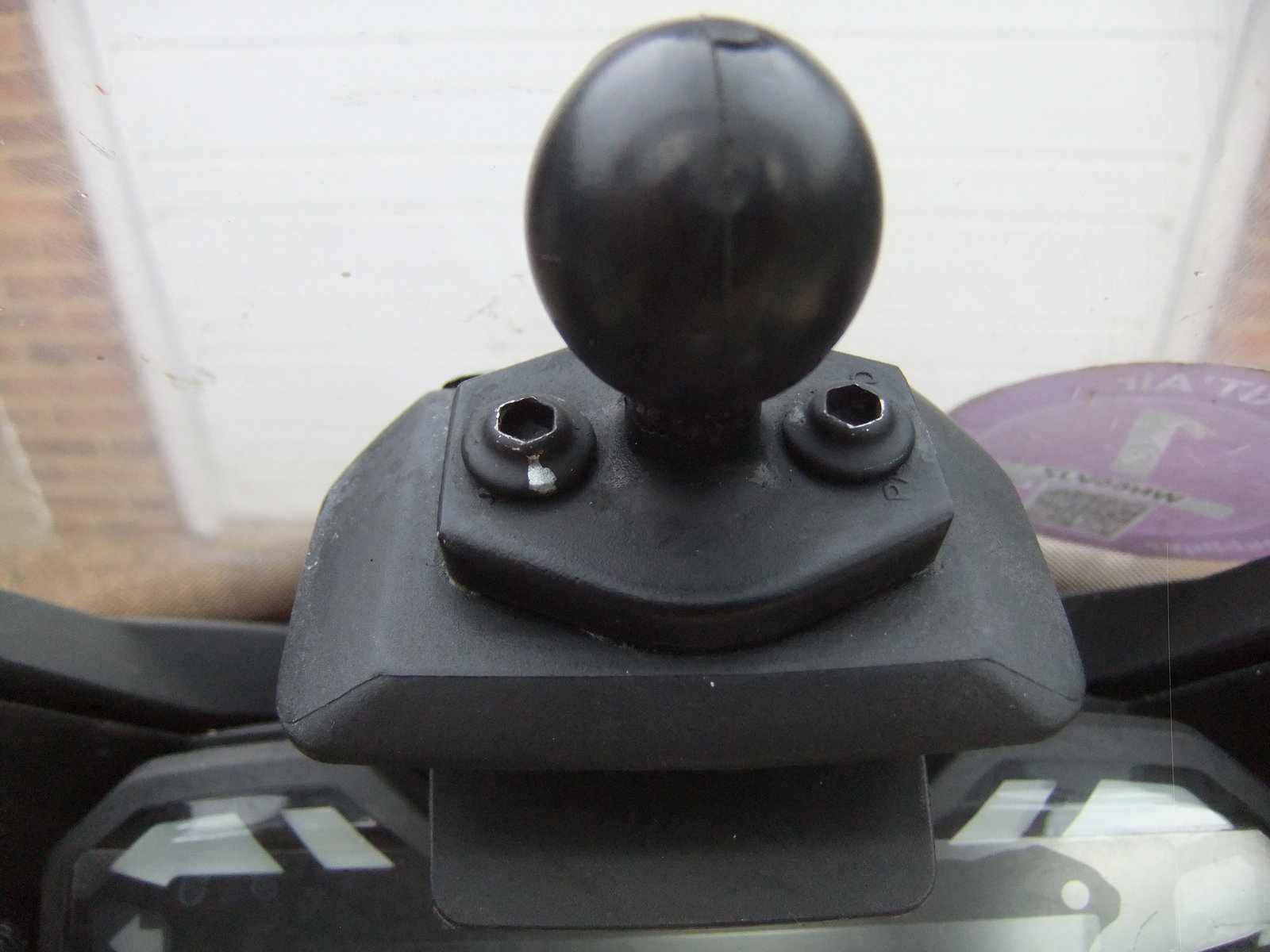

  8. Here's an alternative, cheap, easy, and readily available.
    Get one of these - Diamond Ball Base 1" RAM-B-238U , drill two matching holes into the top of the screen adjuster and bolt it on. Use dome headed bolts from beneath which gives sufficient clearance to operate the adjuster.
    Then get a RAM double socket extension and connect to the GPS backing plate.

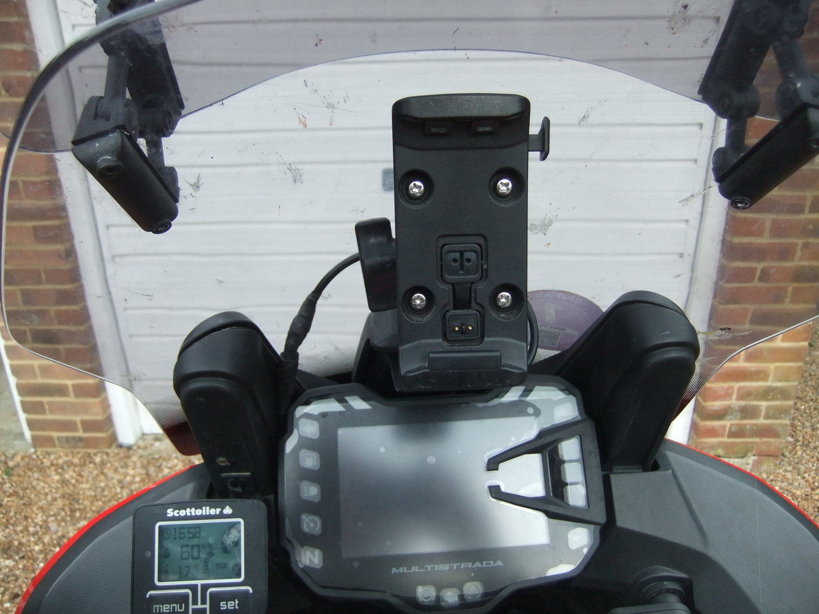

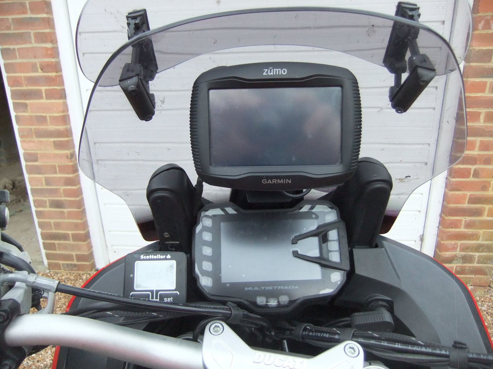

  13. Tony, just for you I photoed my RAM mount set-up. I trimmed the diamond base plate to suit the width of the screen adjuster. It was 2 years ago so I can't remember exactly, but it looks like I drilled a couple of new holes through the base, again to suit the adjuster, as the original holes were lost when I trimmed the base. As you can see, no need to put the bolts on from underneath as they clear the mechanism and it all works.
  14. That looks like a great idea. I may change to that myself. I currently have the Ducati high mount and there is quite a bit of movement. I am guessing that your method has less?
  15. I'm not familiar with your Ducati mount as I've used this set-up on my last two Multis. There is a little movement but nothing much. Certainly nothing that makes it hard to read the GPS.
  16. Cheers:upyeah: I think I may be getting the drill out!
  17. I have the Palmer products screen spacer and accessory bar with an MRA screen and a Zumo 590 in a touratech locking mount. It's the only mount that doesn't allow the zumo to bounce around on the move. I tried the Ducati one but this set up is just too heavy for it, it bounced about so much I was worried it would break the mount. I'm sure the Ducati one would be ok for a 390 but I can recommend the Palmer mount for a bigger unit.
