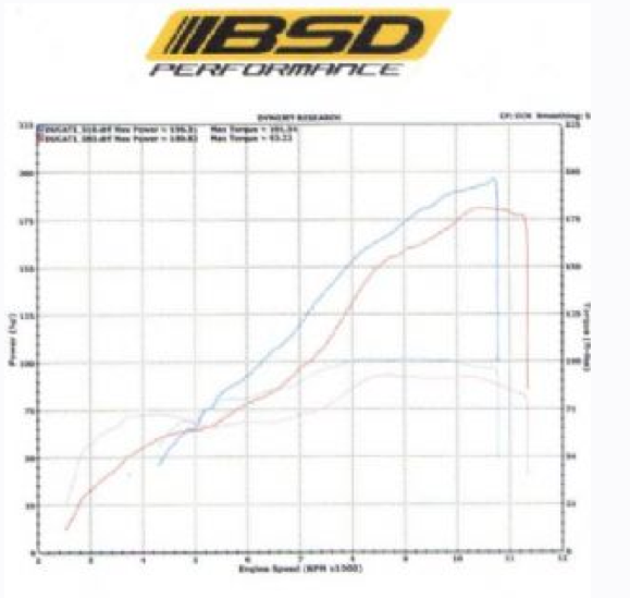

  5. hmmm lies damm lies and statistics....
    heres a pani with termis versus a well know race bike to the site ...........pick a number!!
  6. Cannot read it, it's blurred.
    Also the enigma of the 'well known race bike ' is killing me, go on, give us more info.
  7. the red line is a panigale with termis, the blue line is a 1098R engined race bike. you can see the difference and where the 200 and 175 marks are plus the torque peaking around the 100 on the 1098r and under on the panigale
    the dyno is mark at BSD peterboro......
  8. it's hard to compare dyno's...
    but apart from where the lines are on the scale, the curves on my chart are way smoother than the BSD tested bike..
    and at 10-10,5K there almost the same.. whereas BSD's cuts of, the other one goes on..
    and the torque curve remains steadier throughout...
    the owner of that pani also has a hyper well prepared 1098R and affirms that the pani has one hell of a job at it's hand to beat the 1098 ... but eventually will...
