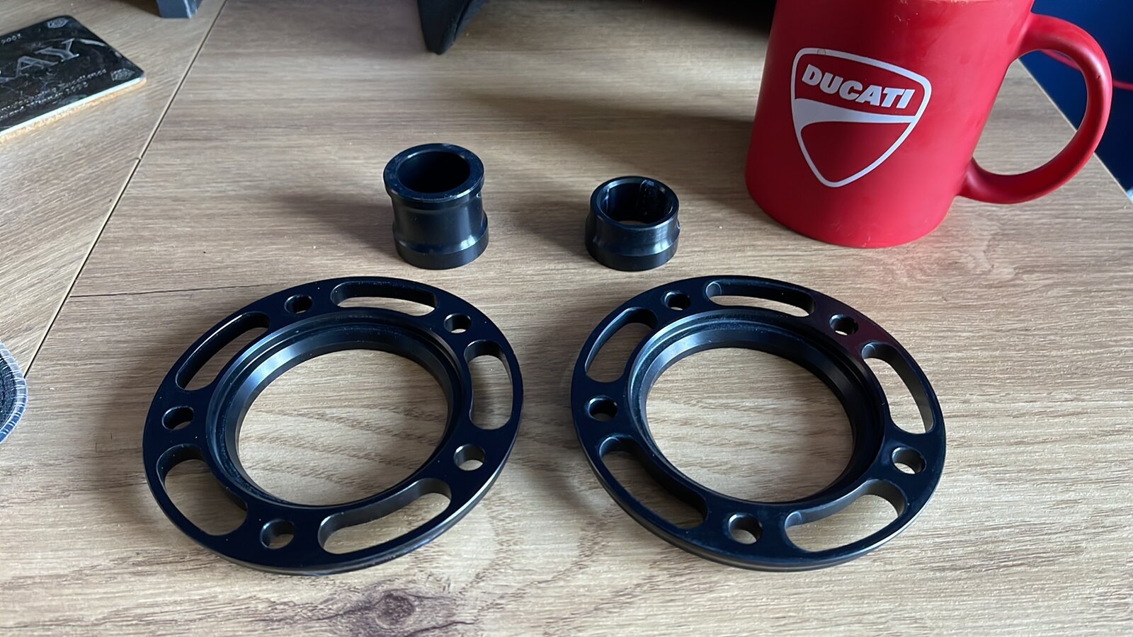

  10. So…. I paid the handsome sum of £300 to brembo / Marchesini for the factory spacer kit after struggling to find any in the UK.
    They are amazing!
    Now I’m speaking to a machinist about making a few sets up that won’t cost £300 if anyone is interested. I have no price yet on how much it’s going to cost and I suppose will come down to how many I order.
    if anyone is interested, no obligation just pop a comment on and it’ll give me a ballpark figure of how many sets to have made up.

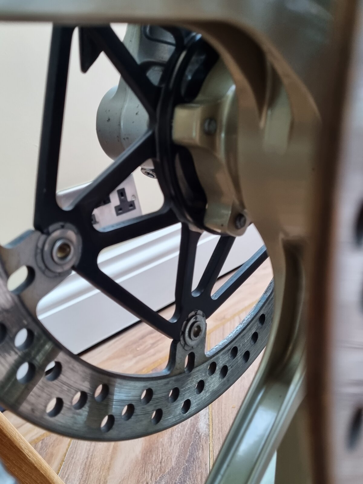

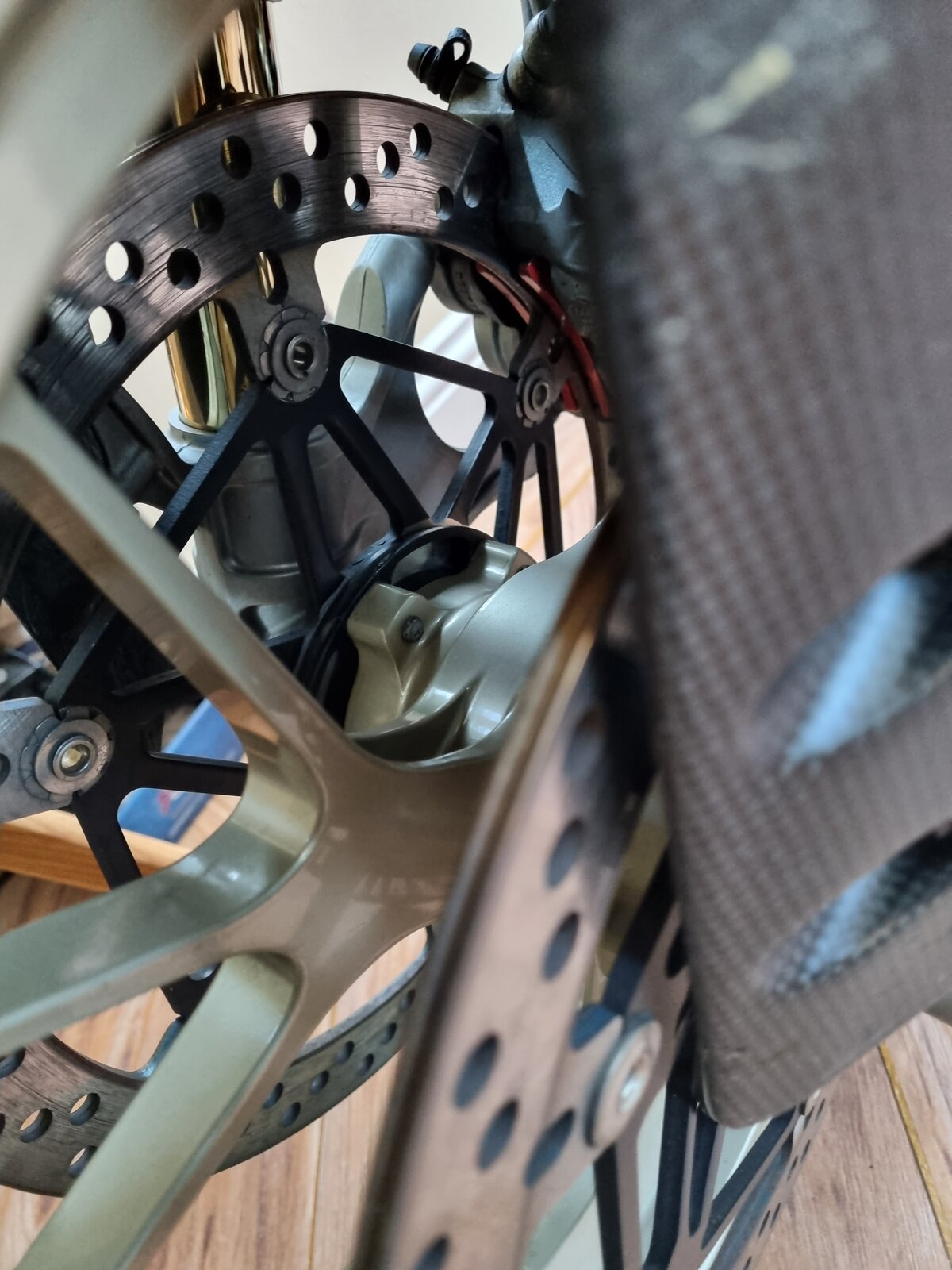

  13. They look canny when fitted - can't really notice them

  15. Just a comment from my side as i have been using a set of these on my 1198 wheels.
    due to the length of the right side wheel spacer it sometime drops out when refitting after tire changing. I ordered a set of Spider spacers that have a chamfered outer edge to see what a difference it makes.
    maybe a consideration if you getting some knocked up?
  16. Cheers Nathan, yeah I run the Spider ones on my pani and was going to look at captive spacers for the kit. Nothing worse than balancing a wheel with one hand and fishing around on the floor for the spacer with the other :joy: Definitely worth an ask.
