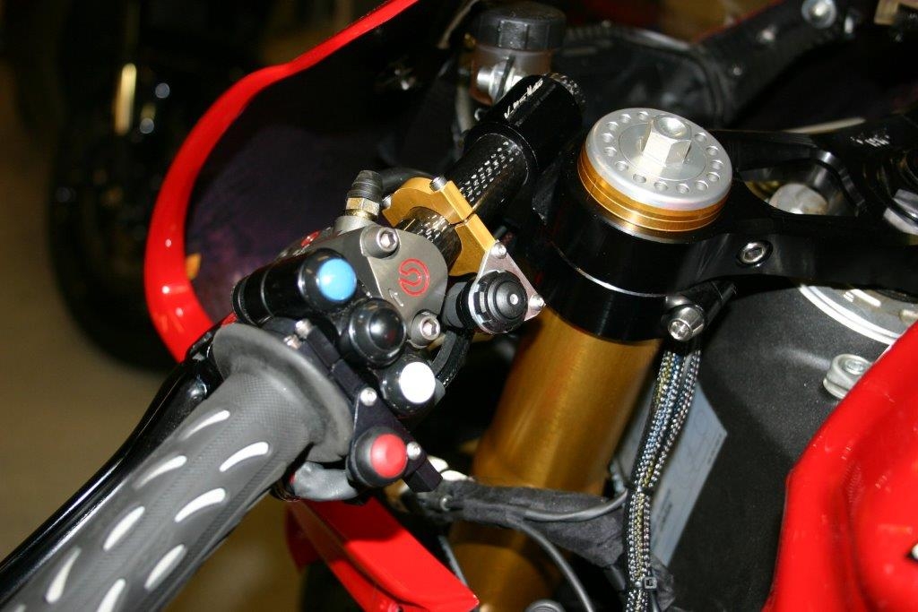

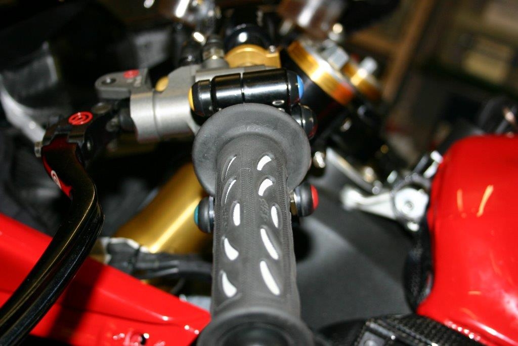

    And now there is something my bike has and that the F013 did not have. Something Chaz Davies grumbled on for not having:
    A fully automatic clutchless downshifter with electronic revving and ramping. J … just to help this old fart focussing on his moving around on the bike..
  13. Auto up and downshift?? You've built the fatest scooter in Europe ;-)
  14. something to selebrate ! :)
  15. I'm soooo jealous of that shifter. I craves it. I wants it. Ive looked around and nothing comes close. Dammit. I could stretch to 50% of its cost. If they made a version.
