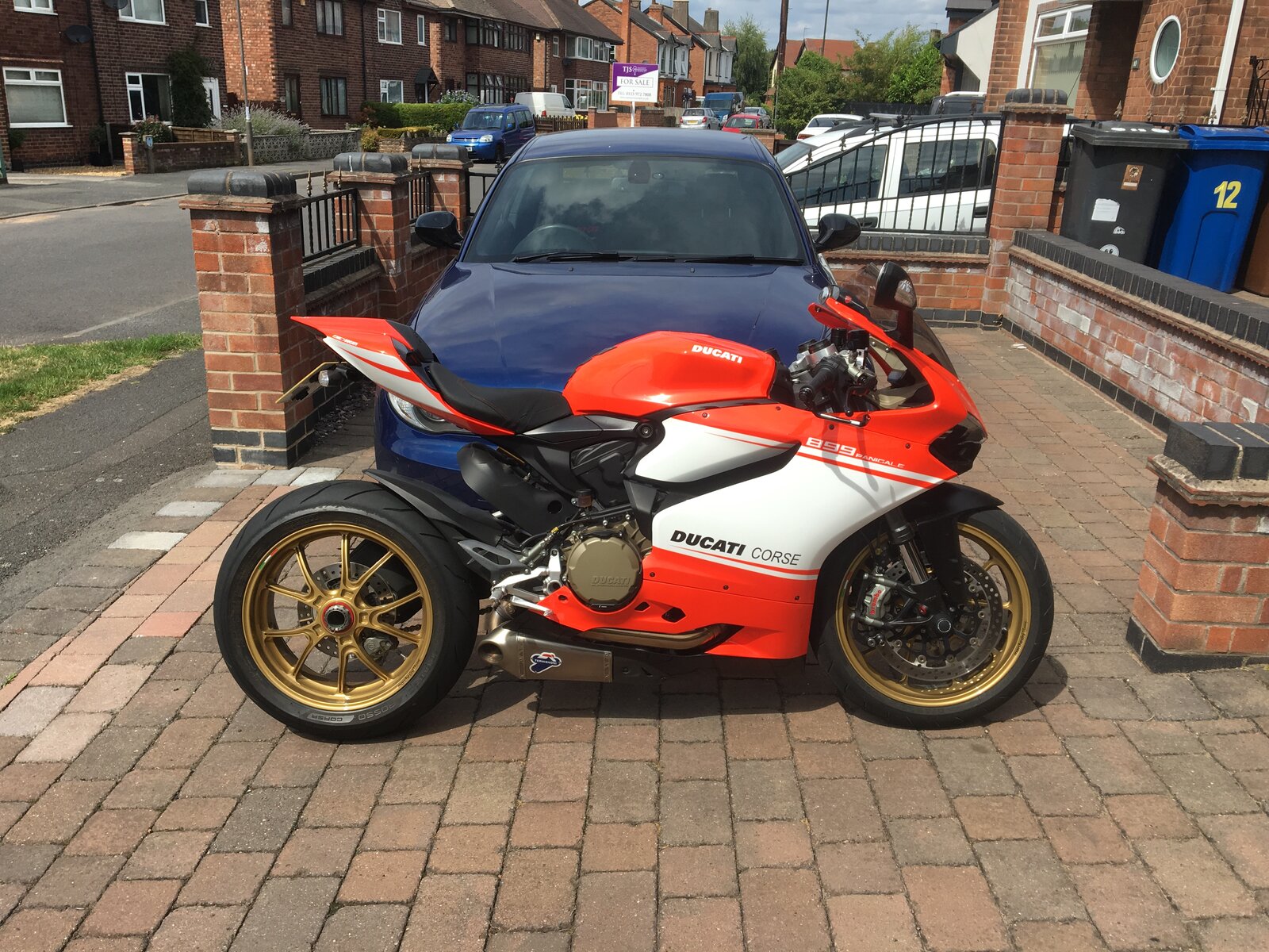

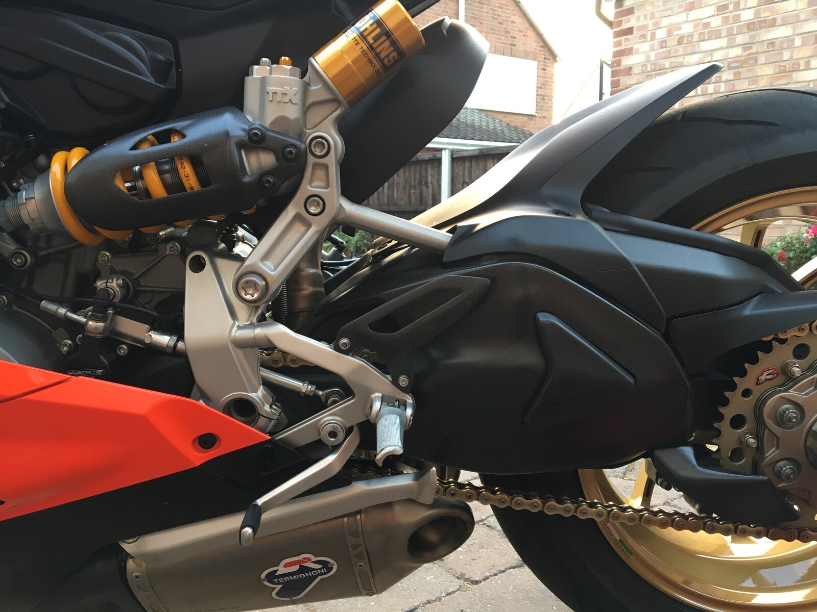

  7. This was my 899
    A few magnesium parts sets the bike off..Clutch case and headlight stay
    M50 calipers
    SSSA conversion
    Lightweight wheels
    Few bits of carbon
    A lick of paint
    Ohlins TTx rear shock
    Renthal chain, sprockets and carrier
    Termi’s and map
    #8 Andy800, Aug 30, 2020
