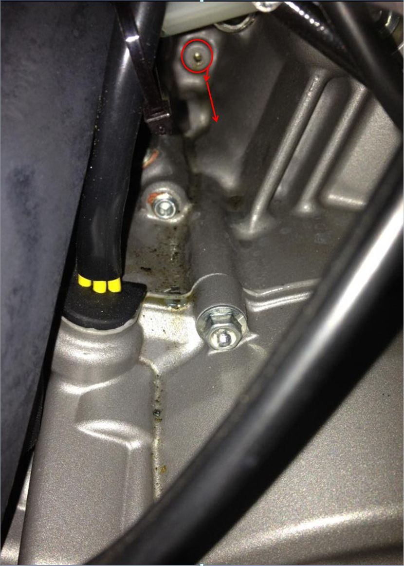

  1. Has anyone else had this? or even checked?
    Its on the left side beween both cylinders, quite hard to see with fairing on, but the oil trail is a tell tale.

  4. If the oil level is high, above the low mark on the indicator glass, and you ride constantly hard (probably need to be on track) the oil can be blown up into the air box. Could what you are experiencing be coming from the air box?
  5. no mate, its here, never enough to drip tho. Ducati.ms discuss it quite a few times.
  6. maybe, but ducati.ms discuss it a bit, and possibly no ones looked! mines very slight, but still there
  7. I had a leak showing in exactly the same place as shown in the pics (casing not circled part), it was coolant from the O Ring in the "spitter" where it bolts to the engine. The O Ring (it's actually a square "O" Ring) was not seated properly at the factory.
