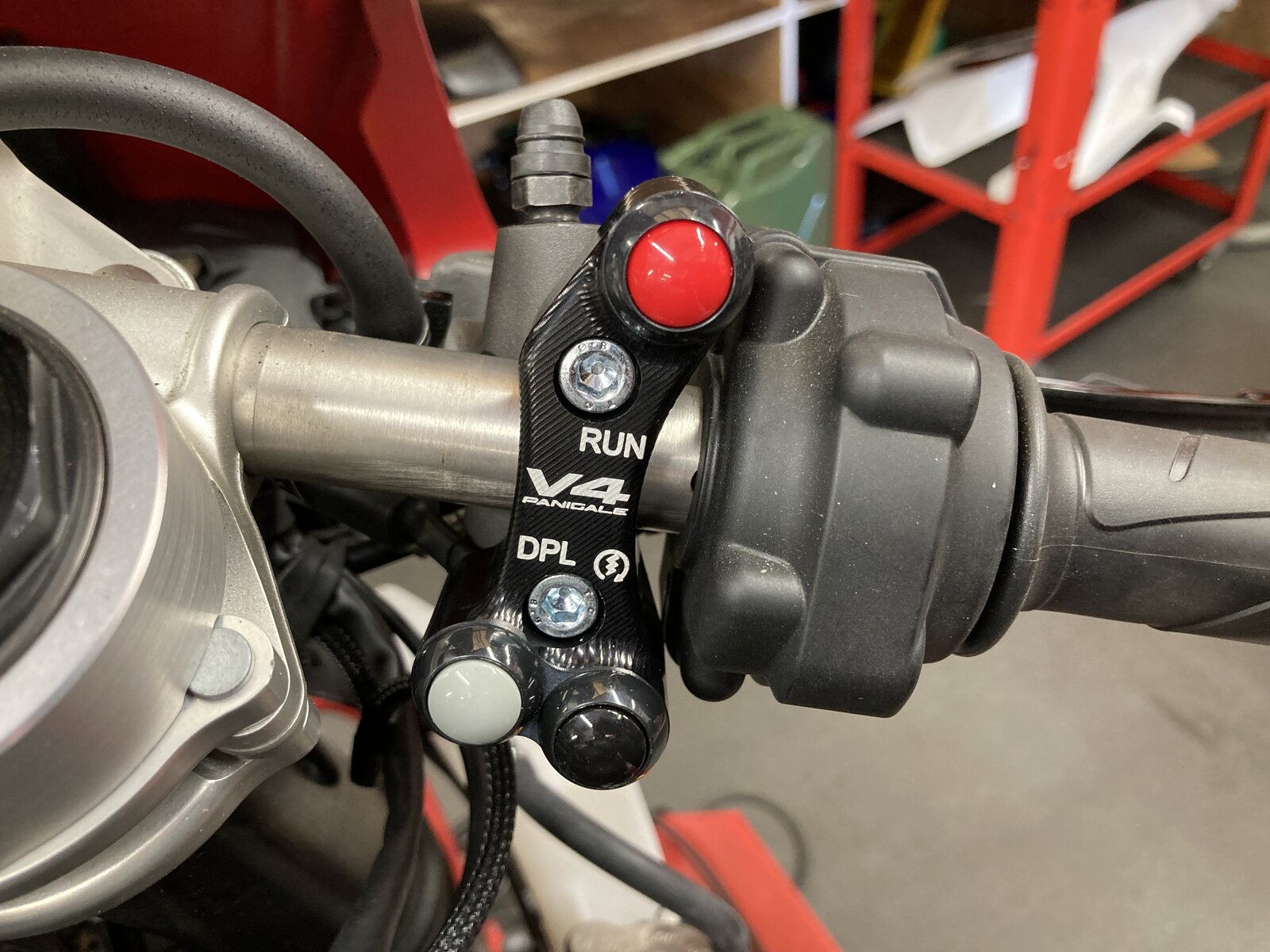

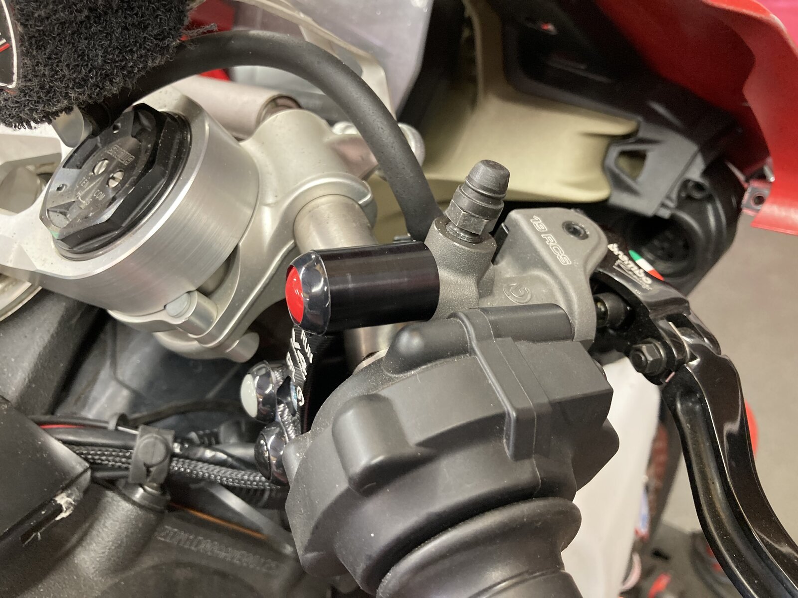

RCS is fairly straightforward. It has a brake switch fitted. Banjo is a straight swap as you already have the correct M10 x 1 type fitted to the stock master. Reservoir mount is easy enough with the Brembo kit available or mod your original. The only twist is that the switch gear is too wide to get optimal position for the lever position. I used a new switchgear that replaces the clamp for the master cylinder. I used Jetprime, although others are available. I’ve added a couple of pictures of the assembly on a V4 we’ve just done

You can get throttle housing with the switchgear built in from jet Prime and Ducabike etc. So you dont need a seperate switch. Im using a BikeSportDevelopment (BSD) switch myself (good quality). I have a corsacorta RCS17. The reservoir bracket may need a tweak but theres lots of products out there for those.
