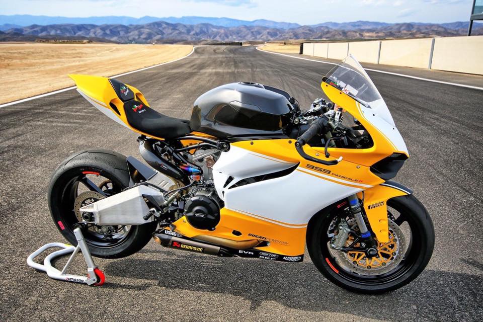

    So if anyone has any riding tips (for track) then much appreciated. Also, has anybody made any hardware changes? The tank on the race bike is very different and there is the Jorge solution[​IMG]
  2. I use a rear tank extender like the race bikes have and would definitely recommend it in general although maybe not if you are looking to make the ride easier? It makes the seating position longer like the older race bikes. Its probably harder work if you were using it on the road since you are seated further back but on track they stop the off throttle low sides that lots of people were having when the Panigale first came out.
    In terms of riding style it doesn't give you any more tank width to grip so might not solve your problem. For the Pani I have to consciously grip the tank with my knees when in the braking zone and then shift off to the side. I already have my ass off the side to some extent and then slide around the tank a little more as I drop into the corner. I think the extension probably does help here but it is still different to other bikes. The V4 looks to be a bit more supportive in this area.
