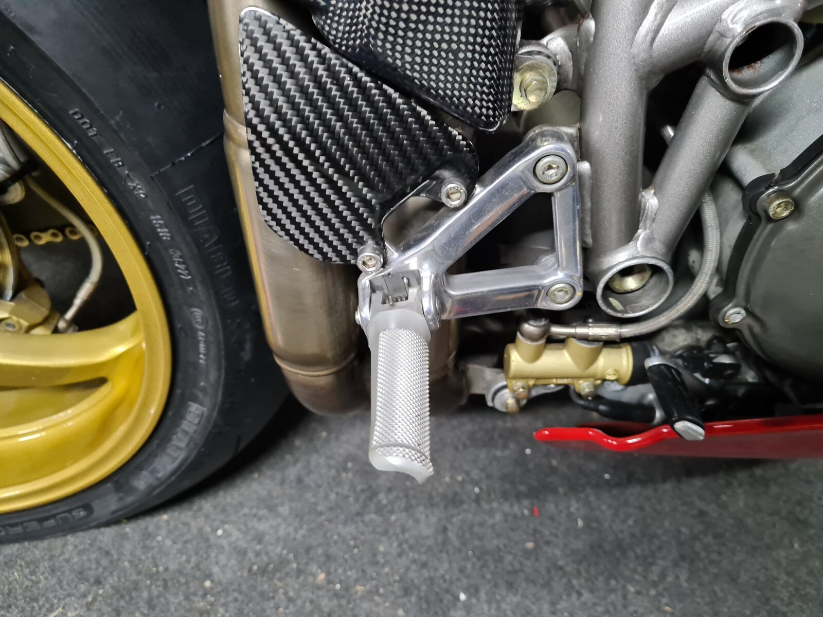

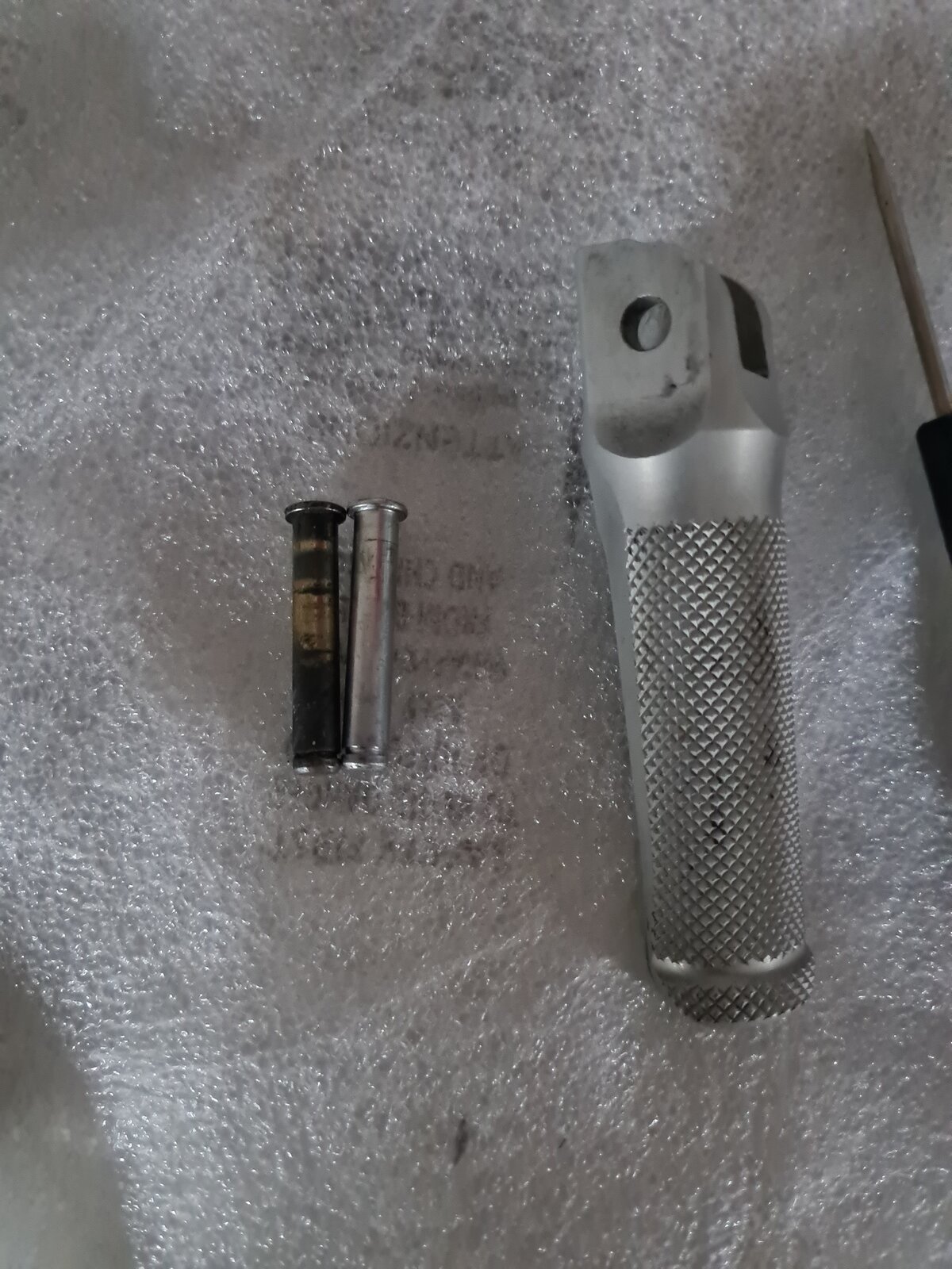

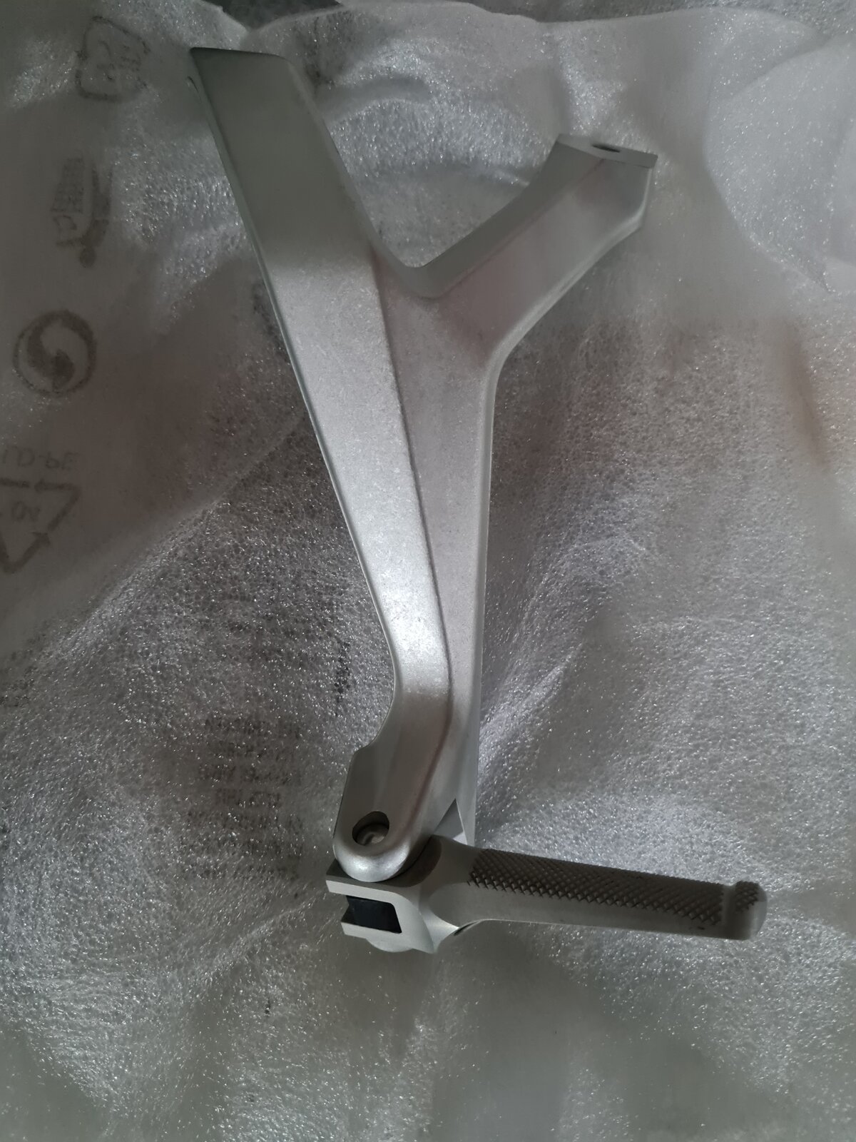

  3. After loads of cross references we have a new set of pegs for the 748.
    on the basis 748 and 1098 pegs are the same I thought I can use 1098R pegs.
    1098R pegs are the same part number as panigale v4 pegs.
    panigale riders pegs are the same part number as panigale v4 pillion pegs!
    so I bought a set of pillion pegs thar had been removed from a new bike. £20 from our favourite auction site.
    they bolt straight on with no modifications :)
    angle is correct and I used the new pins and E clips as they are same size too
  4. Ha... nice job. I bet they're a Bazillion times more grippy than the POS originals... I run a set of DP fixed ones on my 996 and it's like night and day better. But this is a MUCH cheaper option !
  5. yeah and I get to sell the pillion brackets on to recover the costs hopefully
    your right about the stock ones. they feel like they are Teflon coated!
