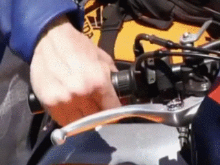

  6. I would change the rear shock as it makes a massive difference and fit a throttle spacer, makes it easier to keep the throttle consistent through the bends. Stompgrips as well maybe

  11. Yes I saw someone's vid on the throttle spacer and it looks like a good idea. Taking her on track for first time this weekend so am sure after that it will highlight the needs more!

    Also other immediate mod will be the throttle spacer, I found the bike quite jerky when trying to maintain corner speed.
